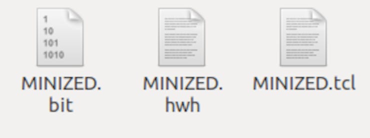

Let's load an overlay. For this I will use files generated by Vivado.
cd /Avnet/hdl/Projects/minized_petalinux/MINIZED_2019_1/
And look for "hw_handoff" folder
Also, we will need bitstream. Just search in Vivado project folder.
Rename these files, so PYNQ knows they are referencing to the same overlay.
Upload these files to Jupyter Notebook
Modify script to load new overlay.
