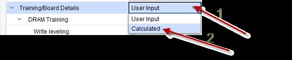

Here’s a look at how we did this in Vivado 2016.4. First, we created a Vivado project targeting the Zynq 7007S in the CLG225 package. We created a new block design with Zynq PS7 IP, and then we customized the Zynq PS7. In the customization menu, you can change the Training/Board Details from User Input to Calculated:

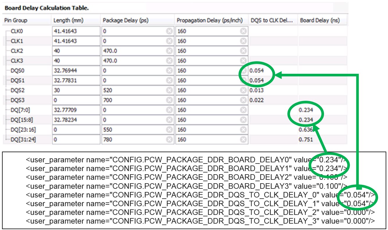

We recognized the package delay inaccuracy. Instead of correcting the package delays in this calculation table, we created our own spreadsheet which compensated for the routing lengths and package delays. This allowed us to calculate an equivalent millimeter length for the entire path. See below what actually got entered during the original MiniZed board definition calculations for the DDR tuning parameters. Note that the entries for CLK2, CLK3, DQS2, DQS3, DQ[23:16], and DQ[31:24] are all irrelevant since they don’t exist on this board. We added in some whole numbers to make sure we didn’t encounter negative values in the calculations for DQS to CLK and DQ Board Delay for the non-existent Byte Groups 2 and 3. You will see that the values for Byte Groups 0 and 1 match the board definition:

We recently reviewed these parameters in 2017.4. Notice that the default calculation table does have the correct package values for the 7007S CLG225.
Fullscreen 6457.contentimage_95042.html Download
<html><head><title>Jive SBS</title></head>
<body><font face="arial,helvetica,sans-serif">
<b>Error</b><br><font size="-1">
An general error occurred while processing your request.
</font></font></body></html>
This allows us to use the PCB trace length values without calculating the total path delay manually. (Again, ignore all values relative to Byte Groups 2 and 3).

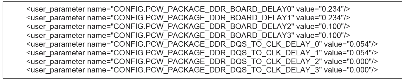

This leads to the following inputs in the 2017.4 version of the board definition file (negative values replaced with 0):
<user_parameter name="CONFIG.PCW_PACKAGE_DDR_BOARD_DELAY0" value="0.232"/>
        <user_parameter name="CONFIG.PCW_PACKAGE_DDR_BOARD_DELAY1" value="0.231"/>
        <user_parameter name="CONFIG.PCW_PACKAGE_DDR_BOARD_DELAY2" value="0.318"/>
        <user_parameter name="CONFIG.PCW_PACKAGE_DDR_BOARD_DELAY3" value="0.433"/>
        <user_parameter name="CONFIG.PCW_PACKAGE_DDR_DQS_TO_CLK_DELAY_0" value="0.045"/>
        <user_parameter name="CONFIG.PCW_PACKAGE_DDR_DQS_TO_CLK_DELAY_1" value="0.046"/>
        <user_parameter name="CONFIG.PCW_PACKAGE_DDR_DQS_TO_CLK_DELAY_2" value="0.000"/>
        <user_parameter name="CONFIG.PCW_PACKAGE_DDR_DQS_TO_CLK_DELAY_3" value="0.000"/>
