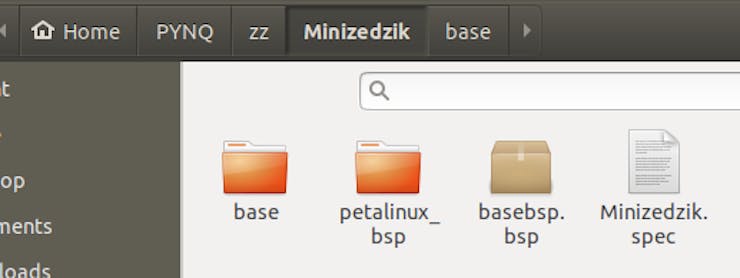

Copy created BSP to PYNQ → sdbuild with previously downloaded "bionic.arm.2.5.img"
And create PYNQ image
cd PYNQ/sdbuild;
bash scripts/image_from_prebuilt.sh MinizedEMMCPynq MinizedEMMCPynq.bsp arm bionic.arm.2.5.img;

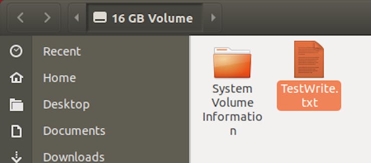

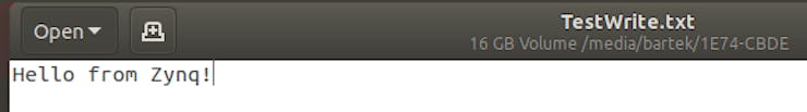

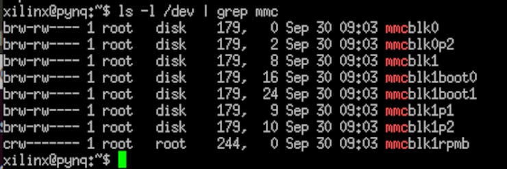

Now let's mount pmod sdcard and write something to test functionality.
mkdir mnt;
ls -l /dev | grep mmc;
sudo mount /dev/mmcblk0p2 mnt;
Open mnt folder and create.txt file.
cd mnt;
sudo nano TestWrite.txt;
Exit and save, umount sdcard.
cd ..;
sudo umount mnt;

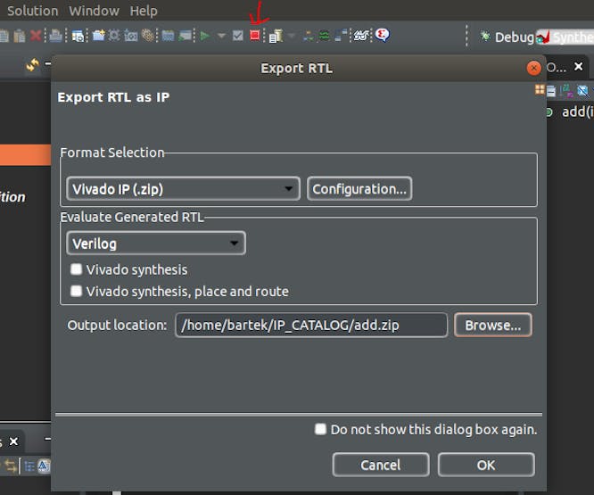

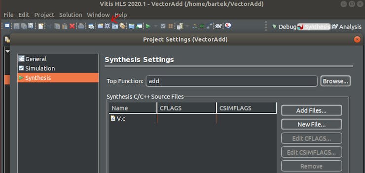

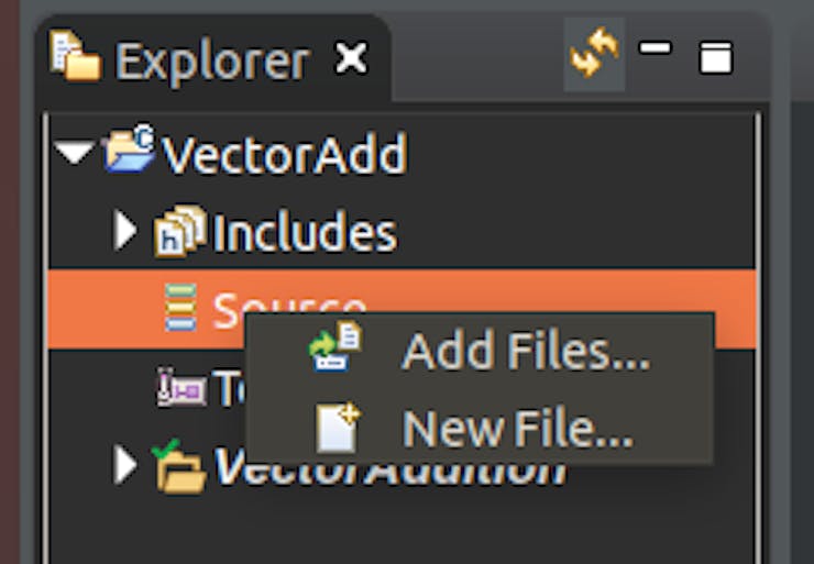

Open Vitis HLS and create new empty project for xc7z007 chip.
Click sources → new file

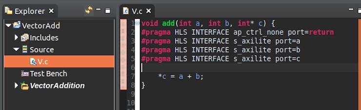

Create addition IP-core
Go to project settings → Synthesis and in "Top Function" type "add"
Click ok and run synthesis.

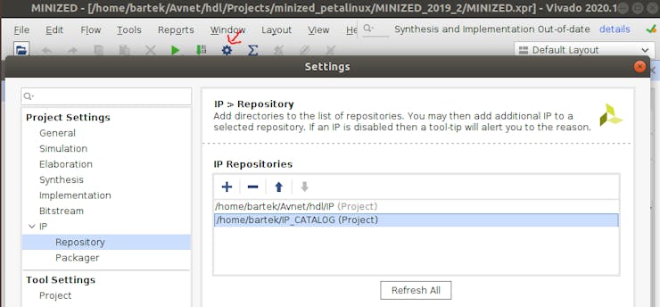

Export our IP to local IP-repository.
Extract "add.zip"

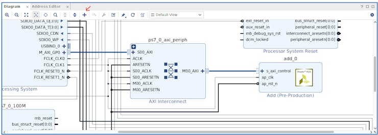

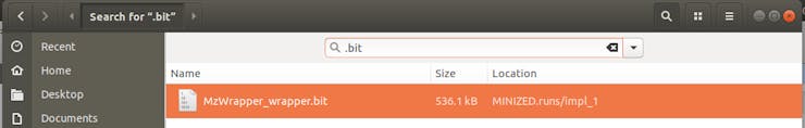

Open Vivado and add new IP to the project and connect it to AXI interconnect.

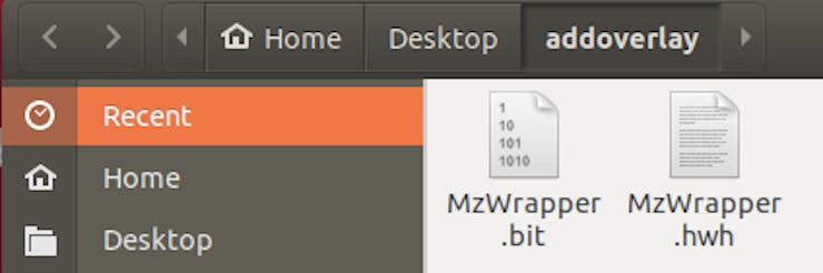

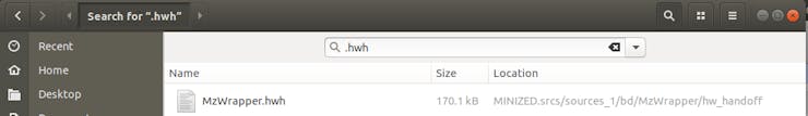

Save project and export bitstream.
Open Vivado project and search for bistream and .hwh file.
Copy and rename these files.

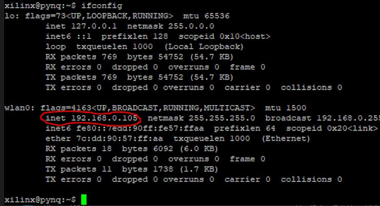

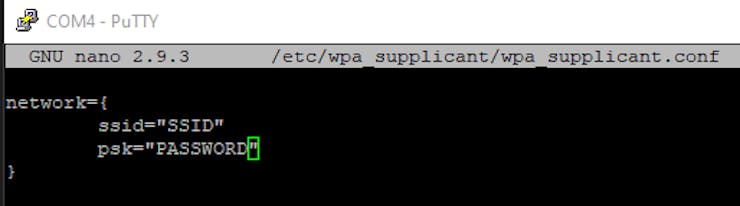

Upload them to Minized, but first we will need Wi-Fi.
Start Minized and connect to it for example with putty.
As you can see Minized detected our wireless adapter
sudo nano /etc/wpa_supplicant/wpa_supplicant.conf
sudo wpa_supplicant -c /etc/wpa_supplicant/wpa_supplicant.conf -i wlan0 -B
sudo dhclient wlan0

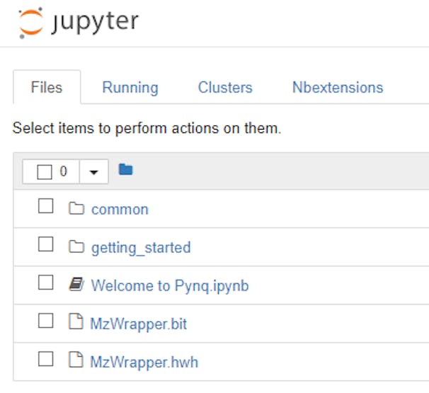

Open internet browser and connect to Minized (password is xilinx)
 http://192.168.0.105:9090/tree?

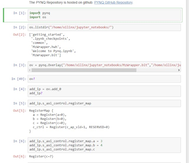

Upload files via jupyter notebook.
"It just works!"
"It just works!"
