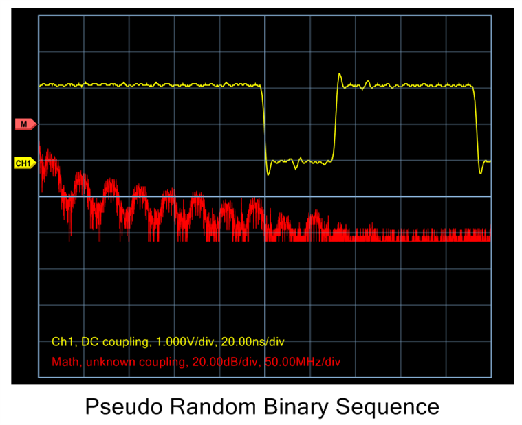

It generates reasonable quality noise. An oscilloscope trace here shows the output and frequency spectrum described later. This is highly useful for test purposes and some example uses are shown. When you don’t need noise the CPLD can be reprogrammed. So, the circuit is useful as a development board for programmable logic learning too.

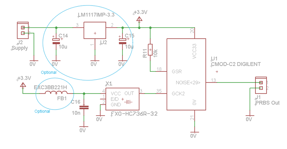

The Circuit
The circuit shown here can be simplified further if desired. It is possible to remove the regulator U2 and the surrounding capacitors, and it may be possible to power the circuit from two AA batteries (this is slightly outside the threshold for the oscillator but it worked for me). The FB1 inductor is desirable but optional, if you don’t have it just replace with a wire.

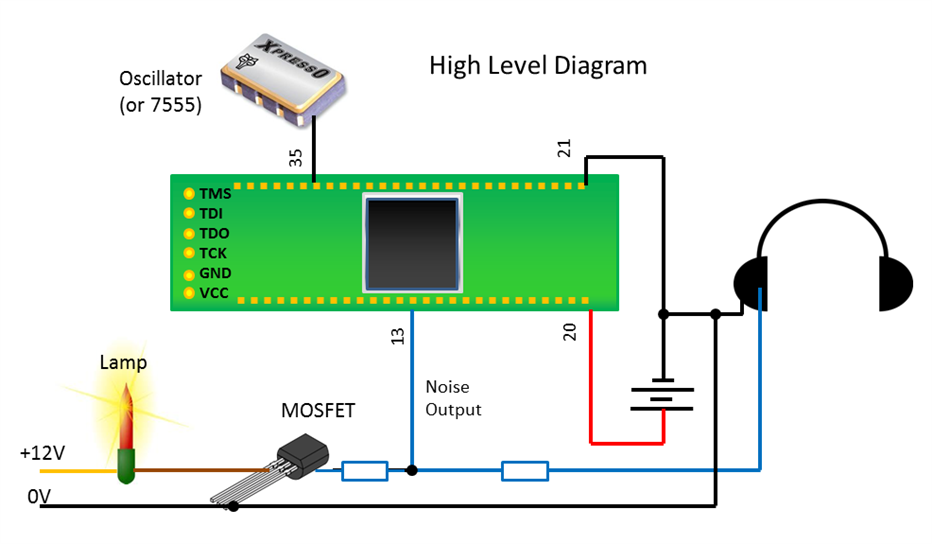

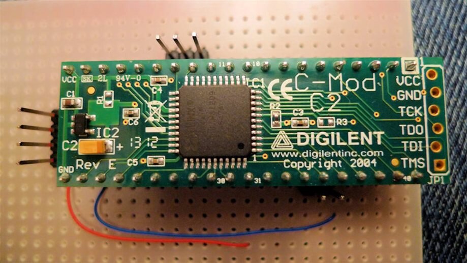

After construction, the board is programmed with a BBB as shown here.  If you want to connect headphones to the output as a test, insert a resistor of about 1k in series.
Here are photos of the constructed circuit. The holes on the right are where the BBB temporarily connects for programming.

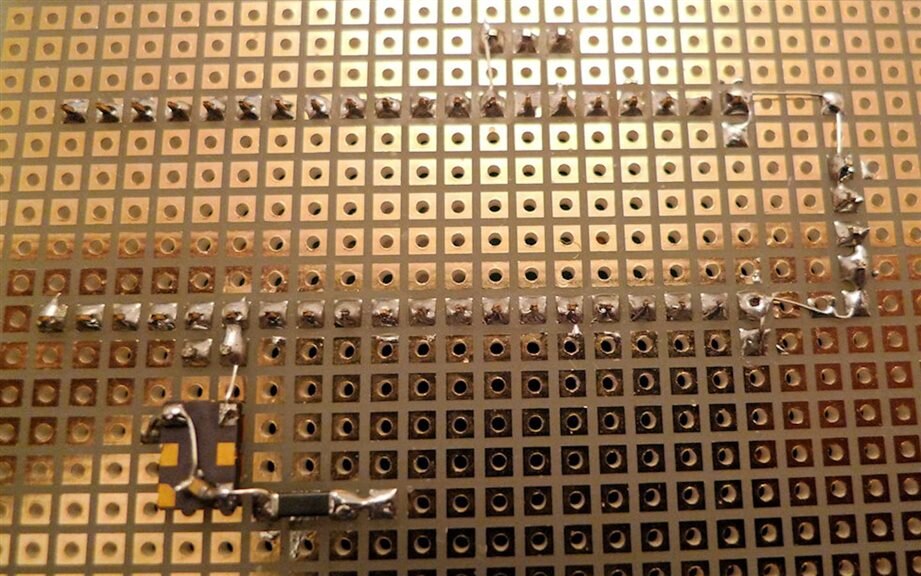

Here is the underside showing the oscillator. Square-pad board is preferable to stripboard for this project and sometimes for many other surface mount projects too. The oscillator is surface mount (unfortunately it’s not easy to find a through-hole 3.3V oscillator) but the pads on it are about as large as the prototyping board, so it is easy to solder as shown in the photo below.
Once it has been assembled and programmed (it should take just 3 or 4 seconds with the BBB) you should see a pseudo-random sequence egressing from the Digilent CPLD board. You can see it on an oscilloscope, or clearly hear it with headphone in series with a 1k resistor as mentioned. The oscilloscope view earlier shows the signal and the frequency spectrum (stretching out to infinity).

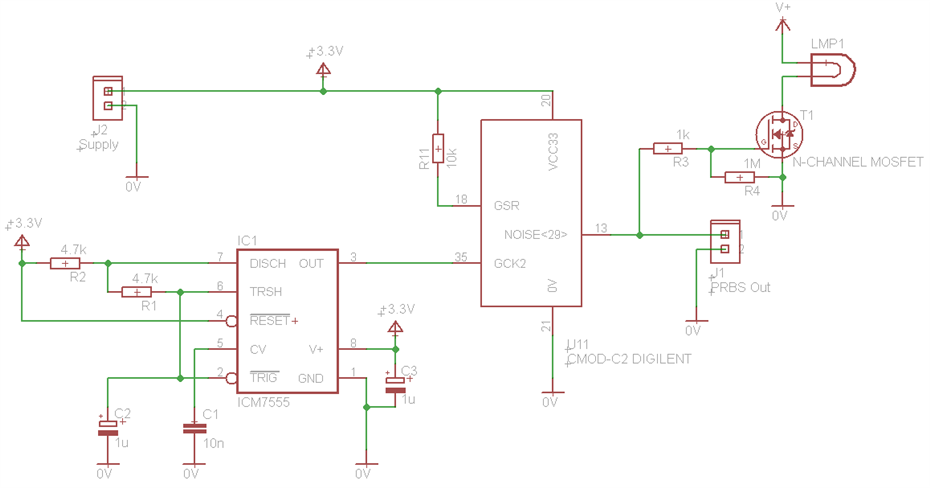

The oscillator has been replaced with a 7555 timer (not 555, since it needs to operate at a lower voltage) for a slow clock of about 100Hz. The output is connected to any driver (e.g. an N-channel MOSFET) and then to a lamp in this example. Here a slow clock was used to simulate a flickering candle type effect perhaps for Halloween. CPLDs are cheap but microcontrollers like PICs are cheaper, so a flickering candle effect is more cost-effective with a microcontroller of course. In this video, I just used the BBB to generate the clock since it was handy, instead of wiring up a 7555 (quicker writing some code than wiring up the chip :-)

That’s it. Not sure how long the lamp will last :-) I ran it from 9V instead of 12V to look after it a bit. Perhaps it could be pre-heated with some current in the off state.
