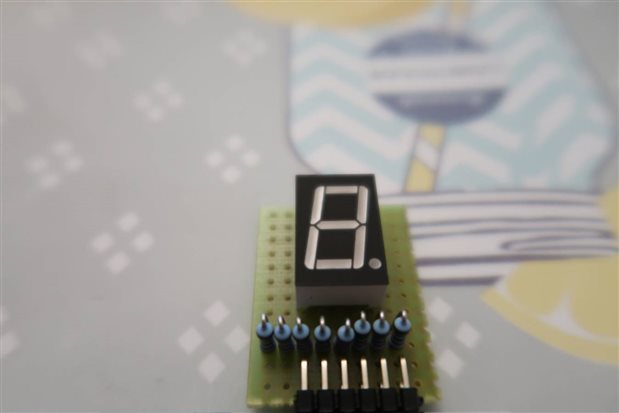

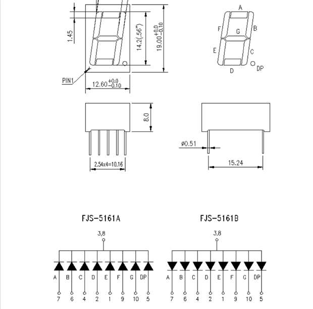

I have a single seven segment display with common anode. This display has following symbol: FJS-5161B. Here is brief information from datasheet for this display:
I have created a kind of PMOD module which contains a single seven segment display, eight resistors with value 150 ohm for limit the LEDs current and pinout socket.
Here is photo of this module:

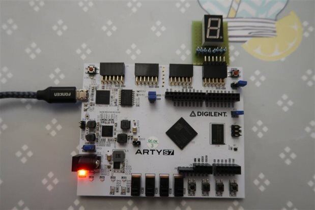

Here is information about connection between Pmod JD connector and seven segment display:
V15 jd[0] -> D
U12 jd[1] -> C
V13 jd[2] -> B
T12 jd[3] -> A
T13 jd[4] -> DP
R11 jd[5] -> G
T11 jd[6] -> F
U11 jd[7] -> E
I have used Pmod JD connector with their eight pin to direct drive of this module by Arty S7 board. I have created simple module in Verilog which allow to drive this display. Here is source code:

We have here simple prescaler of source 100 MHz clock. So, in each second we are able to see a different digit on display.
Here is short video presentation of a working display:
