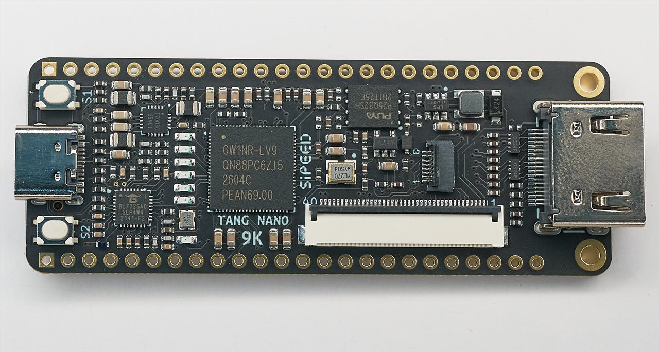

I used a Tang Nano 9k board, which contains the Gowin LittleBee series GW1NR part (the full part code is GW1NR-LV9QN88PC6/I5).

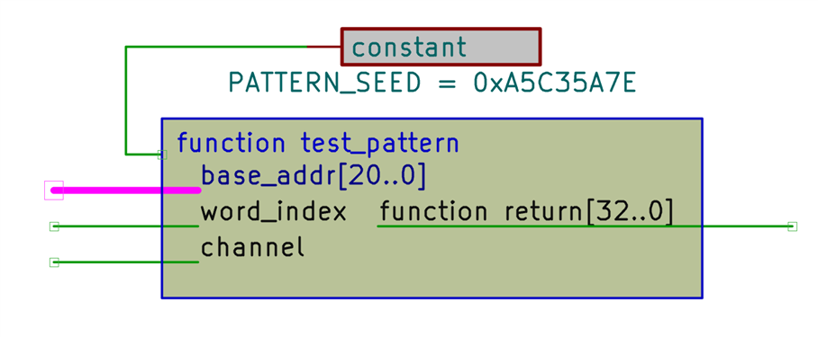

Before we look at the remainder clocked portion of the process, it is worth mentioning functions. They are bits of reusable HDL that can accept various inputs and return one signal or array. For this project, a function called test_pattern is used to provide a 32-bit value based purely on a seed, address (base address which doesn’t change for a burst of 32-bit data), the index into the burst, and the channel number.
When this test_pattern function is used, the base_addr signals will end up being the address supplied to the PSRAM component.
This function is not that important to the task at hand (i.e. writing and reading PSRAM content), the test_pattern function is merely used to supply something interesting to write into the PSRAM, and to check that it matches when reading.
In a real project, perhaps the data would arrive from an ADC or a PC, so this test_pattern function would not be needed (although, it may well be useful to perform a memory self-test on startup, for really critical applications).

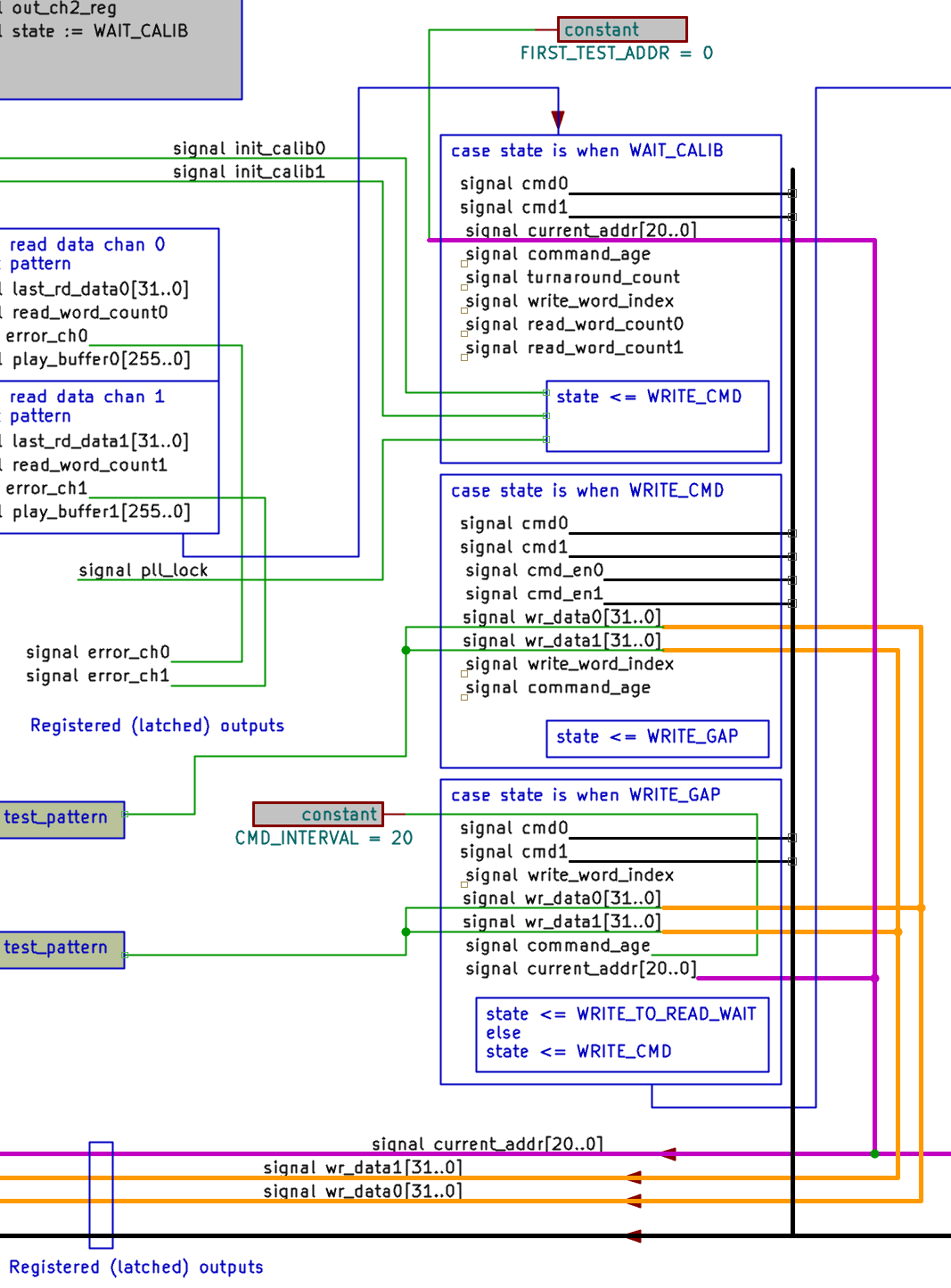

If you recall, it’s necessary to wait on power-up for the PSRAM to be ready for read/write operations, and the PSRAM component reports it is ready by asserting the init_calib0/1 signals (see the first block diagram which showed the PSRAM component). In the diagram that showed the async reset (gray colored box) it could be seen that a signal called state was given an initial value of WAIT_CALIB. The next part of VHDL code within the process block checks the state value. The diagram below looks complicated, but really it can be divided into three, representing three case statements, each one checking the state value.
The top statement checks if the state is WAIT_CALIB, and if it is, then it simply initialises various signals listed in the box, including setting the address lines to zero (the two PSRAM channel address buses are continuously driven from the current_addr register output), and then will only set the state to WRITE_CMD if the PLL is locked and if the init_calib0/1 signals are high, otherwise, it remains in WAIT_CALIB on each clock pulse.
The next state in the diagram above is WRITE_CMD, and when that occurs (well, on the next clock pulse after it was set in the previous case statement), a test pattern is applied to the wr_data0/1 signals, and the cmd0/1 and cmd_en0/1 signals are all set high to initiate the write sequence and write the first word.
The waveform diagram (aka timing diagram) from the Gowin documentation shows the write sequence. The WRITE_CMD state is responsible for just that first relevant clock pulse (numbered pulse 2 in this diagram) and then the state is changed to WRITE_GAP for the next clock pulses which will arrive, which is discussed next.
In the WRITE_GAP state, the code snippet here shows that the write data bus to the PSRAM component is set to a test pattern, and the word index is incremented, so that a unique test pattern is supplied on subsequent pulses. Thus, the state remains set to WRITE_GAP until all the data in the burst (indicated as Data1 to Data7 in the waveform diagram above) has been supplied to the PSRAM component.
However, notice in the code snippet that the WRITE_GAP state isn’t exited immediately after the burst is complete. A signal array called command_age happened to be initialized to zero in state WRITE_CMD, and it is incremented by 1 on each clock pulse in the WAIT_GAP state. Once that reaches a constant value (CMD_INTERVAL-1) then the state is allowed to change, either back to WRITE_CMD for the next write burst, or to WRITE_TO_READ_WAIT if the PSRAM is fully written. The reason for that delay is that the PSRAM cannot accept write bursts immediately one after the next; it needs a short pause.
That completes the PSRAM write operation discussion; when the state finally changes to WRITE_TO_READ_WAIT as shown in the above code snippet and block diagram, data can be read.

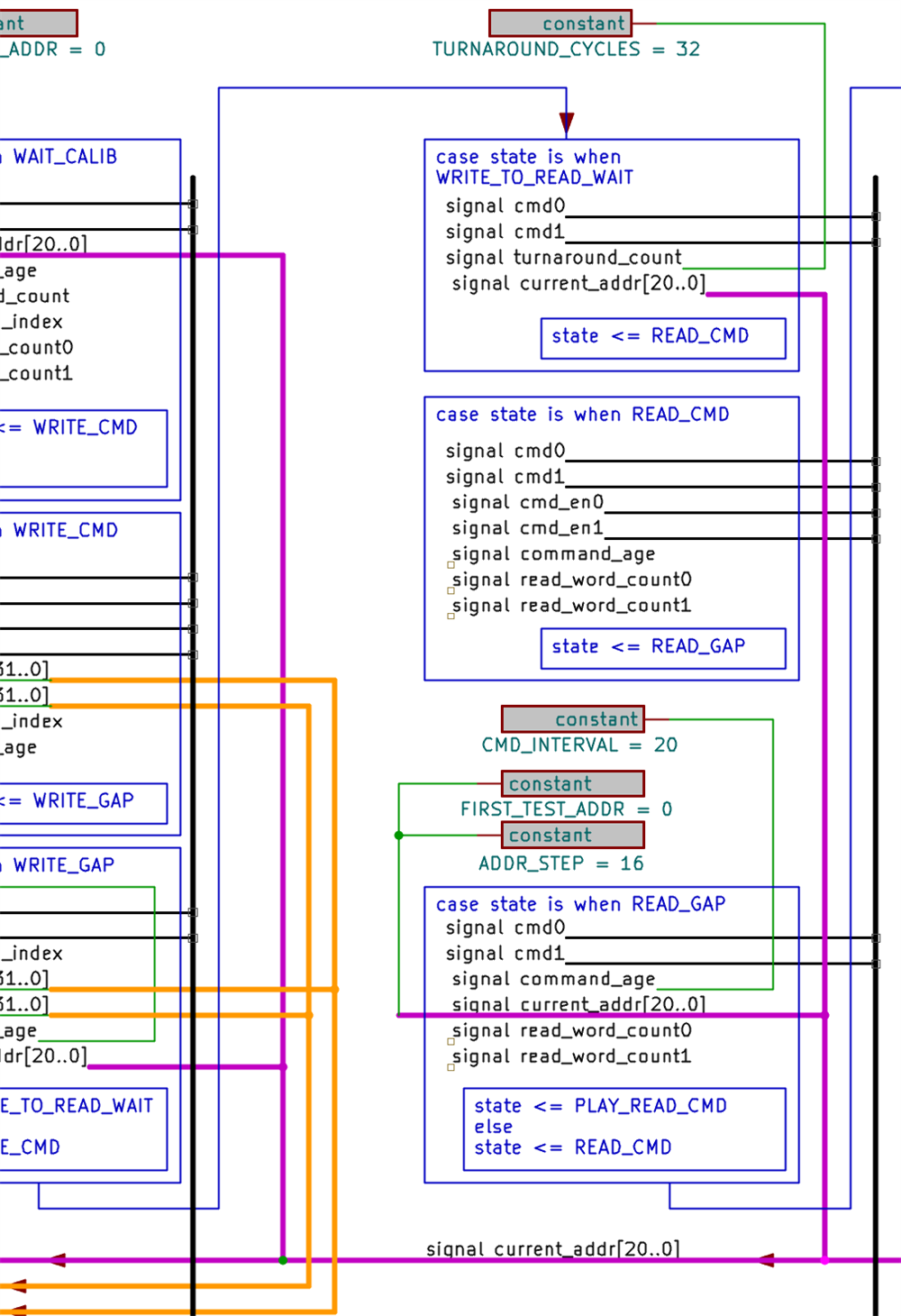

PSRAM Read during the Verification Phase
Again the block diagram looks like a lot, but it can easily be covered piece-by-piece. But first, you may be wondering how come there are no thick light-blue colored lines from the PSRAM component, which represented the 32-bit read data bus. That’s because those signals were covered in the Read Operation Underway section earlier, where each word was compared with the test_pattern function result, and, if in PLAY_CAPTURE state, the burst was filled into a 256-bit register called play_buffer0 (and play_buffer1 for the second channel). The three states in this block diagram are concerned with setting up the read operation.
Firstly, the WRITE_TO_READ_WAIT state is used to introduce a short gap after all those write operations earlier. The VHDL code is similar to the inter-write burst gap code seen earlier (but just with a different counter with the signal name turnaround_count rather than command_age), so it won’t be discussed further. The state moves to READ_CMD after the delay.
In the READ_CMD state, cmd0/1 are set low to indicate a read operation request, and cmd_en0/1 are set high so that on the next falling clock pulse, the read operation is started, and the state moves to READ_GAP.
The PSRAM component will need a few clock cycles to present the output on the data buses for each channel, and will indicate with an rd_valid signal going high. All that has already been covered in the Read Operation Underway section, so all that needs to occur in READ_GAP is to just remain in that state long enough for the entire burst to complete, and remain in the state a bit longer, as the PSRAM component requires. Again, command_age is used as a counter for this, and after the count is complete (i.e. it reaches CMD_INTERVAL-1), the state moves either back to READ_CMD for the next read burst to be initiated, or the state moves to PLAY_READ_CMD if the entire PSRAM memory has been fully read.
By the time the state reaches PLAY_READ_CMD, all the PSRAM contents will have been read once, and compared to the test pattern, and an error LED, one per channel, will be lit if the pattern isn’t what was expected.

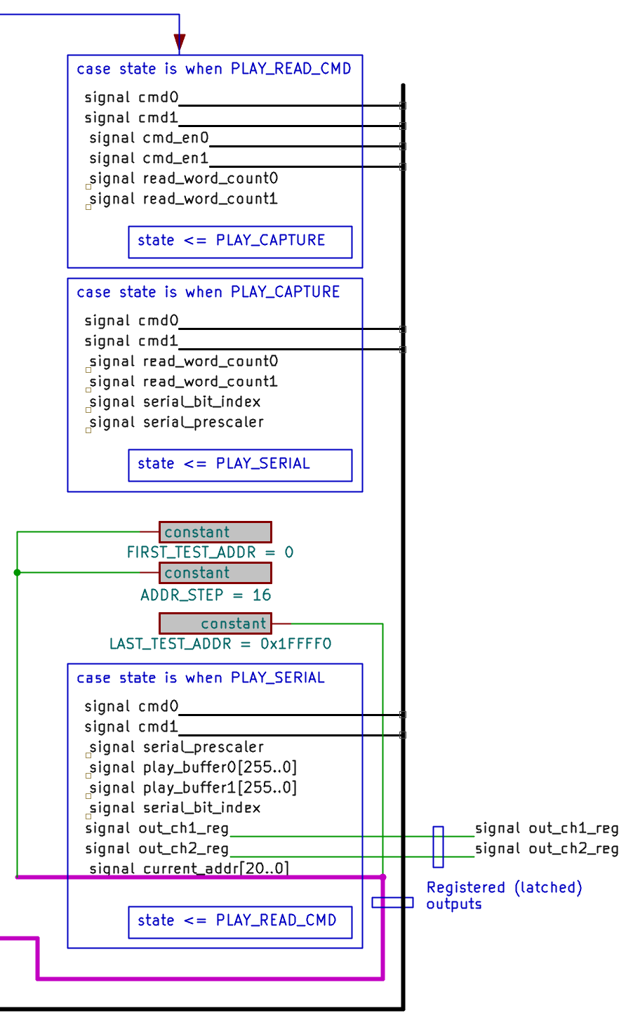

The PLAY_READ_CMD state simply initiates a PSRAM read operation (by setting cmd0/1 low, and setting cmd_en0/1 high), identically to what occurred in the earlier READ_CMD state. The only small difference is there is no command_age to initialize, because the playback is deliberately at a lower frequency (to make it easy to see with a low-cost ‘scope) and so there will be plenty of time between each read burst.
The state moves to PLAY_CAPTURE where, as discussed before, each word within the bursts is filled into the 256-bit play_buffer0 and play_buffer1 registers. The state moves to PLAY_SERIAL once the burst is complete, i.e. the 256 bits are filled.
The PLAY_SERIAL portion is displayed below. What happens is that an internal signal array called serial_prescaler counts up on each clock pulse, until it reaches 31 (i.e. total of 32 clock pulses from zero), since a lower output rate is desired. At that point, one bit from play_buffer0[255..0] is registered out to a signal which is attached to a port in the top entity, so it can be observed on a physical pin on the Tang Nano 9k board. A similar thing is done with the other channel. Once all 256 bits have been output in this fashion, the address bus value is incremented to point to the next desired burst of data, and the state moves back to PLAY_READ_COMMAND which will initiate the next read sequence.

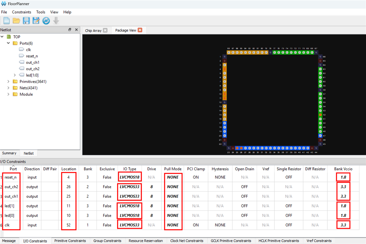

The Gowin FPGA Designer application has tabbed panes on the left side. Select the Process tab to see a list of tasks that can be launched. Double-click on Synthesize, and if all goes well, that icon will change into a green circled check-mark.
At this stage, pins need to be assigned, and clocks need to be identified (so that the FPGA can fit the synthesized design in a sensible way inside the FPGA, to maintain good performance on the specific signals that require it).
Both of these things are expressed in constraint files that can be created using the graphic interface if desired.
In the same Process tab pane, click on FloorPlanner and then in the window that will appear, there will be a graphic area. Above that, click on Package View. You can then drag-and-drop port signals from a pane on the left, onto the desired chip pins. This project has 6 ports to assign. The diagram here shows the six connections that were chosen. The reset_n line was attached to the button S1, and clk goes to the connection to the 27 MHz oscillator.
The screenshot here shows how the FloorPlanner screen should finally look like. Pay special attention to the settings, because the Tang Nano 9k has a mix of 3.3V and 1.8V connections. The 27 MHz oscillator for instance outputs a clock at 3.3V logic levels, whereas the LEDs and buttons are attached to 1.8V.

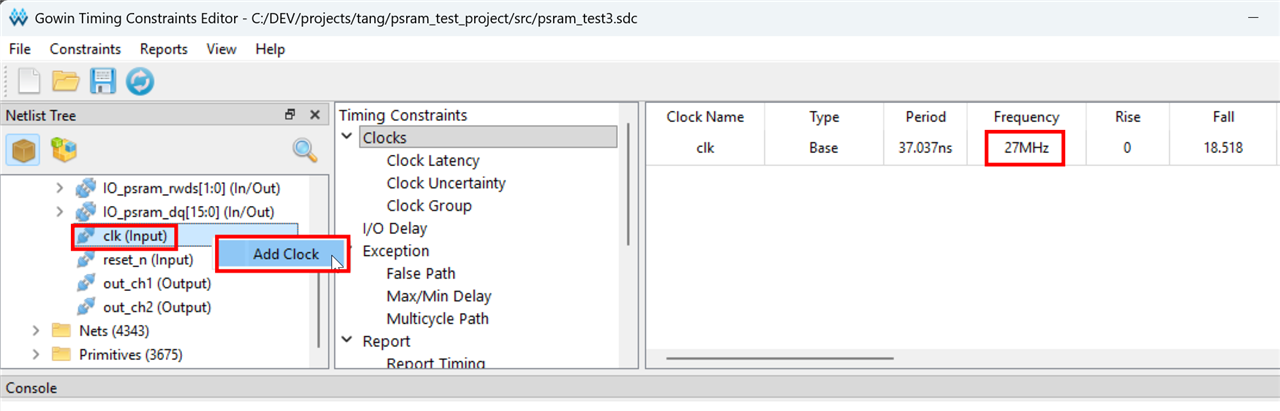

For the clock constraint, double-click on the Timing Constraints Editor in the Process pane, and then find the clk signal in the Ports list, and right-click to add the clock constraint. I typed 27 for the frequency, and then clicked OK.
Note that later on that you'll still get a warning, about a psram_instance related clock called CLKOUT. You can solve it now or later when you see the warning and then do a clean "Place & Route" (mentioned next). The way to solve it, is to create another timing constraint, and this time it is easier to start that by going to Constraints->Create Clock. Give it any name, and then importantly change the Collection to pins as shown in the screenshot below, and then you'll be able to search for that clock name (capitalization is important) as shown here.
After it is added and you click OK, set the frequency to 40.5 MHz for that constraint.

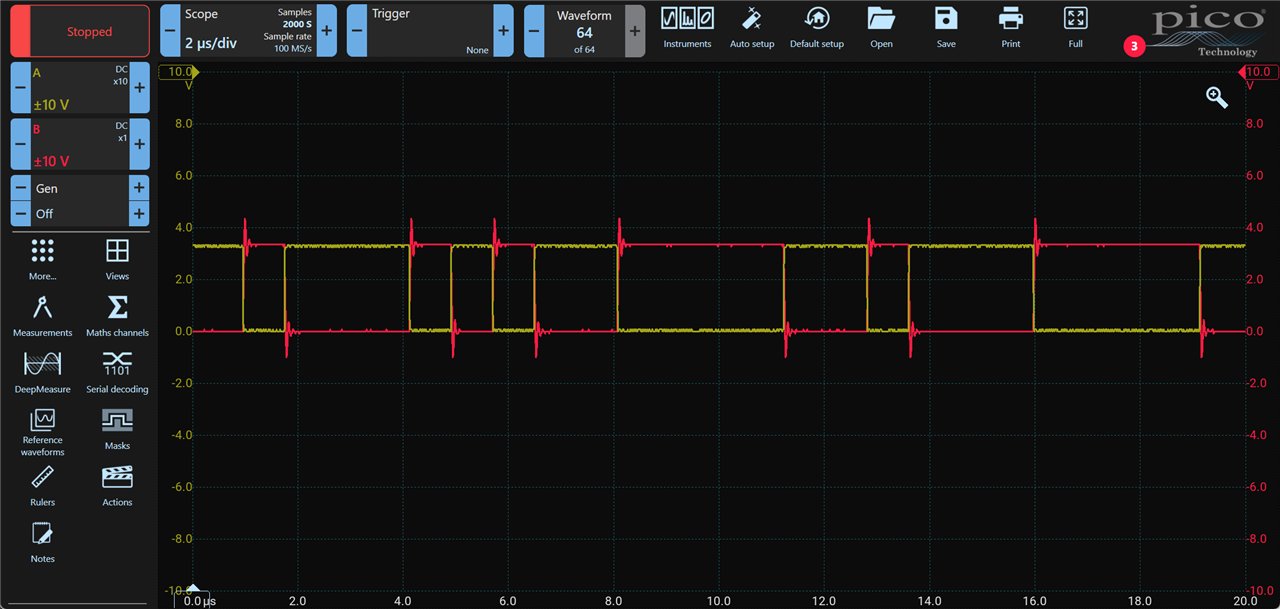

Anyway, once it was programmed, all LEDs were off, which at least meant there was a chance the code was successfully running!
I attached the oscilloscope probes (not very well) and you can see the two outputs are complementary and at the expected data rate. I didn’t try to capture with a logic analyzer and decode it back to the original data.

    create_clock -name pdm_clk -period 166.667 -waveform {0 83.334} [get_ports {pdm_clk}]
    create_clock -name pdm_clk_d -period 166.667 -waveform {0 83.334} [get_nets {pdm_clk_d}]
    create_clock -name psram_clkout -period 24.691 -waveform {0 12.345} [get_pins {psram_instance/clkdiv_s0/CLKOUT}]
    set_clock_groups -asynchronous -group [get_clocks {clk}] -group [get_clocks {pdm_clk}]
    I'm down to one remaining warning:
    WARN (PR1014) : Generic routing resource will be used to clock signal 'pdm_clk_d' by the specified constraint. And then it may lead to the excessive delay or skew

    The timing constraints file contains:
    create_clock -name clk -period 37.037 -waveform {0 18.518} [get_ports {clk}]
    These are the options in the GUI though:
    These are the warnings:
    WARN (TA1132) : 'psram_instance/clkdiv_s0/CLKOUT.default_gen_clk' was determined to be a clock but was not created.
    WARN (TA1117) : Can't calculate clocks' relationship between: "pdm_clk" and "psram_instance/clkdiv_s0/CLKOUT.default_gen_clk"
    WARN (TA1117) : Can't calculate clocks' relationship between: "psram_instance/clkdiv_s0/CLKOUT.default_gen_clk" and "pdm_clk"
    I think this could be a test to see if Gowin support is useful.. I'll send them this problem, see what they suggest.
