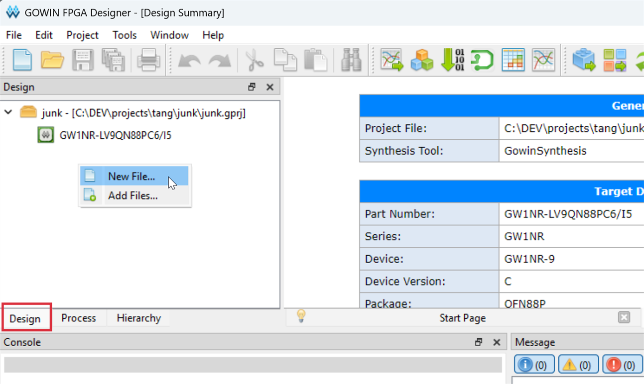

Start a Project

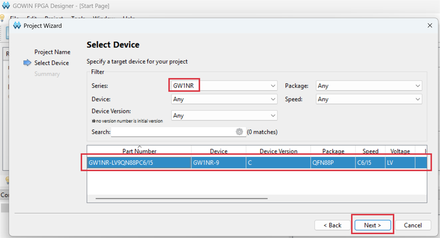

For a first experiment with the Tang Nano, launch the Gowin application, and click File->New->Project. A prompt appears for the device; I decided to target the Tang Nano 9k, and selected the GW1NR series (there's a table in the previous blog post listing which FPGA is in which Tang Nano board). You might need to fill in more parameters until all that’s left is one selection that matches your FPGA, then select it.
The IDE is easy to use. Notice the left pane has Design, Process and Hierarchy tabs underneath it. In the Design tab, it is possible to right-click and add existing or new files. In the Process tab, you can perform actions to ultimately transform those source files all the way through to the final bitstream/bitfile that needs to be transferred to the FPGA.
I right-clicked, and selected New File, selected VHDL, and gave it a name of double_blinky (a .vhd suffix will get appended). Double-click on that file in the Design tab, and the text editor pane will appear on the right.
Here is the HDL code I used (I am not a VHDL engineer, so please don’t assume I’m using best practise!). I’ll go through this line-by-line next, but it's best to keep a separate window open with that entire code in view, so it's easier to mentally navigate through it.

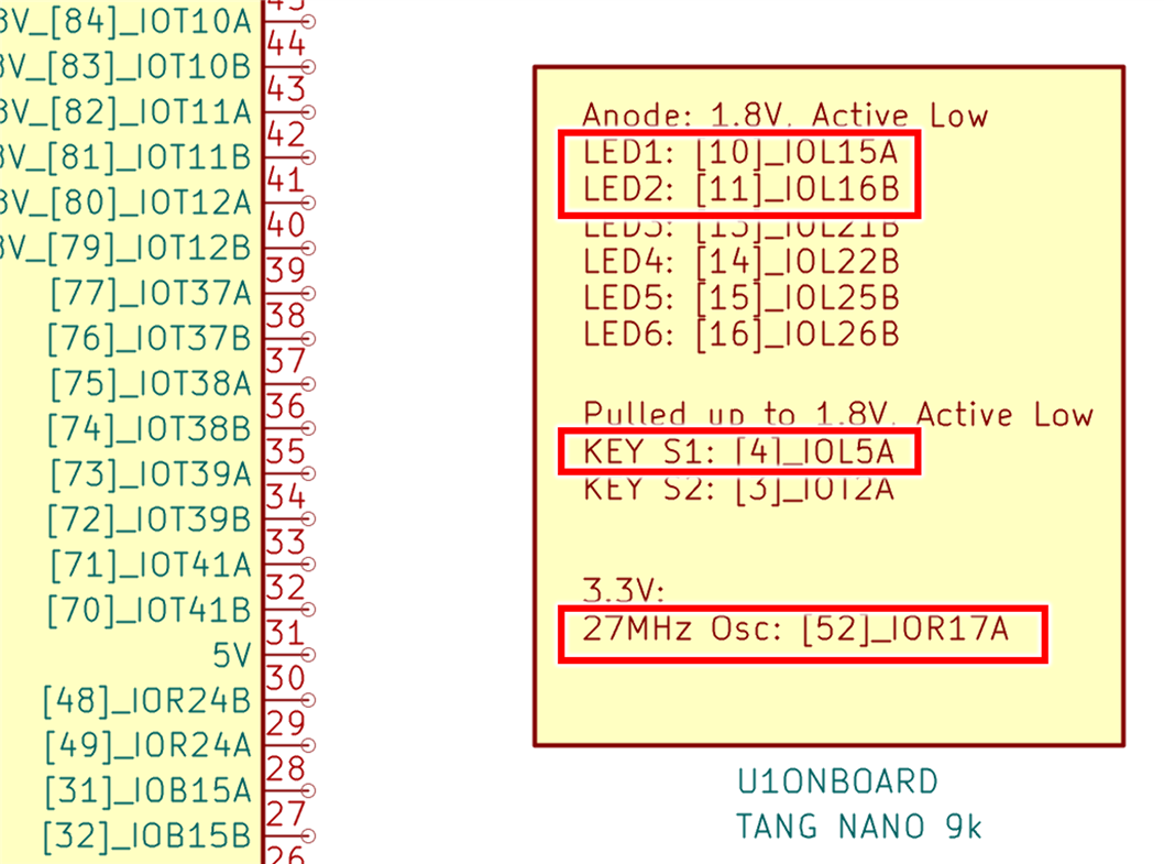

Physical Constraints (Pins)
The VHDL source code for the project has been covered, but as you’ve noticed, the actual physical pin numbers were not discussed. That’s because they are placed in a separate file, known as a physical constraints file, or .cst file in Gowin terminology. I’ll cover this further below so don’t do it yet, but just for information, the file can either be created or added from the same Design tab pane as before, by right-clicking and then if you choose New File then you can select Physical Constraints File. Alternatively, it is possible to wait and create the constraints file graphically using a ‘FloorPlanner’.
To prepare, you'll need to know which pins you wish to use, so the schematic could be consulted (or see the first blog post). Here you can see that the four connections this project will use are for the two LEDs, the 27 MHz clock, and a push-button for reset. The notation below contains the FPGA physical package pin numbers shown as [n]. They are FPGA pin numbers 10, 11 for LED1, LED2, and pin 4 for button S1, and pin 52 for the LED.

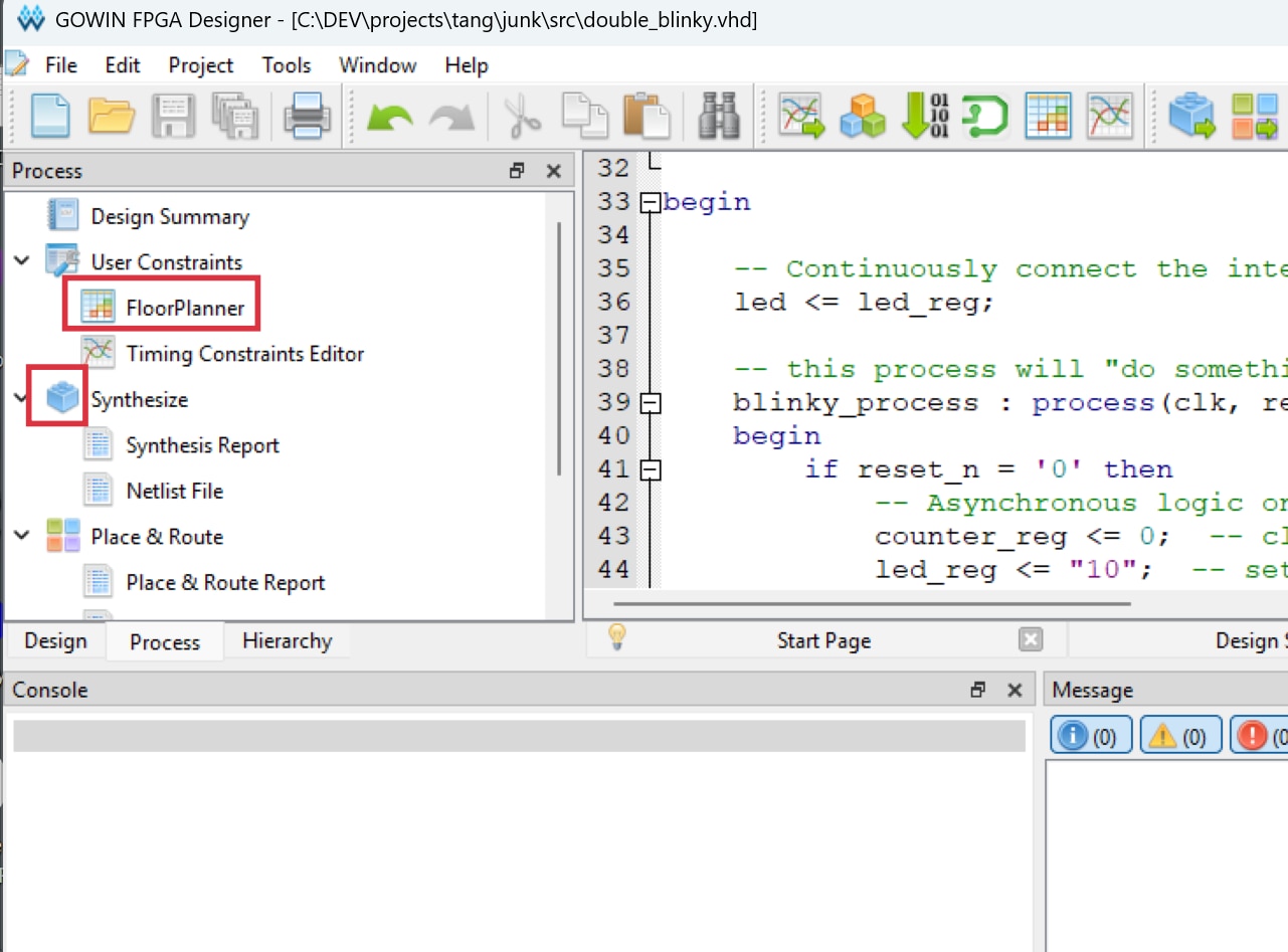

Synthesis
In the Process tab, a list of icons is shown. Double-click on Synthesis (don't click on FloorPlanner yet) and the VHDL compiler will run.
If all went well, the Synthesis icon will change to a green-circled check-mark. Double-click on Synthesis Report if you’re curious.
Now you’re ready to assign pins.
Assigning Pins Constraints using the FloorPlanner
Double-click on FloorPlanner within the User Constraints in the Process pane. If a constraint file does not already exist, one will be created.
The FloorPlanner app window appears, and the right side of it will contain a block diagram showing all the elements that were discussed in the first blog post, such as CFUs, BSRAM and IOBs. This level of detail is not needed for now, so click on the tab above that block diagram, it will be labelled Package View. Zoom in or out if it’s not clear (center mouse wheel, or use View from the top menu drop-down).
Expand the list in the left pane, to see all the Ports (pins) that the project uses, and then you can drag them onto the diagram, to choose which pin you want them to be on.
In the table at the bottom, verify the IO Type matches what is required. In the case of the Tang Nano 9k, from the circuit diagram (see the first blog post), it is clear that the LED anodes are wired to a 1.8V supply, so LVCMOS18 was used. The Pull Mode refers to pullup/pulldown resistors, but they are not needed, so they were set to None (double-click on the text there to see a drop-down appear, and there will be options inside such as PULL UP, PULL DOWN and NONE). Note that the clock is set to LVCMOS33, because, according to the Tang Nano 9k schematic, a 3.3V crystal oscillator is present on the board, wired to pin 52 on the FPGA.
Save and exit from the FloorPlanner once those four port constraints are complete. Now in the Design tab, there will be a constraint file listed. It contains the following text, and it can be manually edited if desired in future:
IO_LOC "led[1]" 11;
IO_PORT "led[1]" IO_TYPE=LVCMOS18 PULL_MODE=NONE DRIVE=8 BANK_VCCIO=1.8;
IO_LOC "led[0]" 10;
IO_PORT "led[0]" IO_TYPE=LVCMOS18 PULL_MODE=NONE DRIVE=8 BANK_VCCIO=1.8;
IO_LOC "reset_n" 4;
IO_PORT "reset_n" IO_TYPE=LVCMOS18 PULL_MODE=NONE BANK_VCCIO=1.8;
IO_LOC "clk" 52;
IO_PORT "clk" IO_TYPE=LVCMOS33 PULL_MODE=NONE BANK_VCCIO=3.3;

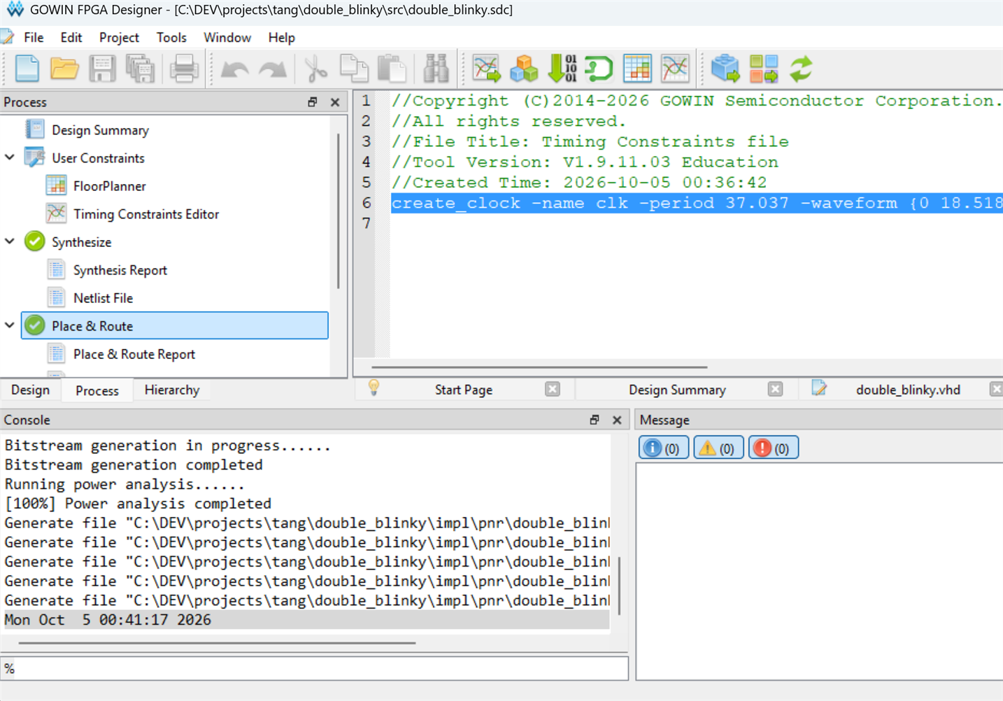

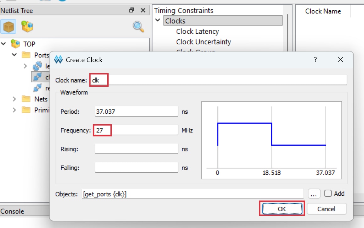

Timing Constraints
The double-blinky project doesn’t run very fast, but the clock signal could in theory have been even higher than 27 MHz, and at some point the FPGA might configure the internal routing in a fashion that causes issues for high-speed signals. It is best to let the software know what sort of performance is needed.
In the Process tab, double-click on Timing Constraints Editor, and let it create a timing constraints file (.sdc suffix). Expand the port list in the left pane, then right-click on the high speed signal, and click on Add Clock.
In the popup window that appears, fill in the details (enter the frequency and the period will auto-fill) then click OK.
Save the file and exit the constraint editor. Now if you go to the Design tab, a timing constraint file will be listed in the left pane. It should contain the following:
create_clock -name clk -period 37.037 -waveform {0 18.518} [get_ports {clk}]
Place and Route
Back into the Process tab where Synthesis was clicked on earlier, now that the constraint file is also prepared, double-click on Place & Route.
If all goes well, the icon changes to a green circled check-mark.
