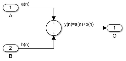

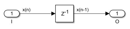

The three fundamental building blocks of the vast majority of DSP algorithms are then adders, multipliers and delays. I hope their behaviour is self-explanatory and I will use the following graphical representation for them:
If we need to add more than two terms we can simply use an adder with more than two inputs. In mathematical terms we say that the addition is associative. In the algorithm world it is traditional to name the filter coefficients h[k], but in the hardware world we will call them c[k]. Think of them as the infinite precision, respectively the quantized version of our filter coefficients. They both represent the same thing, the filter coefficients, but they are not necessarily identical in a mathematical sense, due to quantization effects. The delays are represented by z−1 because that is the Z transform of the transfer function of a one clock delay register.We might also need to cascade multiple such delays in a delay line. If the intermediate values are not needed we can represent such a delay chain by a single multi-clock delay. Here is an example of three cascaded delays:

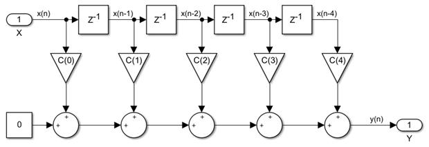

The first step is to move from the domain of math formulas into the real world. We will build a graphical representation of the mathematical algorithm, using the building blocks introduced above. If we take a look at the following schematic diagram of an FIR for the particular case when N=5 it should be obvious that it implements the FIR mathematical algorithm:
But there is a fundamental difference in the way time is handled in the two cases. The mathematical formula exists outside time and n is just one variable in the formula like any other. There, x[n] and y[n] represent all x and y samples, from infinite past to infinite future. In the diagram, on the other hand, x[n] and y[n] are the current values of those signals, just one snapshot taken at time n. The delay block gives us access to the past sample values, the older the samples you need, the more delay blocks you have to use. You need k delays to make input sample x[n-k] available at time n. Future samples are of course not available at all, there is no inverse delay register that could predict future values of x[n] or y[n]. A hardware implementation is possible only when the formula describes a causal filter transfer function. image

While it is possible to design an N-input adder in hardware, it will not be a scalable implementation, a larger adder will run slower than a smaller one. Fortunately, addition is associative, so an N-input adder can be decomposed into a chain of N-1 2-input adders like this:
You may argue that the first adder in the chain is redundant and we do not need it and you would be correct, from a mathematical point of view. You need N-1 adders, not N, to add N terms. But we can already see a repeating pattern emerging, we can build a filter of any size N by simply cascading N basic modules of this type, one after another, like Lego pieces: imageIt would make sense to have all the modules identical, although the first adder and the last delay in the chain are redundant. We will see later that at least in the Xilinx FPGA architecture, once you use a multiplier you get the adder and the delay for free, so we are not really wasting anything. There are also deeper reasons why we would want to have that first input into the adder cascade, at some point we might need to replace the zero constant with a non-zero value for rounding purposes or even with another signal. image
This structure is called the direct form implementation of the FIR equation. In a later post we will encounter a second, equivalent implementation called the transpose form, but we will focus on the direct form for now. It is scalable in terms of device utilization, but not in terms of speed. As N increases and we cascade more and more 2-input adders, it takes longer and longer to compute the final sum, so the throughput will be inversely proportional to N rather than constant. In future posts we will see that this problem too can be addressed, we can achieve scalable throughput at the cost of increased latency through the use of pipelining.
