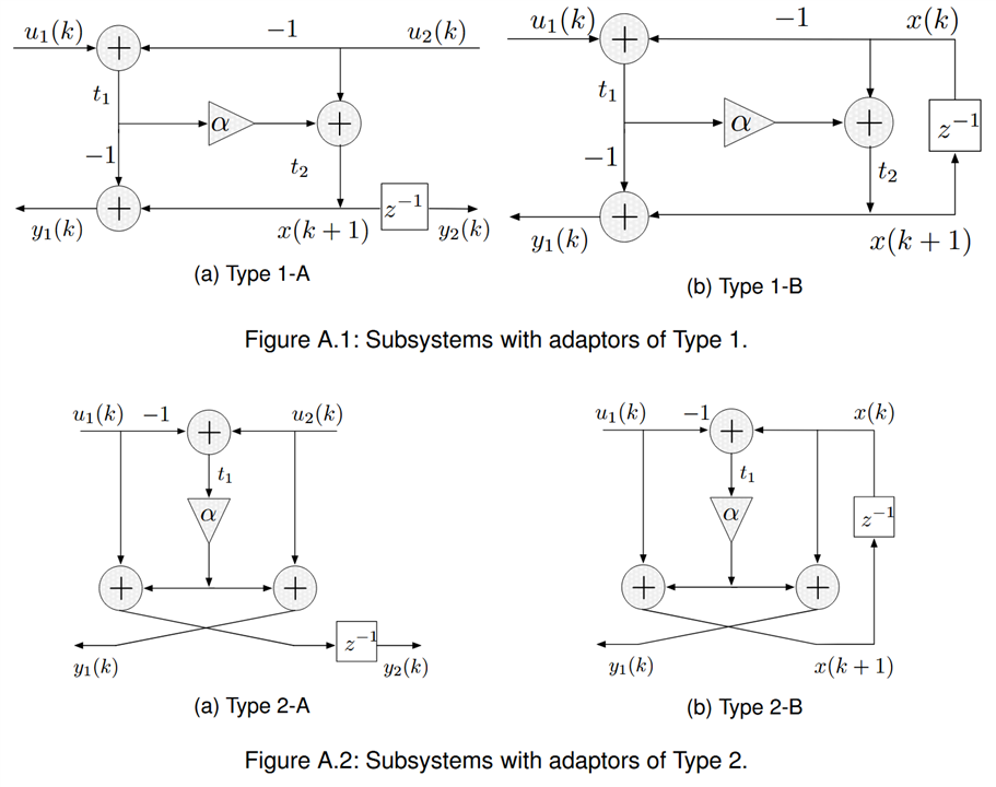

The most common topology for all pass sections is called Richards, coming from microwave transmission line theory. There are two equivalent discrete implementations, Type 1 and Type 2. They are functionally equivalent and differ only in the numerical rounding noise propagation as a function of the coefficient value.
Type 1-B and 2-B can be used as first order all pass sections and cascading A and B Types creates a second order all pass section. Cascading second order sections and optionally one first order section if N is odd can create an all pass IIR filter of any order N. So the first and second order all-pass sections using this Richards topology look like this:
image     image

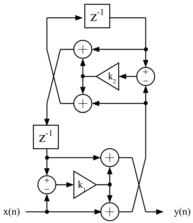

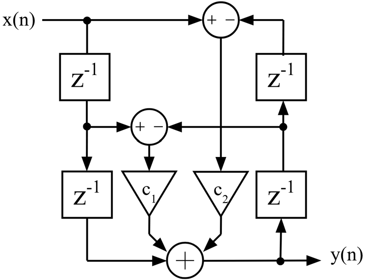

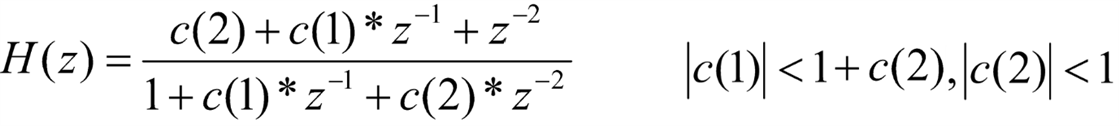

The problem with these all pass building blocks is that they minimize the number of delays at the cost of extra adders. A second order Richards all pas section has two multiplications, two delays and six additions. For an FPGA implementation this is suboptimal, we would like to use two DSP primitives and no fabric adders, which means two multipliers and four adders. Fortunately, there is an alternate all pass section implementation, which only uses two multipliers and four adders, at the cost of more delays, which is not a problem for an FPGA implementation. Here are how the first and second order sections look like:
image                image

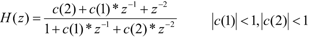

and these are their H(z) transfer functions and the conditions for stability:
image                   image
In general we also want to consider a packing factor n, where we replace every delay with n delays and z-1 becomes z-n in all formulas above.

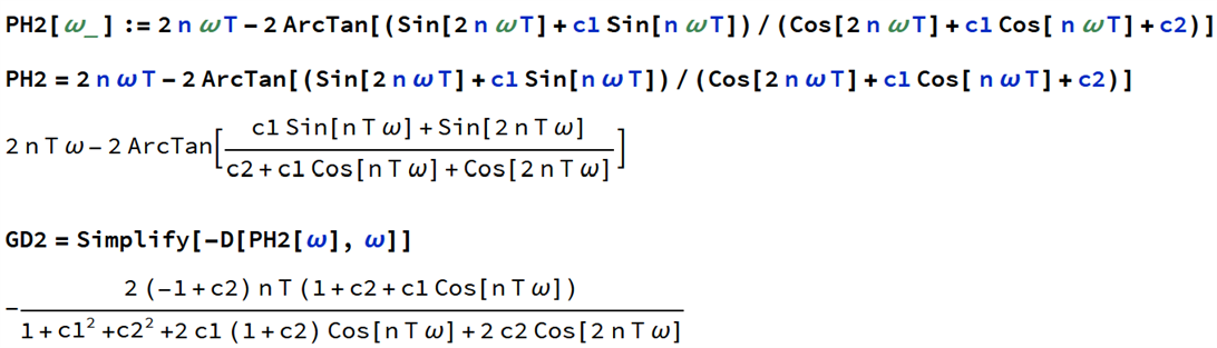

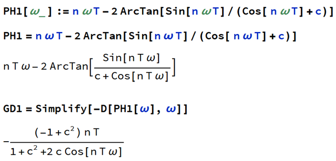

The magnitude of the transfer function is obviously always 1.0, that's what all pass filters are all about. Calculating the phase of the transfer function is relatively easy but I drew the line at manually computing the derivative for the group delays. So I used the free Mathematica Online tool to calculate that for both first and second order all-pass sections with a packing factor n:
image               image
We can now use these formulas to compute both the phase and the group delay at any frequency f. Since a cascade of all pass sections is still all pass, both its phase and group delay are the sums of individual sections phases and group delays and we can use that to analyze any IIR filter built with first and second order sections. .

    An errata for the stability condition for the second order all pass section with transfer function H(z)=(c2+c1*z^-1+z^-2)/(1+c1*z^-1+c2*z^-2), the two conditions are abs(c2)<1 and abs(c1)<1+c2, not abs(c1)<1 as stated in the post.
