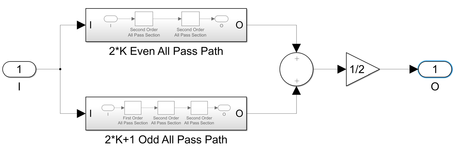

I am finally ready now to discuss the LWDF IIR filter architecture.  In a few words, such a filter consists of two parallel all pass sections, which differ in order by 1, which means that one path is of odd order while the other one is even. The input data is applied to both paths and the output of the IIR filter is the sum of the outputs of the all pass sections divided by 2. If we denote the number of second order all pass sections in the even path by K, we have two cases, N=2*K+1:
and N=2*K-1:
illustrated here for K=2, but K can be any value 1 or greater.
The order of the entire IIR filter N is the sum of the orders of the two paths, so N will always be odd, there are no even order LWDF filters. The magnitude of the filter transfer function is the cosine of half of the difference between the phases of the two paths. The phase and group delay of the IIR filter are the averages of the two paths phases respectively group delays and we have explicit formulas for all of these, which I derived in the previous blog post, so there are relatively simple formulas to calculate the magnitude, phase and group delay of any IIR filter with LWDF topology at any frequency f.
These two structures work as a low pass filter because the phase delay of an all pass cascade of order N always decreases from 0 at f=0 to -N*Pi at f/Fs=0.5, the Nyquist frequency. If designed properly, the two all pass branches will have similar phases in the pass band and add constructively (which is why dividing by 2 gives more or less the input signal), while in the stop band their phases have a difference of plus or minus Pi and will cancel each other. A bonus feature of the LWDF topology is that if you subtract the outputs of the two paths and divide by 2 you get the complementary high pass filter, essentially for free.

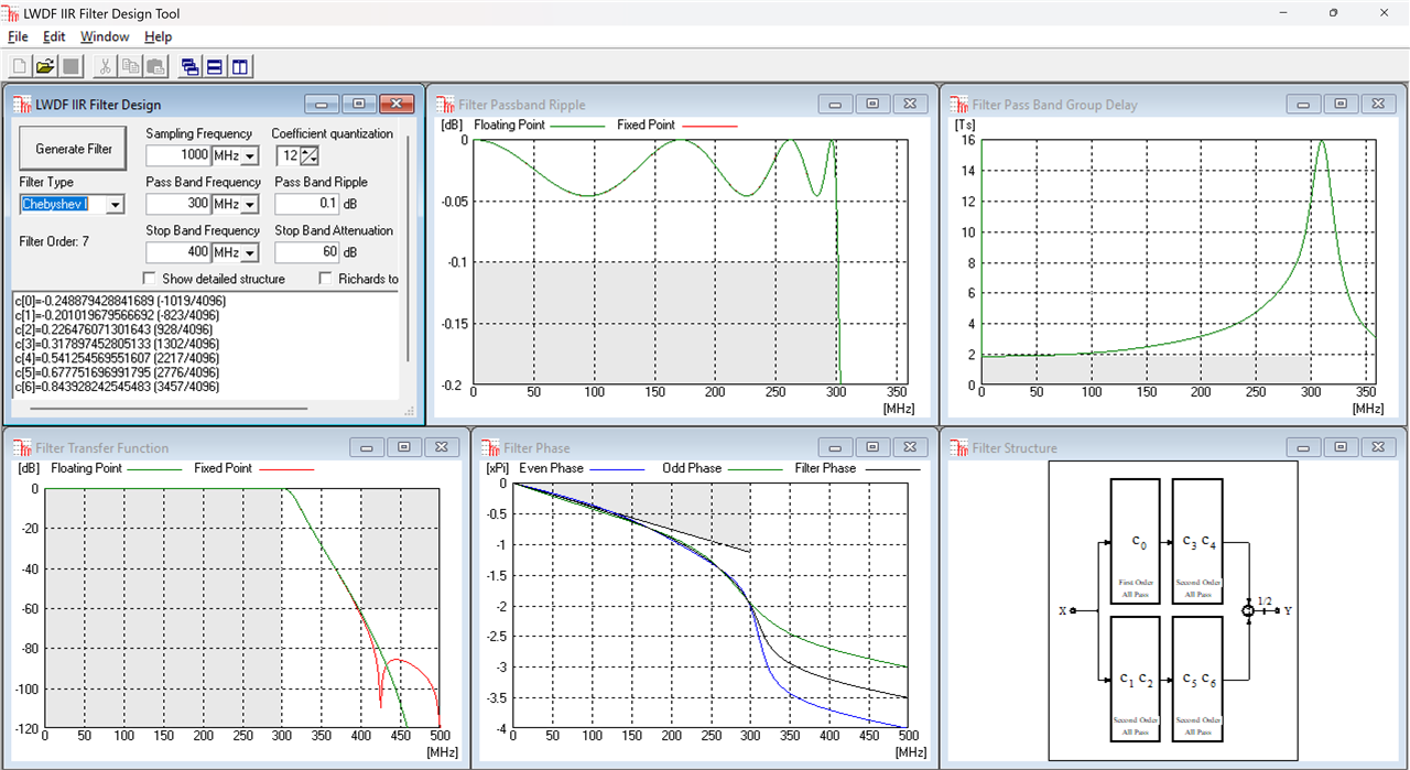

The Chebyshev I filter is equiripple in the pass band and maximally flat in the stop band, relaxing the pass band from maximally flat to equiripple means a filter of order N=7 is needed:

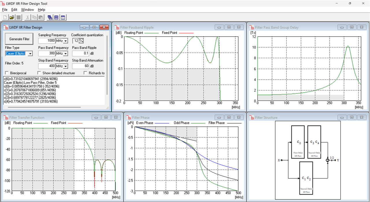

Finally, the Cauer or Elliptic design allows for equiripple in both the pass and stop bands and has the smallest order, N=5:
A further thing to notice is the very low coefficient sensitivity, all four filters basically meet the all the requirements with only 12 bits of coefficient precision. For comparison, here is an equivalent equiripple FIR designed with the Matlab fdatool with the same specs:

Like I already mentioned, the problem of designing these four types of IIR transfer functions using the LWDF topology made out of first and second order all pass sections has been solved 40 years ago by Lajos Gazsi in an IEEE paper called Explicit Formulas for Lattice Wave Digital Filters. So the good news is designing these types of filters from specs is possible using a known algorithm. The bad news is that even after 40 years the paper is still behind a paywall. The four screenshots I used in this post are taken from a Windows program I wrote a long time ago which implements Gazsi's formulas.
