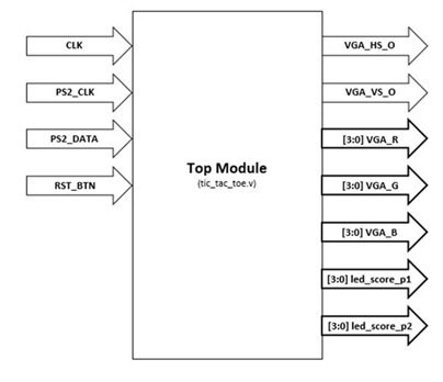

Hardware Design:
The top modules include the following inputs and ouputs:
InputsDescription
CLK
The clock of the board (100 MHz in case of the Arty A7)
PS2PS2_CLK clock PS clock signal and PS_DATA PS2 data
RST_BTNThe reset button of the board
VGAVGA_HS_0 H-sync, VGA_VS_0 V-sync, VGA_R to VGA_B VGA RGB
LEDEnable LED on Arty A7
There are four submodules:
  • vga640x480: used for interfacing with the VGA port at a 640x480 resolution, using a 25MHz clock
  • keyboard_controller: used for reading keyboard inputs from the PS/2 port
  • graphics_display: used for displaying the Tic tac toe game board as well as the squares placed on the screen
  • check_winner: used for checking whether a player has won the game
