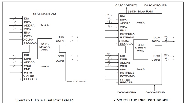

Block RAM
Spartan 6 FPGAs contain BRAM cells of 18 Kb in size, each block can also be used as two independent 9 Kb blocks. Whereas 7 series FPGAs offer 36 Kb BRAM cells which can be broken into two 18 Kb blocks. Additionally, the 7 series also offer some features like built-in ECC, dedicated integrated FIFO, and cascading of BRAMs to form a larger block.

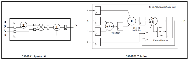

DSP
FPGAs are efficient in implementing DSP algorithms parallel to digital logic with the help of dedicated DSP blocks. Spartan 6 DSP blocks are very simple and composed of an 18 x 18 multiplier along with a pre adder and post adder. 7 series FPGAs DSP48E1 consists of a 25 x 18 multiplier, 48-bit accumulator, pre adder, optional logic block capable of implementing up to 10 different functions (ALU) along with a Single Instruction Multiple Data (SIMD) block, and a pattern detector.

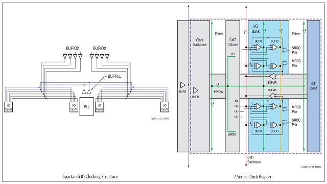

Clock Management Blocks
The clock is very important in digital circuit designs; Spartan 6 FPGA contains up to 6 Clock Management tiles each CMT contains 2 Digital Clock Managers (DCM) and 1 Phase Locked Loop (PLL). There are different clock buffers like BUFG, BUFGMUX, BUFIO2, BUFIO2_CLK, BUFPLL, and BUFH to provide jitter-free low skew clock routing.
Compared to Spartan 6, 7s series clocking structure is simple, flexible along with improved performance which contains up to 24 CMTs, each CMT consists of 1 MMCM and 1 PLL. MMCM is a new functional block with fractional divide and fine phase shifting capabilities. 7 series BUFIOs are similar to Spartan 6 but only span a single bank, each bank has BUFIOs. Many of the Buffers in Spartan 6 are not present in the 7 series and are replaced by new buffers.
