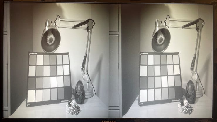

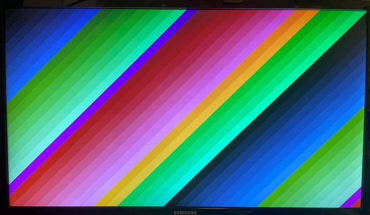

The following test pattern will be visible for ~1 sec (after execution of modetest).
modetest -D fd4a0000.zynqmp-display -s 43@41:1920x1080@AR24 ...
Once the gstreamer pipeline is launched, the following side-by-side image will be visible on the monitor.  Notice that the width is compressed by a factor of 2, which is only to make the dual images fit on the monitor.
run_1920_1080
The lens for each AR0144 can be manually rotated to adjust the focus, if required.
