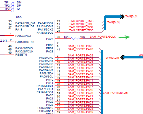

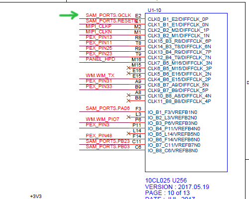

Without connecting anything else to the VIDOR, the only clock we're given to work with is one
that comes from the SAM microcontroller. Here it is on the VIDOR schematic, output from the SAM
part and going into one of the dedicated clock inputs.

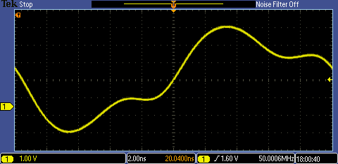

If I take that clock and simply push it back out of an IO pin, I see this on the oscilloscope.
Here we're looking at the rising edge after the one being triggered on, i.e. the end of the
first full cycle. About 1ns of jitter. More than I was expecting.
For comparison, this is the equivalent experiment with my MAX CPLD board with its 50MHz crystal
oscillator, pushing the clock back out of an IO pin.
I wondered if we could use the PLL in the FPGA clock block to clean up the jitter. The Cyclone
10 datasheet has this to say
so whilst not necessarily a particularly good idea, it does look like the PLL could just about manage with
that input as it jitters around.
Way to find out is to try it. This is the output from a PLL set to take the 48MHz clock coming
in and produce a 100MHz clock. (I can literally see the change to 100MHz, because I left the
Johnson counter in there and the LEDs are still sequencing round, only about twice as fast.)
Leaving aside that my 200MHz oscilloscope can only display it as a sinewave, it is much
steadier.
For a lot of simple purposes the jitter on the 48MHz clock wouldn't matter anyway, but there is
the option of cleaning it up with a PLL and, for anything really critical, there's nothing to
stop you adding a xtal oscillator to your own external circuitry for a project. As you can see
from that snippet of the schematic, there's access to several of the dedicated clock lines from
the Mini PCIe connector (the signals that start PEX_).
  • michaelkellett
    michaelkellett over 5 years ago +3
    I'm not that suprised that the SAM output clock is jittery - where does it get its clock input from ? People often use differential clock inputs on modern fast FPGAs. Not sure that the Cyclone 10 quite…
  • jc2048
    jc2048 over 5 years ago in reply to michaelkellett +3
    Thanks for the comment. There's a 32.768kHz xtal. I'm trying to resist the temptation to look at the clock stuff on the SAM and how their firmware sets it up. There seems to be a Digital Frequency Locked…
    Jan Cumps over 5 years ago in reply to jc2048 +2
    R28 seems to be the gateway the designers provisioned for an alternative clock.
    Jan Cumps over 5 years ago in reply to Jan Cumps
    That extra clock is tapped off the Ethernet IC (RealTek RTL8211E-VL INTEGRATED 10/100/1000 GIGABIT ETHERNET TRANSCEIVER), reference clock, 125 MHz +- 50 ppm
    It is not possible. There is only one chrystal that drives the ARM. The ARM PLLs can't be probed because they connect to the FPGA in silicon.
    I should have read the reference manual. On the Pynq-Z2 board, there's an external 125 MHz clock attached to FPGA pin H16.
  • jc2048
    jc2048 over 5 years ago in reply to Jan Cumps
    Sorry, I didn't explain what I meant very well.
    I was suggesting you take a reading from the crystal oscillator that drives the FPGA. The jitter on that should be low, so it will give you an idea of how accurate the timing of the sampling in the oscilloscope is and whether it is contributing to the jitter you see.
    jc2048  wrote:
    What does the output of the 50MHz oscillator look like displayed on your oscilloscope?
    1 MHz:
    25 MHz:
    50 MHz:
