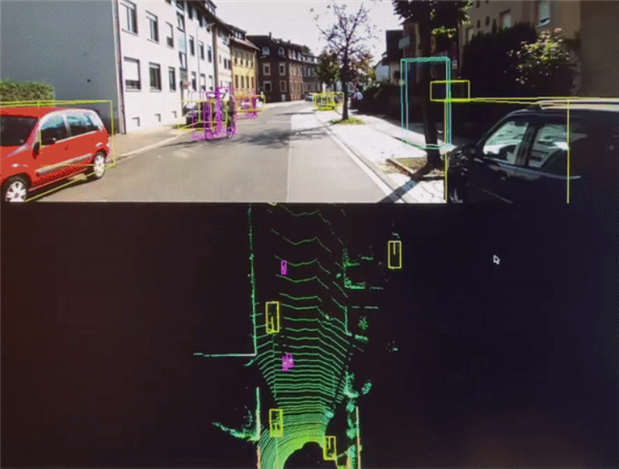

As a bonus to the Element14 community, I wanted to also share how I created the animated image of the point cloud 3D demonstration.
The code for this project is one of the benefits of the Xilinx Developer Program.
     https://developer.xilinx.com/
If you are not registered in the Xilinx Developer Program, you can do it now at the following link:
     https://developer.xilinx.com/en/developer-program.html
Once registered, navigate to the "Demos & Designs" tab, where you can find the source for several application examples, including "Point Cloud 3D detection".
     https://www.xilinx.com/developer/products/vitis-ai.html#demos
As of this writing, the "Point Cloud 3D detection" demo was only provided for Vitis-AI 1.3, but we will modify it for use with Vitis-AI 1.4.
Download the "pp_3d_detect.tar.gz" archive, and copy to the SD card of the Ultra96-V2 board.
The "pp_3d_detect.tar.gz" archive contains many files (.*) which are not useful. I recommend extracting the archive with the --exclude argument to prevent extracting these unwanted files.
root@u96v2-sbc-base-2021-1:~# tar xvzf  ppdemo1216.tar.gz --exclude='.*'
root@u96v2-sbc-base-2021-1:~# cd ppdemo1216/
Several modifications need to be made for use with 2021.1 and Vitis-AI 1.4.
The first is to modify the demo.cpp source file to change one of the headers from iostream to fstream:
//#include <iostream>
#include <fstream>
The second is to modify the build.sh script to change the c++ version and to define OPENCV_FLAGS for the new opencv version:
#g++ -std=c++11 -I. -o demo demo.cpp -lopencv_core -lopencv_video -lopencv_videoio -lopencv_imgproc -lopencv_imgcodecs -lopencv_highgui -lvitis_ai_library-pointpillars  -lvart-util -pthread -lglog
result=0 && pkg-config --list-all | grep opencv4 && result=1
if [ $result -eq 1 ]; then
OPENCV_FLAGS=$(pkg-config --cflags --libs-only-L opencv4)
else
OPENCV_FLAGS=$(pkg-config --cflags --libs-only-L opencv)
fi
g++ -std=c++17 -I. ${OPENCV_FLAGS} -o demo demo.cpp -lopencv_core -lopencv_video -lopencv_videoio -lopencv_imgproc -lopencv_imgcodecs -lopencv_highgui -lvitis_ai_library-pointpillars  -lvart-util -pthread -lglog
With these changes made, we can build the application.
root@u96v2-sbc-base-2021-1:~/ppdemo1216# source ./build.sh
Refer to the readme.txt for instructions for launching the application with the provided images and LIDAR data.
On the Ultra96-V2 and UltraZed-EG platforms, it is recommended to reduce the monitor resolution to prevent the display controller from starving while the DPU is running, which results in glitches on the screen.
root@u96v2-sbc-base-2021-1:~# xrandr --output DP-1 --mode 800x600
root@u96v2-sbc-base-2021-1:~# cd ~/dpu_sw_optimize/zynqmp/
root@u96v2-sbc-base-2021-1:~/dpu_sw_optimize/zynqmp# ./zynqmp_dpu_optimize.sh
Auto resize ext4 partition ...
Start QoS config ...
root@u96v2-sbc-base-2021-1:~/dpu_sw_optimize/zynqmp# cd ~/ppdemo1216
To display the images with 3D annotations, use the following command:
root@u96v2-sbc-base-2021-1:~/ppdemo1216# ./demo ./ppd/vlist.txt ./ppd/ 1
root@u96v2-sbc-base-2021-1:~/ppdemo1216# ./demo ./ppd/vlist.txt ./ppd/ 2
On the UltraZed-EV platform, use the following command to view both:
root@u96v2-sbc-base-2021-1:~/ppdemo1216# ./demo ./ppd/vlist.txt ./ppd/ 3
