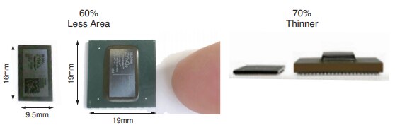

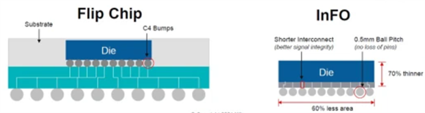

Have you heard about Xilinx’s latest release in the 16nm line, the ZU1/2/3 InFO package? This package uses 60% less area and is roughly 70% thinner than standard Zynq UltraScale+ chip. InFO (for those that don’t know) stands for Integrated Fan-Out. This technology was developed by TSMC and expands on Fan-out wafer-level packaging. To sum up how this is done compared to previous packaging technology, the InFO silicon dies have their packaging grown into them instead of being diced up and placed into packages.
To name a few of the advantages offered by this Fan-Out package first, is better signal integrity due to the length of conductor between the IC and PCB. Second, the heat dissipation is easier to control due to the lack of packaging material allowing a more direct connection between a heatsink and the semiconductor. Third, probably the most obvious and significant is the reduction in size allowing for small complex PCB application enablement. Basically getting a lot for a little PCB space.

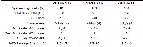

Also what Zynq UltraScale+ Size is of most interest to you? ZU1/2/3? I have shared a chart below of available resources in each package.
  1. ZU1
  2. ZU2
  3. ZU3
