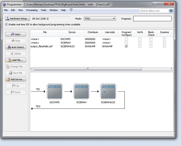

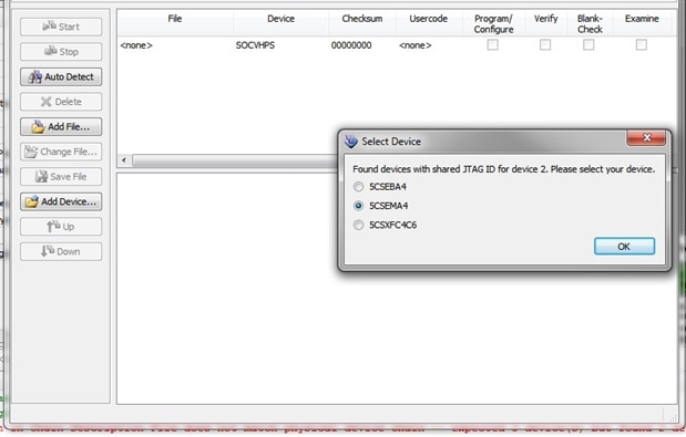

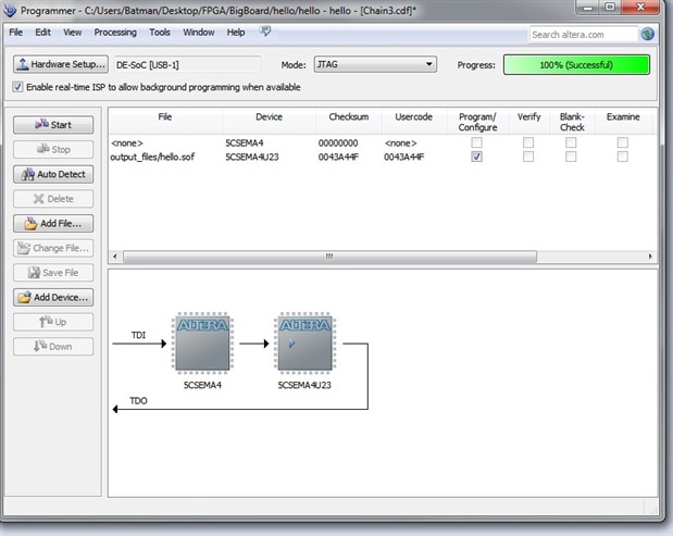

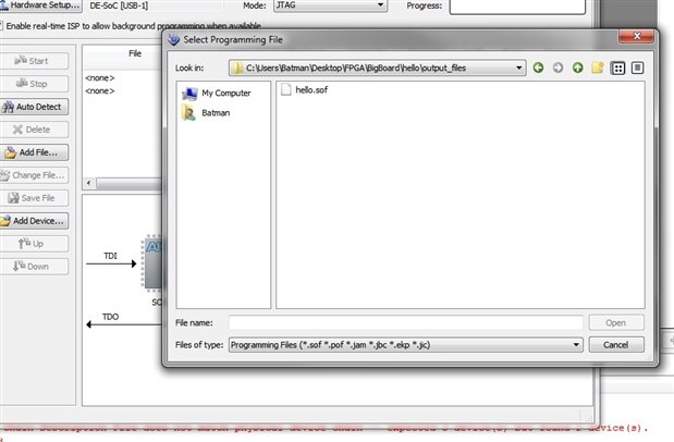

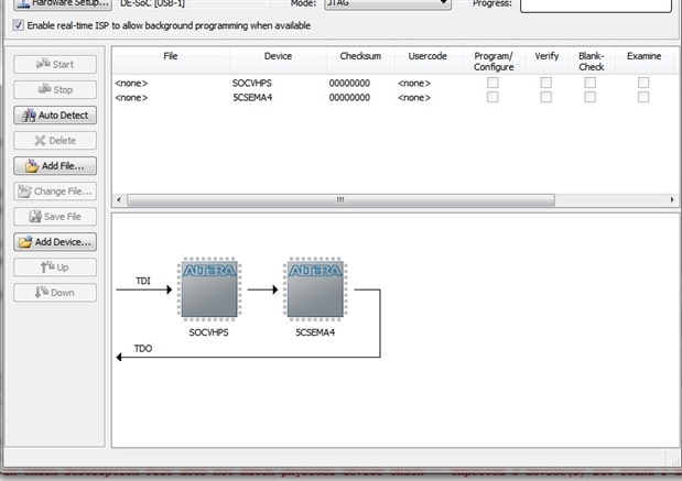

    Let me illustrate what I have an issue with. I finally got the Altera DE0-Nano-SoC board working (kinda).
    I put in my steps so it may help others.
    1.do an auto detect and choose the middle one
    2 load the .sof
    3 delete SOCVHPS
    4 then hit the Start button
    At No point do I get any feedback nor have I seen any troubleshooting guide to give me any Idea what to do it when it FAILS
    It uploaded but the AND gate turned into NAND gate I think it's because the buttons on the board don't have pull up resistors.

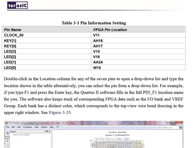

    I would use the other pins and a breadboard but I can't find the full Pin Name to FPGA Pin Location (with a picture of the board)
    At least the Mojo and the CPLD have the Pin names printed on the board.
    e14 Contributor over 10 years ago in reply to johnbeetem
    It is The "They are quite simple to use, but a bit of a pain to install." I have an issue and where I call out both Altera and Xilinx for not supporting the community because It is left to the community to make videos like :https://www.youtube.com/watch?v=wF9vlO-ah-A
    e14 Contributor over 10 years ago in reply to e14 Contributor
    The Pin assignments are  in the DE0-Nano-SoC_User_manual.pdf starting at page 26
