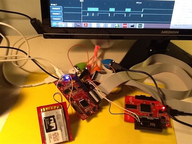

    For me it's budget.
    Because an FPGA board is often more expensive than other development boards, I had to find some synergy.
    I circumvented my conscience by finding additional uses:
    - When I added the board (in my case one of the Papilio members) to my shopping cart, I went over the 'free shipping treshold'.
    - I'm using my FPGA board as a LogicSniffer compatible logic analyzer. That works particularly well for protocol analysis.
