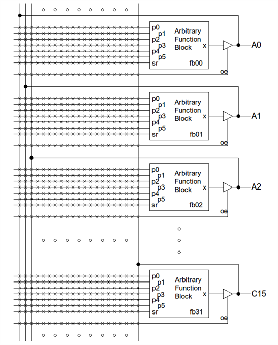

Here is the high-level block diagram for FlaviaP32:
FlaviaP32 consists of 32 identical AFBs, each connected to an FPGA pin which can be either an input or an output.  (Flavia software does not support bidirectional pins in release 0.0k, though the FlaviaP32 hardware does.)  Each AFB implements an arbitrary 6-input Boolean function and has a D flip-flop (DFF).  Each of the six inputs can come from any of the FPGA pins: each of the horizontal lines on the left side of the diagram represents a 32:1 (32-to-1) multiplexer, with each possible input shown as ‘x’.
In addition, each AFB has a set/reset (sr) input which is the asynchronous init signal for the AFB’s DFF, and an output enable (oe) input which controls whether the AFB’s pin is an input or an output.  All FlaviaP32 I/O pins have 2.4 to 10.8 KW pull-up resistors, so unconnected inputs are pulled high.

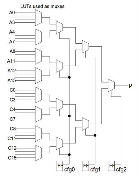

Each AFB needs eight 32:1 multiplexers, which must be implemented using LUTs.  Here is the block diagram for one of these multiplexers:
Each of the eight LUTs selects one of four inputs.  Flavia can program a LUT with a single-input logic function that passes one of the inputs -- perhaps inverted -- and ignores the rest.  Alternatively, Flavia can program a LUT with all zeros or all ones to produce a 0 or 1 output and ignore all inputs.  The eight LUT outputs are combined using 2:1 multiplexers built into the Spartan-3E logic blocks.  These 2:1 muxes are in addition to the LUTs and have very fast local connections that add minimal delay to the 32:1 mux.
The select lines for the 2:1 muxes (cfg0-cfg2) are FFs that are in the same logic cells as the LUTs.  The FF states are also programmed by Flavia.  Basically, to program a 32:1 multiplexer to select one of the 32 inputs, Flavia sets one of the LUTs to a single-input function and the rest to all zeroes, and then sets the FFs to select that LUT.
So, how does Flavia program these LUTs and FFs?  Well, each LUT and FF is in a well-defined location in the Xilinx bitstream.  Normally, Xilinx does not give you the bitstream format, but they make an exception for LUTs and FFs.  This is primarily so you can read back the FPGA bitstream and get the current values of LUTs (which can be used as RAMs) and FFs, but the information provided by Xilinx lets you write your own values into those locations.  Flavia simply takes a generic Flavia bitstream (FlaviaP32.bit), writes the LUT and FF values required for each 32:1 mux into the proper locations in the bitstream, calculates a new checksum, and downloads the result into Papilio over the USB connection.  All this takes less than a second on a reasonable PC.

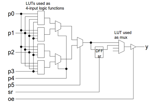

Now that we have 32:1 muxes worked out, let’s take a look at the 6-input AFB.  Here’s the block diagram:
The four LUTs on the left and their 2:1 muxes calculate an arbitrary 6-input Boolean function of the six inputs p0-p5.  Here we make use of the Shannon expansion -- called development by George Boole -- which states that any n-input function can be decomposed by multiplexing two (n-1)-input functions as follows:
Applying this expansion twice, we can calculate any Boolean function of 6 inputs by multiplexing the outputs of four 4-input functions.  We implement the 4-input functions using LUTs, all of which use the same inputs p0-p3.  The remaining inputs p4 and p5 are the select inputs for the multiplexers.
An AFB’s output can be the output of the 6-input function – i.e, combinational logic (C/L) – or the value of the DFF which is updated by the rising edge of a shared 2 Hz FlaviaP32 clock.  We use a LUT as a multiplexer to support future applications.  The DFF has an asynchronous init signal sr which sets the DFF to 1 or 0, configured by Flavia software.  Xilinx FFs have clock enable inputs, but FlaviaP32 doesn’t use them: AFB FF clocks are always enabled.
As you can see, FlaviaP32 has a very simple architecture which means that synthesis tools can be simple.  All AFBs are identical, and there are no routing restrictions so Flavia software can assign any 6-input function to any AFB, restricted only by how the user wants to assign pins to Papilio I/O sockets.

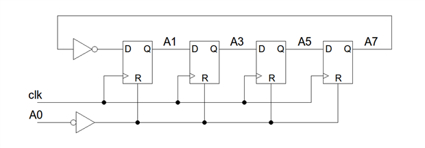

Example 3: Möbius Counter
The third example describes the design as a logic diagram instead of text.  This is a four-bit Möbius or Johnson counter that counts in the sequence 0000, 1000, 1100,  1110,  1111,  0111,  0011, 0001, and back to 0000.
To run this example, open “Moebius4.xoe” in XOE, but don’t compile using F6.  Since this design only uses standard gates and flip-flops from gchd.gi, you compile it by clicking in the figure and then pressing F to issue the Flavia command.  If it compiles correctly, Flavia will download the bitstream and it will begin counting.  Ground A0 or press PB1 to reset to 0000.
