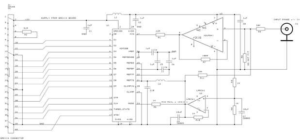

  • michaelkellett
    0 michaelkellett over 10 years ago in reply to msliva
    Here is a schematic of how to connect the AD9200 to the Brevia - I don't think this will work on prototype boards because you need a physical layout good at 100MHz or more (because of the bandwidth of the amplifier) . The AD9200 really needs an additional buffer amp for biasing which I have shown here. All the capacitors are 0603 surface mount except the two 10uF which are 0805. If you are still interested let me know and I'll lay out a pcb. To build it you'll need to get some pcbs made but from OSHPARK or similar they won't be very expensive.
    R2 loops an FPGA pin back to one of its PLL inputs so we can generate an FPGA clock at a suitable frequency.
    MK

  • jc2048
    0 jc2048 over 10 years ago in reply to michaelkellett
    Thanks for posting the circuit. It's interesting seeing how you'd approach this. The AD9200, with its 300MHz sampling capability, looks like a really interesting part.
    Can I ask a couple of questions out of general interest?
    If my reading of the A/D datasheet is right, you're using it in a mode where the input range is 1V and it sits around the mid rail you generate (which you feed to REFBS and REFTS). That would make the A/D input range 1.15V - 2.15V, but the +-1V input will give 0.325V-1.325V at AIN, which doesn't match. Have I got that a bit wrong somewhere?
    Although the LM8261 is happy with an unlimited capacitative load, might there not be an argument for putting in a small resistor anyway?
    Presumably the LM8261 needs supplies on pins 2 and 5. What would the decoupling look like? The video amp is going to be producing supply noise at frequencies where the PSRR of the LM8261 is very poor. Would you have rf style decoupling with inductors and caps?
    When you lay out something like this on a PCB, do you use a continuous ground plane or do you run a moat between the digital and analogue areas with just the power bridging it?

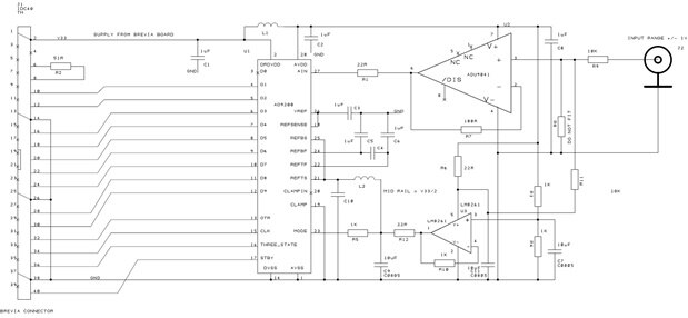

  • michaelkellett
    0 michaelkellett over 10 years ago in reply to jc2048
    Hello John,
    Thanks for the error spotting - I've attached a corrected schematic. The input biasing should have come from rail, not mid-rail. It's an excessively simple design so unless the DC offset is sensitive to source resistance.
    I think the LM8261 would be OK but I've added a series R anyway - it can always be left off.
    I started this design trying to suggest something to Mira (the OP) that could be made on prototype adapters without a PCB but, as I've said, I think that is likely to be very tricky to do and won't work very well, if at all.
    This design would be much improved by adding  a buffer amplifier because the simple method of offsetting the input so it can accept -ve voltages results in requiring a very low source impedance drive. It would be much better to buffer the input (and go for 1M input impedance to work with scope probes) but this would need a negative supply.
    If I were doing this for a commercial reason I would almost certainly use a four layer board with two power planes. usually I have  aground plane and a "vcc" plane with tracks for power but mostly filled in with more ground plane for this kind of circuit. I would probably go for continuous ground planes - when I have split planes they always seem to work better if I join them together again !
