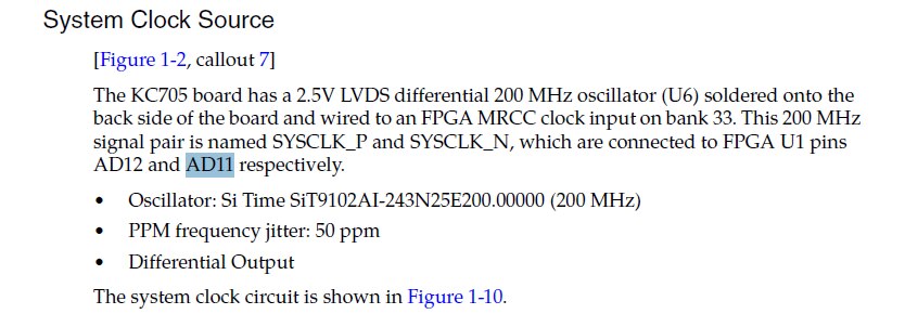

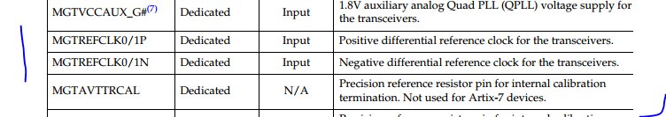

    0 rachit over 9 years ago in reply to michaelkellett
    Hi.  I am still new to FPGA, so don't mind my ignorance.  I went through the user guide for KC705 and found this for AD11 and AD12.
    And then I went through this https://www.xilinx.com/support/documentation/user_guides/ug475_7Series_Pkg_Pinout.pdf  and found this:
    I thought that the pin definitions were similar and hence changed them.  I changed the IOSOURCE based on a few readings.
    The part number for my FPGA is XC7k160tFBG676-2.  Unfortunately, I don't know the board.  But it belongs to the 7 series.

  • michaelkellett
    0 michaelkellett over 9 years ago in reply to rachit
    On page 57 of that document it tells you about the ASCII pinout files. You need to download one of these and look at it with Excel. You need the schematic diagram of your board. From the schematic you can work out which pins the clock is connected to and the voltage at which the IO pins must be programmed to operate.

  • rachit
    Thanks for the help MK.  I am currently an intern, so neither of the options apply to me.  I did dig around.  Found the schematics as per your advice and changed the pins to Y23 and AA24.  Worked.
