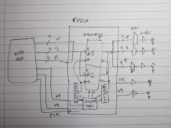

    As to the design itself, this would be my first go at a system block diagram based on what you've said so far
    Here the LCD data gets latched into the FPGA and stored in row/column sequence in an internal memory. Unless you know the two sides won't run past each other, you'd use a pair of buffers, writing to one and reading from the other. You'd then pick it out of the memory at the appropriate times to fit with the output syncs that you'd generate. The colour outputs would then go to video rate DACs [Digital to Analogue Converters]. Sometimes converters can drive cables, but if not you'd need video buffers to do it. The syncs might manage with a logic line-driver (depends what the display is - that would work with VGA, but not necessarily with other analogue monitors). You have to work out how you would get the appropriate output syncs from the LCD clock. You'll find everything simpler if you can lock the output to the LCD signals so that input and output sides are timing related to each other [perhaps by multiplying the LCD clock, since it sounds like the output will have to run on a higher clock rate].
    The DACs and cable drivers would be best on a pcb [they'll need careful layout]. Since it's only 4-bits for each of the colours, it's possible that you might get away with something quick-and-dirty like using resistors followed by a buffer to make your own DAC. Might be worth a try, though don't pin your hopes on it.
    First step, if you're serious about this, is to determine the timing of the LCD drive. You need to sketch out the sync timing, orientation, blanking periods and number of pixels. Then you need to decide what output display you'd use and its capabilities [as in what mode you'd use it in and whether it could work in a way that related well to the LCD]. Then you'd need to consider how you'd piece together a prototype and then start work on the design of the FPGA.
    There's no reason why you couldn't do all that, but it's quite an involved project to do from a standing start if you haven't done any of that before. Do you have any experience with designing with logic chips? If you could do a design for this with CMOS logic and an SRAM, then you could certainly manage the FPGA design [since 'coding' an FPGA is really a disguised way of doing logic design], but if you come from a coding background you would find it more difficult since you'd be learning to do logic design. Unlike processor coding, FPGAs are best programmed with the underlying hardware very much in mind [perhaps think of it like doing very low level assembly programming, with timing so critical that you're counting processor cycles, and with multiple threads all executing simultaneously and having to interact with each other]. It's not as difficult as I make it sound, but you do need a somewhat different mindset from processor coding.
    If you're unsure, I'd encourage you to go for the roadtest and (if you were successful) work through the Altera teaching material. That way you'd find out if you were suited to FPGA design and you'd have a nice development board to work with that could easily cope with what you want to do here.

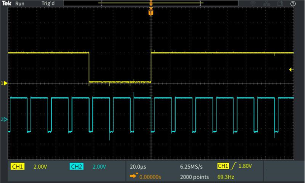

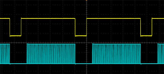

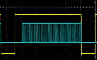

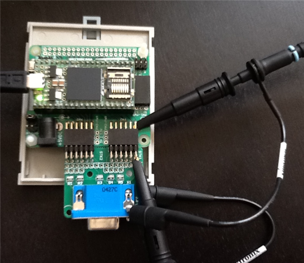

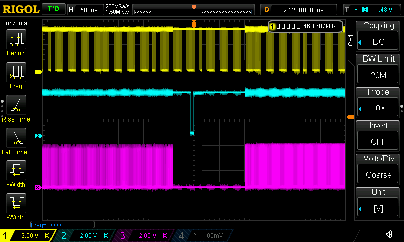

    0 Jan Cumps over 9 years ago in reply to Jan Cumps
    I've been playing with the VGA project.
    I don't have a video cable handy at the moment. As a test I've probed the HSYNC and VSYNC.
    HSYNC and Green 4:
    • Reject Answer
