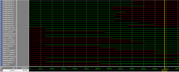

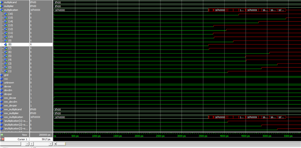

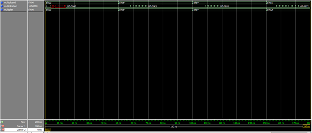

Hello,
I am learning VHDL now and meet a problem.When I use modelsim to do timing simulation,it always gives out red lines(X,mean unknow status)  and when I add internal signals that will be observed to wave windows ,the output show uninitialized .Is anybody can help me solve this problem? HERE are my some extral questions:
1.How to initialize the signals or ports in the testbench?
2.As for the red lins,what occurs that expect from uninitialization?
3.Does it necessary to set clock signals and reset signals in the testbench in combination circuit design?
Thank you!

    init : PROCESS
    BEGIN
          wait for 50 ns;
          multiplier<="00001111";
          multiplicand<="00001111";
          assert(multiplication/="0000000011100000")
          report "error"
          severity error;
          wait for 50 ns;
          multiplier<="11111111";
          multiplicand<="11111111";
          assert(multiplication/="1111111000000001")
          report "error"
          severity error;
          wait for 50 ns;
          multiplier<="10101010";
          multiplicand<="01010101";
          assert(multiplication/="0011100001110010")
          report "error"
          severity error;
    WAIT;
    END PROCESS;
    END mult_nbits_arch;

    The simulator looks as if its going through your process many times with an assumed 1ns delay and the first time something is unitialised- I don't think that's what you want. It may be a quirk of the simulator - for loops can make cascades of logic and the simulator will process them in order.
    Your code is very hard to read, like really really hard !
    Spaces are free: so put spaces between things write a <= b rather than a<=b
    Use indentation, it helps with understanding.
    And use comments !
    I have never (as far as I can remember) looked at code I wrote a few years ago and thought "Pity I wasted time on all these comments", but I have often thought some comments made at the time would have saved me hours later !
    Finally - I can't work out what the for loop is doing and I'm not sure that the simulator can: (some comments would help me, they won't bother the simulator).
    what is varvar (line 21) and why are some things red, some blue and some black ?
    Try showing some more data (like var) in the simulation plot.

    Please re-run the simulation and show 'var' in the timing plot. Asll single bits of the signals would be helpful too, not just the 16-bit signal vector.
    Also, please zoom in, where 'multiplication' changes from green to red at ~4 ns.

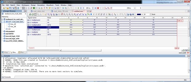

    I poked your code into my simulator (Aldec HDL) and once I'd fixed varvar it  compiled OK.
    Same basic results as Modelsim, but none of the funny business when the data changes.
    My test bench is basically yours but with the Aldec generated wrapper:

    Not sure if this helps you much.
    MK

    Don't give up and thanks for sending the detailed timings.
    It seems that the variables var and sig are missing the initial values and are undifined, which is represented by the red lines. They are only updated at the 1st wait statement.
    Try in the architecture for mult_nbits:
    signal sig:std_logic_vector(2*n downto 1) := (others => '0');
    variable var:std_logic_vector(2*n downto 1) := (others => '0');
    Micheal,
    your result looks quasi identical, the simulator behaviour seems to be different, processing all combinational logic statements are processed at once without a minimal time step.
    Good luck,
    - Wolfgang.
