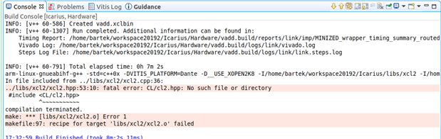

Hi,
I have downloaded minized BSP for 2019.2 version but I couldn't build it.
Petalinux throws me an error while building:
[INFO] building project
[INFO] sourcing bitbake
[INFO] generating user layers
[INFO] generating workspace directory
INFO: bitbake petalinux-user-image
ERROR:  OE-core's config sanity checker detected a potential misconfiguration.
    Either fix the cause of this error or at your own risk disable the checker (see sanity.conf).
    Following is the list of potential problems / advisories:
    Failed to create a file in SSTATE_DIR: Permission denied.
You could try using /home/training/git/avnet/petalinux/scripts/../cache/2019_2/sstate_arm in SSTATE_MIRRORS rather than as an SSTATE_CACHE.
I tried to find solution on my own but without luck.
Can someone point me to right direction or provide solution?
Thanks!

    I have commented last two lines in /project-spec/meta-user/conf/petalinuxbsp.conf like this: #DL_DIR = "/home/training/git/avnet/petalinux/scripts/../cache/2019_2/downloads" #SSTATE_DIR = "/home/training…

    This is error is an unforeseen artifact of creating this BSP with the Avnet build script (Using Avnet Build Scripts to Build a PetaLinux BSP (2019.2 and earlier) ).  The script makes changes to the <>/project-spec/configs/config and <>/project-spec/meta-user/conf/petalinuxbsp.conf files to allow the BSPs to build faster using the local DL_DIR and SSTATE_DIR  folders. This is described in this Element14 blog article Accelerating PetaLinux BSP Build Time .  I forgot to 'undo' these file edits before posting this BSP online.  Your fix to comment these lines in the petalinuxbsp.conf file is the correct one.  I am sorry for the inconvenience.  This will be fixed in future BSPs and in the build scripts.
    --Tom

    All the tutorials I have found are based on outdated tools, so in my opinion it's silly to make tutorial on those. As I can see BSP provided by Avnet are not acceleration ready, so you still need to make modifications to make it work with acceleration flow. I have now modified successfully Minized project 2019.2 to boot from PMOD-SDCARD, so I think it's a good start.
    Now I'm fighting with XRT and Vitis issues
    Vitis has some bugs regarding packaging wrong bitstream to boot.bin and I forgot about clk_ignore_unused in kernel args.
    Now after tweaks vector addition is working image

    So this is output from Vitis after adding platform sysroots (cortexa9t2hf-neon-xilinx-linux-gnueabi) from "petalinux-build --sdk". This is EMMC version
    As you can see, ZYNQ sysroot is missing some libraries.
    Following Adam Taylor Microzed chronicles you can see that He is adding ZOCL and XRT libraries and drivers to petalinux project.
    So there could be two solutions:
    I'm creating Vitis project wrong or BSP's are not 100% ready (HW platform is OK).
    Could you check if I'm right on your side?

    OK, I believe the ZOCL and XRT packages are added to the UltraZed and Ultra96 BSPs.  I will see about also adding them to the Zynq SOMs and MiniZed.
    Thank you for sharing your successful recipe on Hackster.io!
