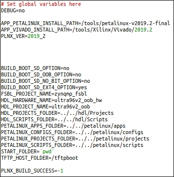

Script Variables
This section is where build options like boot method(s) for the build are set, path locations of where the Vivado and PetaLinux tools are installed, core names of the input and output build files, and relative path locations of where the input files can be found. The script specifies the Xilinx default install folders, and may need to be edited to match your environment. Different boot methods can be selected, and this in turn fetches the specific u-boot bootloader configuration that is needed for the selected boot media. Boot options include SD card, QSPI Flash, and eMMC.  Not all SOMs and dev boards support all boot methods.  The Ultra96-V2 board, for example, does not support QSPI or eMMC boot.  The default for the Ultra96-V2 is SD card boot with a ext4 partition for the root file system (rootfs).  The BUILD_BOOT_SD_OPTION is always set to yes (for the Ultra96-V2 this is always SD_EXT4 boot).

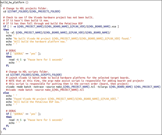

Build Hardware Platform
The build script will first check to see if the Vivado hardware project has already been built. If it has then the script will move on to the next step to build the PetaLinux BSP. This is helpful to reduce run times when this PetaLinux script is run many times during development and debug.

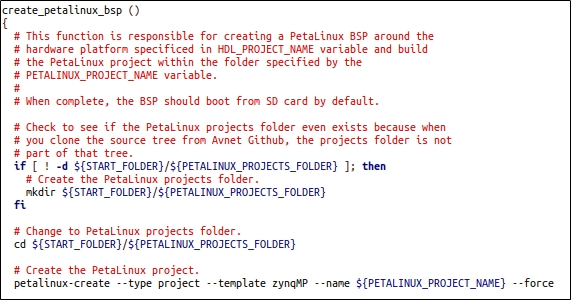

Create PetaLinux BSP
This part of the script is where most of the work happens. It starts with the PetaLinux project is created:
The hardware definition file and PL bitstream from the Vivado project are copied to the PetaLinux project folder and imported into the PetaLinux project:image
The project config file is patched with customized settings:
The root filesystem (rootfs), device tree, and kernel are all configured with their particular settings imported from the configs folders:
Because the script may build a u-boot image for many different boot methods, the current boot configuration must be saved:
Do a full project clean before building the first image:
The script will build a PetaLinux image for each boot method that has been specified in the script variables. The script will loop here until the PetaLinux image is built successfully and the boot method-specific product files will be saved and copied to new filenames so they won't be overwritten later.  Once the builds are complete for each of the boot methods, the binary product files are copied to a project folder and the BSP file is created.

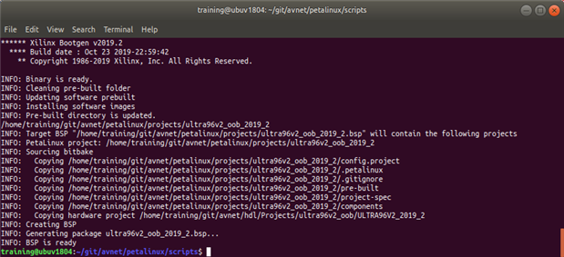

Launch the PetaLinux Build Script
Open a command terminal and navigate to the build scripts folder.
$ cd ~/git/avnet/petalinux/scripts
$ ./make_ultra96v2_oob_bsp.sh
The build will begin and the terminal window will display the progress as the hardware platform is built in Vivado and the the Linux OS image is created.
