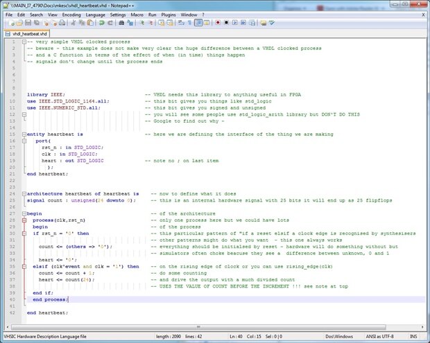

  • michaelkellett
    0 michaelkellett over 11 years ago in reply to johnbeetem
    More on the clocks:
    As far as VHDL is concerned a clock is a signal or input just like any other.
    Almost all FPGAs have special clock input pins that can drive low skew clock distribution directly  - it is likely that the clock chip on your board is connected to such a pin and as John says there will be some way in the tools to define the IO standards it uses and to lock the physical pin the the IO named in VHDL.
    If I get some time later today I'll post a complete LED blinker in VHDL - which will explain some of the key concepts re. processes and their most common use in synchronous FPGA design.
    MK..

  • michaelkellett
    0 michaelkellett over 11 years ago in reply to e14 Contributor
    When the synthesis and fitter tools have finished they produce lots of reports which you should have a look at. You'll find that if you didn't use a clock in your design then there won't be a pin assigned to one, so to answer your question,
    An FPGA design which consists entirely of combinatorial logic will not need a clock.
    In reality such designs are very rare indeed, all FPGA's from A,L M and X are intended to implement synchronous designs so clocks (often several different ones) are needed.
    For example, if you had an 8 digit 7 seg display to drive you could do it with 8 hex -> 7 seg decoders but it would almost certainly be more efficient to use 1 and share it, which would require some clocking.
    As soon as you get on to anything serious you need state machines and they will need clocks.
    (This is because of the way FPGAs work - I think (but can't quote a proof) that any time dependent logic design can be implemented synchronously or asynchronously from a logical point of view - it's just that FPGAs don't do asynchronous stuff well.)
    I haven't forgotten the example - it may happen today.
    MK

  • michaelkellett
    0 michaelkellett over 11 years ago in reply to michaelkellett
    A simple counter example for LED twinkles !
    There must be a way to add a text file - someone please tell how !
    MK

  • michaelkellett
    Hello Scott,
    I've never used the advanced editor before - just for a lark I'll attach a file of the same example.
    Thanks.
    MK
