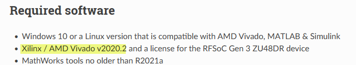

    In case others arrive here, I'll leave behind clips from our online documentation for ZCU208 HDL Coder Support Package.
    Although MathWorks HDLC FIL allows hybrid versions of PetaLinux and Vivado, we decided to keep ours aligned on 2020.2 until MathWorks harmonize PetaLinux and Vivado support beyond 2020.2.
    RFSoC Explorer supports ZCU208 HDLC flows in R2023a (and older). You'll need to go to the download page and click the "Version History" tab to find versions that support MATLAB releases older than the two most recent.
