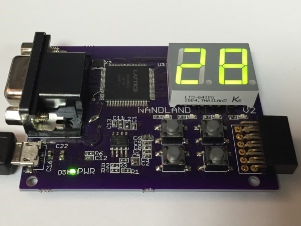

I just found out about the Nandland Go Board on KickStarter.  It’s a nice little FPGA board that looks very well suited to learning about FPGAs since it includes the I/O devices you need for basic FPGA projects.
The Go Board uses the Lattice iCE40 HX1K FPGA, the same one as the Lattice iCEstick.  While the HX1K is a rather small FPGA, iCE40 is the only available FPGA I know of that supports open-source FPGA design tools, specifically IceStorm and its partner tools arachne-pnr and yosys.  iCE40 is also a very simple architecture, which is nice for people just getting started with FPGAs.  Nandland wants to make it fun to learn about FPGAs and play with them -- iCE40 is a good way to avoid the complexity of more advanced FPGAs like Xilinx Spartan-6.

    It looks OK but such a pity that they went for the 1k device. You can buy a 4k part in TQFP (for very little additional cost) which can do so much more, and has a PLL module which is lacking on the 1k part.

    Yes, that is a pity about the 1K device.  While Go Board looks like a good starter board, I could see the FPGA running out of resources "just when it starts to get interesting" (to borrow from Prof. Jones).  Given the cost of the board due to its I/O, it would be nice to have the HX4K or even HX8K.  I believe the HX1K has a PLL on the TQ144 used by iCEstick, but not on Go Board's VQ100.  Currently, IceStorm only supports the HX1K and HX8K, but the latter is only available in BGA.
    I wonder how much trouble it would be for Nandland to switch to the TQ144 and (if possible) make the footprint compatible with both the HX1K and HX4K?  I don't know how much trouble it would be for IceStorm to support the HX4K, but there's no reason to do it unless there's a sizeable number of HX4K boards out there.  Maybe it would be better for Go Board or a successor to go with the HX8K 256-ball caBGA (0.8 mm ball pitch), but then you probably need a lot more layers on the PCB.
    This is why I'd "never" try to design and sell my own FPGA board.  There are so many trade-offs that you very quickly run out of hands ("but on the other hand...")  Better for me to try to support as many existing boards as I can with XXICC and Flavia, and supporting the HX1K Go Board should be trivial.

    shabaz over 10 years ago in reply to e14 Contributor
    Hi Russell,
    I've not used the Lattice part, but I'm guessing it has many Vss pins, and many Vdd pins for core or logic levels. The capacitors should be placed right up against those pins (but looks like they are in a row close to the switches), with the smallest one closest, and the largest ones (e.g. C6 from the photo maybe) next-closest.
    Currently they look close to an inch away from the FPGA, unless there are more on the underside?
    Also, I don't know how popular Pmod still is, but if you're open to evolving the design you might also want to check out mikroBUS to rule it in or out. There are around 180 different boards with mikroBUS, and for home projects is a bit more stripboard-friendly since it uses SIL headers spaced just under an inch apart. Some existing FPGA boards (maybe Xilinx, I can't recall) have Pmod interfaces too. I don't think anyone has jumped on the opportunity to have an FPGA board with mikroBUS interface though. Might be a nice differentiator. Or not, depending on if people already have a Pmod investment or a mikroBUS investment (I don't either way) - I just like that I could slightly more easily use stripboard/perfboard with it.
  • johnbeetem
    johnbeetem over 10 years ago in reply to shabaz
    shabaz wrote:
    I've not used the Lattice part, but I'm guessing it has many Vss pins, and many Vdd pins for core or logic levels. The capacitors should be placed right up against those pins (but looks like they are in a row close to the switches), with the smallest one closest, and the largest ones (e.g. C6 from the photo maybe) next-closest.  Currently they look close to an inch away from the FPGA, unless there are more on the underside?
    Go Board is definitely two-sided, so the Lattice caps are probably right under its VDD/VSS pins.  The discretes near the push-buttons are LEDs and their resistors.  There's a bunch of caps surrounding the 8-pin SOIC.  I'm pretty sure those are for the bottom-side FT2232H and the SOIC-8 is its configuration EEPROM.  An FT2232H needs extra bypass since it has a built-in 3.3V regulator and USB oscillator.
    e14 Contributor over 10 years ago in reply to johnbeetem
    John is correct, the caps are right under the FPGA on the bottom of the board.  I should get some photos of the bottom of the board too.
