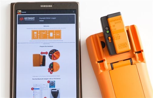

It is not always easy to have a PC nearby, so to make things convenient there are a couple of IR-to-Bluetooth adapters available for the  U1282A.U1282A. One has a 10m range and the other has a 100m range. The 10m range Bluetooth adapter10m range Bluetooth adapter is very low cost, and so could be an easy decision to automatically add to the purchase if you’re buying the multimeter. In the end I went with the 100m range Bluetooth adapter100m range Bluetooth adapter; I may never need such a range but the multimeter will give many years of service and I cannot predict future needs.
If you also have earlier U1200 series devices then the same IR-to-Bluetooth adapters are compatible with them too. The U1240 series multimeters do need a U1179A bracketU1179A bracket though.
The IR-to-Bluetooth unit is well constructed but not rubberized. If the multimeter and IR-to-Bluetooth adapter were to fall off the desk possibly they might disconnect but I doubt any damage would occur. Besides the  U1177AU1177A is quite low cost and wouldn’t be too painful to self-fix or replace or have repaired. It comes with two AAA batteries and these are expected to provide power for 20 hours before they need replacing.
The unit can be used with the same software that is used with the IR-to-USB cable that comes with the  U1282A,U1282A, and there is free mobile software too(search for Keysight Meter Logger in the Android or Apple app stores.
The PC and mobile software is similar but the feature set isn’t entirely the same. The mobile version is missing high speed logging (it instead logs once per second) but benefits from a ‘math mode’ which the PC software doesn’t have (described later).
To cut a long story short, I was deeply impressed with the mobile software. Functionality-wise it does everything I would need it to do. It looks after logs captured, and I can view them again at any time using the software, and can immediately export to CSV or PDF format or obtain images and save them or share them via e-mail, Twitter or whatever. Basically complete integration with other mobile apps through the sharing capability that exists in Android.

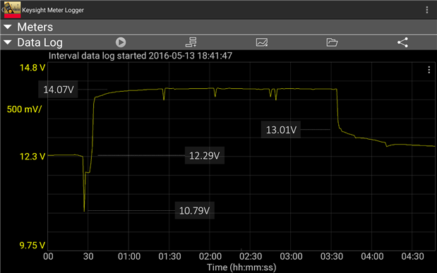

My car battery is in the rear boot (trunk). It was easy to clip directly onto the car battery and leave the multimeter placed in the boot, close it and then sit in the driver seat to conduct the tests! Bluetooth is great (incidentally these croc clipsthese croc clips are also great. I use them for electronics work (they can grip thin wire strands) but they also easily fit around car battery clip screw threads).
Don’t forget to set the range to 600V (so that it doesn’t auto-range during the test).
The car battery is a Bosch one, from Halfords, but I’ve had the same model previously from Halfords too and it failed within a couple of years. I have had this battery for about a year and it is not particularly healthy.
By running the Meter Logger software on the tablet, I had two free hands to start up the car as usual and observe what was going on with the battery voltage. This test verified the car battery voltage with the engine switched off, the voltage during engine startup and the voltage while the alternator was running. I could not have done this easily without the multimeter – I do not have a portable oscilloscope, nor would I have wanted to carry a full-size oscilloscope out to the car, power it from mains and then set up a suitable trigger just to run a quick battery test.
Now that I have the information captured I can quickly save the screen capture to my mobile phone all ready to compare it when I rerun the test during the winter. So simple! I love that I can use this multimeter for such vehicle applications It will not replace an oscilloscope and of course will miss all high speed signals but as mentioned, realistically I would not have used an oscilloscope in the vehicle unless I really needed to. The  U1282AU1282A and a cheap OBDII device are my two main vehicle diagnostic tools now. I’ll be even happier when the 10 captures per second capability can be introduced to the mobile app.

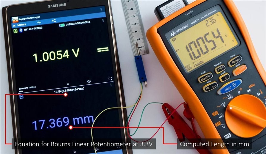

As another example, if a machine needed aligning it could be easier to have a measurement in millimetres rather than a voltage from a sensor. If the machine had a linear potentiometerlinear potentiometer fitted, then this is not a problem!

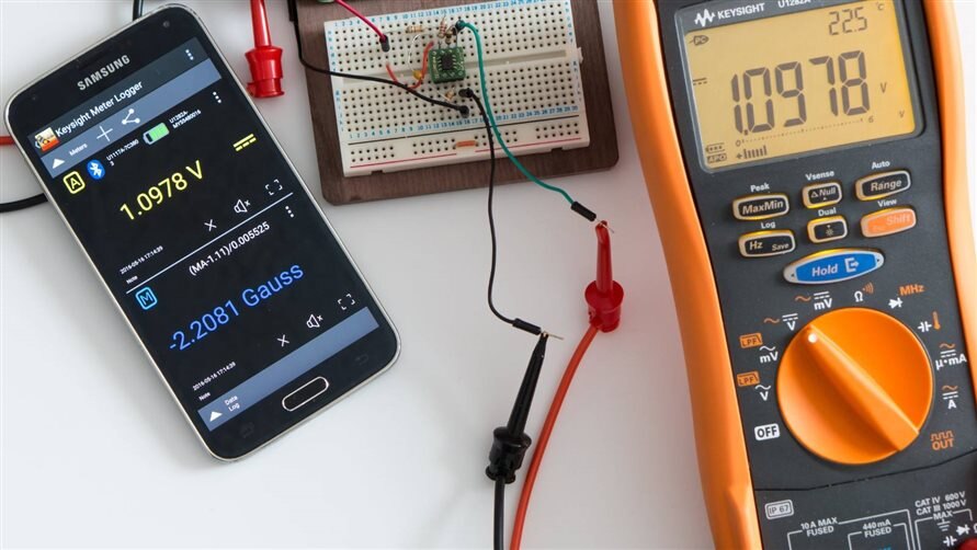

A magnetic flux density (Gauss or Tesla)-meter was constructed using a hall sensor device, and by plugging in the relevant formula it was possible to see that it was performing as expected (incidentally, the Analog Devices AD22151 appears to be fairly accurate from what I can tell.
It was refined by accurately measuring each component in the circuit using the multimeter and adjusting the equation accordingly. I didn’t have an easy way to confirm, but I got Gauss values very close to the expected ballpark when using a small magnet placed on top of the industry standard 9.6mm (well, Lego Industry standard i.e. a Lego brick height). There is an excellent magnet calculator here.

    Okay so I braved the cold and dark and did a check on two vehicles. The first is my 2013 SX4 which has a 2 litre engine and comes with a maintenace free capacitor (it looks too small to be a battery).…

    mcb1 over 10 years ago
    Time for a new alternator or at least the regulator.
    Ordinarily it should be developing 14.2v or more at above idle in order to recharge it.
    The Bosch S5 is a calcium they require the extra voltage to energise the chemical reaction, and they require a special charger.
    http://www.nbindustries.com.au/wp-content/uploads/2015/05/BOSCH-Batteries.pdf
    You could prove the alternator by loading the electrics and seeing if the voltage holds.
    It could also be a poor connection from the alternator to the battery. In many cases the alternator feeds directly to the starter.
    Many regulators actually receive a reference voltage thru the dashboard lamp, so if there is a poor connection it could be thais that causes a poor reference voltage.
    The good news is that it is a 36 month replacement warranty, but the bad news is it seems many have died.
    This could be because the vehicle has a lower voltage regulator and is more suited to the lead acid type batteries.
    Just as warnig to anyone that does flatten a Calcium battery.
    If you think a jumper start and a run down the road for an hour or so will recharge it ... think again.
    Without the extra voltage pulse that chargers suitable for calcium batteries give, you'll be in the same boat when you arrive at your destination ... still flat.
    PS, I'll do some logging on mine to see what mine does.
    shabaz over 10 years ago in reply to mcb1
    Hi Mark,
    Great analysis. The alternator could well be it. When it died a few years ago, it was replaced with a so-called 'rebuilt' one which while a fraction of the cost of a new one, could be providing a lower emf. The Halfords advice on battery selection doesn't go into enough detail to know if a calcium battery is always appropriate or not. I'll have to get a friend with a diagnostics database to check what the expected output is supposed to be from a genuine BMW alternator and regulator. I don't think I've got any OBDII errors, but it has been a while since I checked (and not sure how accurately it would measure it anyway). It will be great to see your output, since you have a new vehicle and battery and the comparison between old and new would be interesting.
    mcb1 over 10 years ago in reply to shabaz
    Given the age of yours, I'd suspect that 14v is the spec.
    I couldn't recall what model it was but the forums had some info on xyz having issues.
    The Jag site was even more particular that they were only ever designed for lead acid batteries. !!
    I should have some figures tonight from a couple of my vehicles.
    In the meantime you might want to load the electrics and see what it produces.
