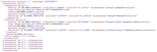

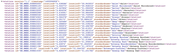

I've made some tests with calls that will be interesting for my application:
  • List stations: useful for defining from where to where you need to take the train
    • http://api.irail.be/stations/
  • List trains from station A to station B on a certain day with a certain departure or arrival time
    • http://api.irail.be/connections/?to=Brussels%20South&from=Lokeren&date=140514&time=0900&timeSel=arrive&typeOfTransport=train
    • From: Lokeren
    • To: Brussels South
    • On: May 14, 2014
    • Arrival: 09:00
    • Transport: Train
The second call returned 6 possible train connections between "Lokeren" and "Brussels South" for an arrival time around 09:00.
This data will need to be parsed carefully and the connection offering the most time to sleep in, while ensuring a timely arrival, should be selected.
In the exceptional case that all trains would be delayed, additional time to sleep in can be provided, while still picking the train connection with the best arrival time.
