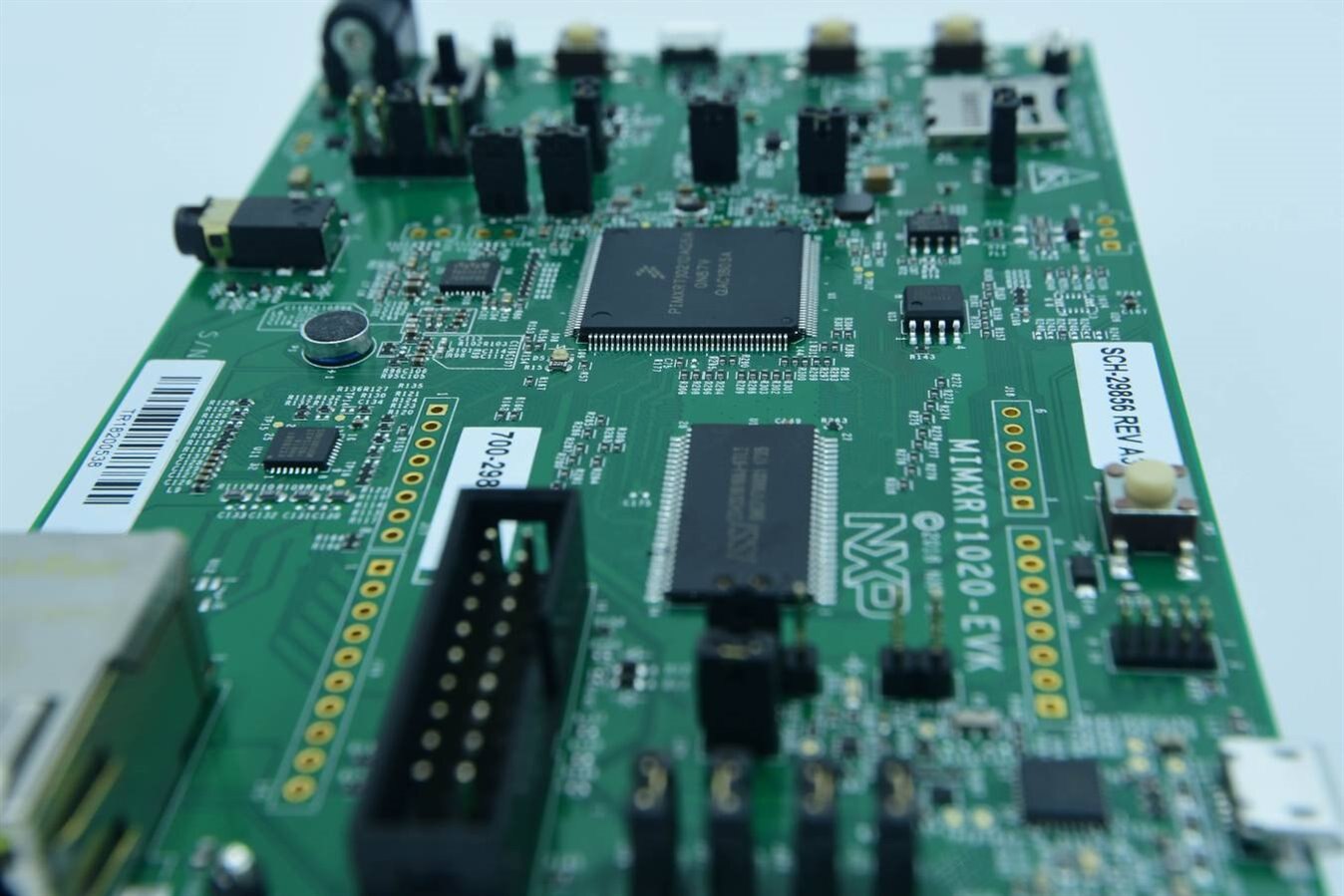

This entry is about the power consumption modes available on the i.MX RT1020; and how to make a current measurement when using the  MIMXRT1020 EVK (Rev A2).
Let’s start with a very short i.MX RT1020 overview, which is a Cortex-M7 based chip that operates at speed up to 500 MHz to provide high CPU performance and best real-time response, it has Advanced power management module with DCDC and LDO to reduce complexity of external power supply and simplifies power sequencing. You can read the complete description here.
To measure power consumption on the MIMXRT1020 EVK (link), the current value needs to be measured on DCDC_IN(J37), VDD_HIGH_IN (J5) and VDD_SNVS_IN (J6), which are the test points for DCDC_IN, VDD_HIGH_IN and VDD_SNVS_IN, as shown in the following images of the schematics:

  • michaelkellett
    michaelkellett over 8 years ago
    Are these tables of data you measured or as they say (at the foot of each table) "typical silicon ....."
    MK
  • michaelkellett
    MK
  • microhero
    microhero over 8 years ago in reply to michaelkellett
    They all were measured for the referenced Application Note.
  • michaelkellett
    michaelkellett over 8 years ago in reply to microhero
    Perhaps when you post verbatim extracts from a corporate application note you should make the attribution much clearer.
    I'm sure I wasn't alone in thinking, at first glance, that this was original and independent (of the manufacturer) work.
    MK
