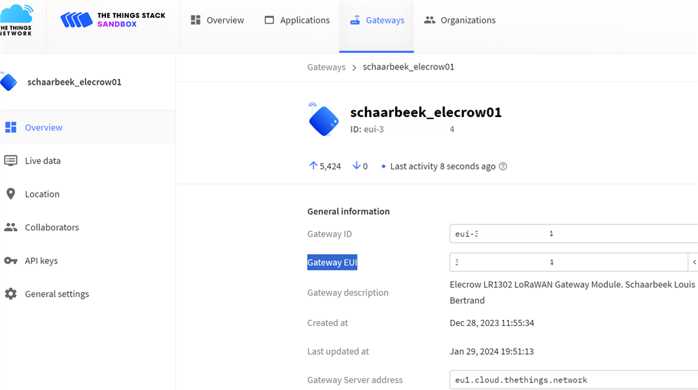

Create new TTN Gateway
If you don't have an account yet, create one. Select the suggested settings for your location. Once logged in, navigate to the console. Select Gateways
Register your new Gateway. Accept the suggested frequency and setup. I used https://descartes.co.uk/CreateEUIKey.html to generate an ID
Then download the json file that's created for you. It holds some of the settings you 'll need to update in the gateway's config file later.

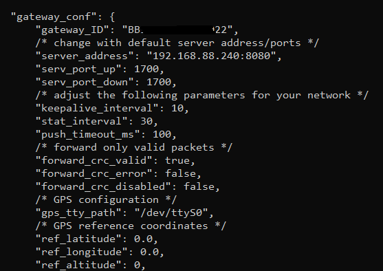

Configure the packet_forwarder
The following section is different than the vendor's instructions:
cd packet_forwarder
nano global_conf.json.sx1250.EU868
I had to change this line extra, not in instructions:
"gps_tty_path": "/dev/ttyS0",
back to the existing instruction
change the EUI in the config file, and check the TTN server URL. Save

The TTN console confirms it found you:
And after some time, you will appear on the maps: https://ttnmapper.org/heatmap/

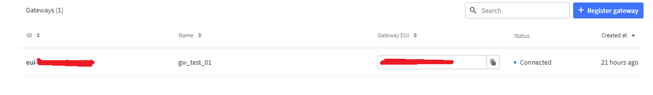

  • kpin404
    kpin404 over 2 years ago in reply to shabaz
    Hello there, thanks all for your support. I have configured and tested to setup with TTN server and it did connected successfully. Now this confirms that there is an issue with my local network server to be to check with. Thanks.image
    shabaz over 2 years ago in reply to kpin404
    Same in my case as Jan. It's critical that the value entered on the LoRaWAN provider site config item Gateway EUI  matches the Gateway ID value (which is also known as Gateway EUI) that is in your LoRaWAN gateway. You don't need to change the value that is in your gateway. You simply copy it, and paste it into the Gateway EUI config box on the LoRaWAN provider site.
    Jan Cumps over 2 years ago in reply to kpin404
    In my case, the gateway_ID is identical (without the blank spaces) to Gateway EUI on the gateway general information page on TTN
  • kpin404
    kpin404 over 2 years ago in reply to Jan Cumps
    Yes! i done all the procedure step-by-step and configured everything including network server access url, gps tty path, but i didn't change the gateway id as its already showing in the configuration file. Do i must have to change it also?image
