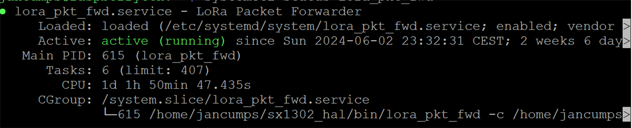

    Jan Cumps over 2 years ago in reply to kpin404
    If you do that correctly, you should have a specific .json file in your service status:
    in my case, the sevice shows this info:
    615 /home/jancumps/sx1302_hal/bin/lora_pkt_fwd -c /home/jancumps/sx1302_hal/bin/global_conf.json.sx1250.EU868
    I see that you have  ....   ./global_config.json.
    This is the file where I had to configure gateway ID and lorawan network url . Did you do all steps from start to end?
    this is a series of several posts. One of them explains how to install the service, and enable it by default.
    I just checked, and it's indeed showing as enabled on my OS.
    I have no idea what the difference is.
