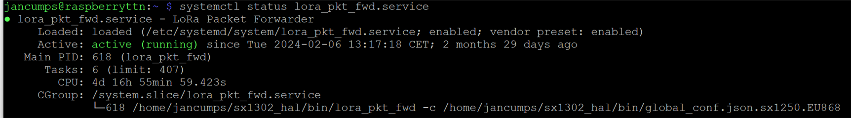

I installed the software for the Elecrow LoRaWAN gateway (see  Low-Cost LoRaWAN Gateways! ), and enabled the gateway on The Things Network (TTN). I used Raspberry OS bullseye 32-bit lite on a Raspberry Pi  A+. I tested this on a B+ with the same OS too.

./lora_pkt_fwd -c global_conf.json.sx1250.EU868
You will get a log of what's happening:
The TTN console confirms it found you:
And after some time, you will appear on the maps: https://ttnmapper.org/heatmap/

Proper install of all software (covered fully in the next blog)
There's more than this. To install all software in a location of your choice, check the instructions on git: https://github.com/Elecrow-RD/LR1302_loraWAN/blob/master/LR1302_HAL/sx1302_hal/readme.md
first edit target.cfg, and set your user name and location where to install (must exist)
Then
make install
make install_conf
Full install post:  Set up Elecrow TTN LoRaWAN gateway on Raspberry Pi - Pt. 2: full install and run as service
Enjoy

    Jan Cumps over 2 years ago in reply to Jan Cumps
    still going strong. 3 months and counting.
