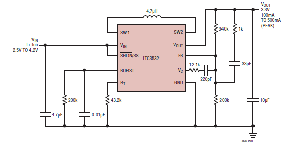

    michaelkellett 4 months ago in reply to dang74
    If you must have 3.3V you will have a hard choice. To get the most out of a nominal 3.7V Lithium Ion battery you would like to run it down to 3V or even 2.7V.
    Fully charged it will deliver 4V.
    For low power stuff you could use an LTC3532 regulator which will do the business:
    I think this is a quite common approach - and there will be other (and cheaper) chips than the LTC3532  but I've used it and know it works. It is also supported by a good model in LTSpice.
    The max input voltage for the chip is only 5.5V so don't forget to have some kind of transient clamp on the input.
    MK

    Hi, Sorry for being a noob. I want to start with the charging unit, I am using FP6277 as charger / booster, I want to connect the 3.7v 4000mA battery to the FP6277 and raspberry pi pico 0 : RP2040, in such a way that it it can charge the battery while connected to usb port and run and boost the voltage as necessary even without connected to USB. It would be helpful if you can send me a schematics so that I would have an idea. I need to see the connection how it is connected also to pico ports. Thanks.
  • michaelkellett
    michaelkellett 4 months ago in reply to GeoForeman
    The FP6277 is a boost converter - not a battery charger.
    You don't need a booster to charge a Lithium Ion battery from USB - just a charger control chip.
    https://www.adafruit.com/product/259
    https://www.amazon.co.uk/Lithium-Battery-Charging-Protection-Functions/dp/B08DQXPNR1/ref=asc_df_B08DQXPNR1
    You could then connect the Pico directly to the battery.
    https://randomnerdtutorials.com/power-raspberry-pi-pico-6-different-ways/#batteries
    I haven't tried or tested any of the above.
    I suggest that you do a good bit more web research before spending money.
    MK
