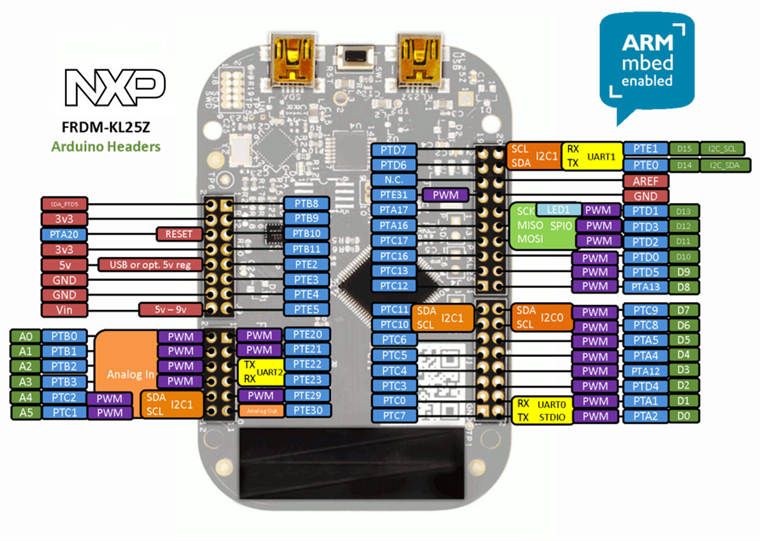

For the project described here, a FRDM-KL25Z microcontroller boardmicrocontroller board is used. It is very low cost (about $15) and easy to program using a USB cable. For more detail about the board and the programming process, see here: Working with FRDM Boards and ARM mbed
The board has 128 kbyte Flash and 16 kbyte RAM, and lots of input/output pins, on a near-credit-card-sized board around 5mm thick - it's really great!

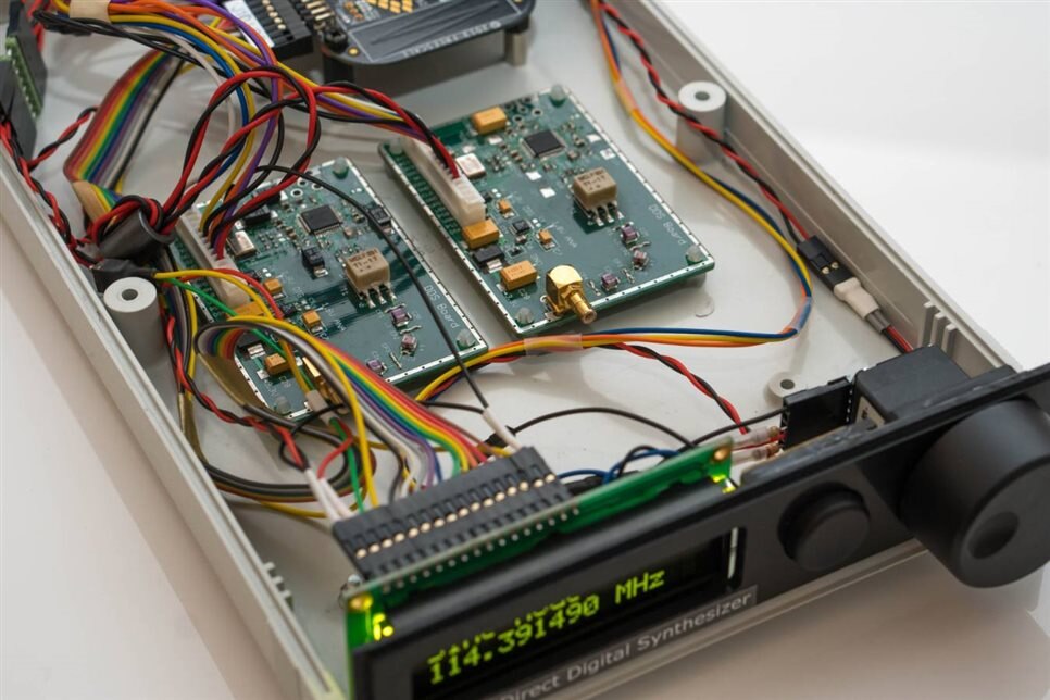

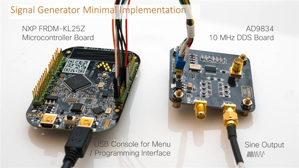

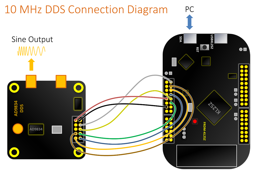

The basic implementation (using a DDS board and the FRDM-KL25Z board connected to the PC for control via a USB serial interfaced menu) takes about five minutes to assemble. One or two boards are purchased and wired together with jumper cables.
For the DC to 10 MHz range, AD9834 boards are purchased. I have only tested a single AD9834 board, but two could be connected in theory if desired, for dual output, but there is no way to synchronise the two board outputs with the AD9834 chip.
For approx. 50 kHz to 160 MHz, AD9954 boards are used.
Nearly all the wiring throughout the project relied on jumper wires. To make these to custom lengths, this crimp toolthis crimp tool is great. It works with the crimpscrimps and then the result is inserted into SIL and DIL header socket shells. Standard pre-assembled jumper wires could be used too.
Here is a table of the specific wiring shown in the diagram above:
AD9834 DDS board markingFRDM-KL25Z board marking (conn. J9)
FSY  (fsync)B11 (PTB11) J9 pin 7
PS (phase select)B9 (PTB9)   J9 pin 3
SCK (clk)E3 (PTE3)   J9 pin 11
FS (freq select)B10 (PTB10) J9 pin 5
SDA (data)E2 (PTE2)   J9 pin 9
RST (reset)B8 (PTB8)   J9 pin 1
GND (0V)GND           J9 pin 12
5V5V              J9 pin 10

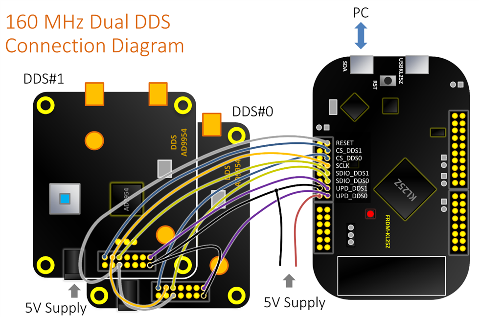

For using the 160 MHz boards, the connection diagram is below. Please note that I believe this diagram is correct, but I don’t have these actual boards to verify. I used some custom boards (based on the same chip) that I created a while back. However I see no reason why the ebay boards wouldn’t work.
With a bit of effort, it will be possible to have phase locked and phase adjustable outputs with these 160 MHz boards, since the AD9954 chip supports this capability. I have not tried it yet, because I’m still considering the optimal way to do that (I didn’t originally design my custom boards with that capability in mind : (
Still, there is plenty of room in the enclosure to add this capability at a future date once I’ve figured it out.

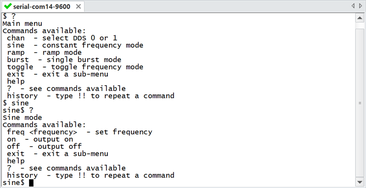

Connect up the output of the DDS board to an oscilloscope or spectrum analyzer, plug in the USB connection into the PC and the project should power up! Open up a serial terminal and connect to the board. Hit the Enter key and a command prompt (‘$’) should appear. You can type help or ? for assistance. Generally the menu structure has been designed to accept a command, or a command followed by parameters. Some commands will drop you into a new level in the menu, and you can exit that level by typing exit.
So, to output a sinewave at 1.2 MHz, type the following to enter the sinewave mode and invoke the signal output at the desired frequency:
$ sine
sine$ frequency 1.2M
sine$ on
Here is another example, to generate a frequency sweep from 2.1 MHz to 2.2 MHz. Here the sweep command will drop you into the sweep mode, so type exit afterwards if you want to go into a different mode. You can type help or ? at any time to get help for the mode that you’re in:
sweep
range 2.1M 2.3M
on
There are extra parameters that can be configured (press ‘?’ to see the commands to do so) for adjusting the sweep steps and so on. I'd like to add a trigger output on the rear panel, so that the project can be used for basic scalar analysis of things like filters.

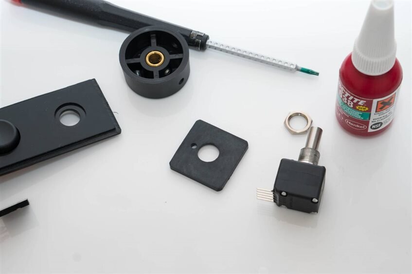

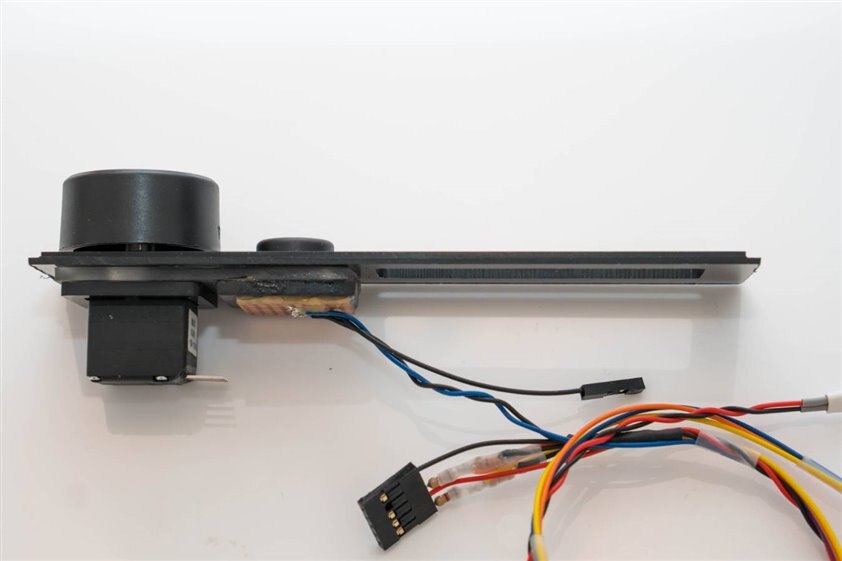

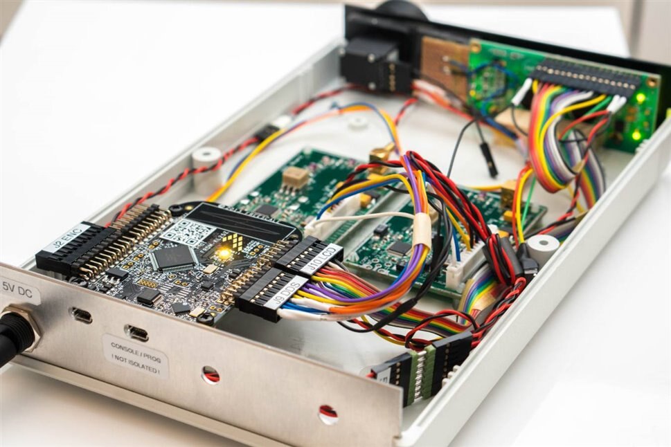

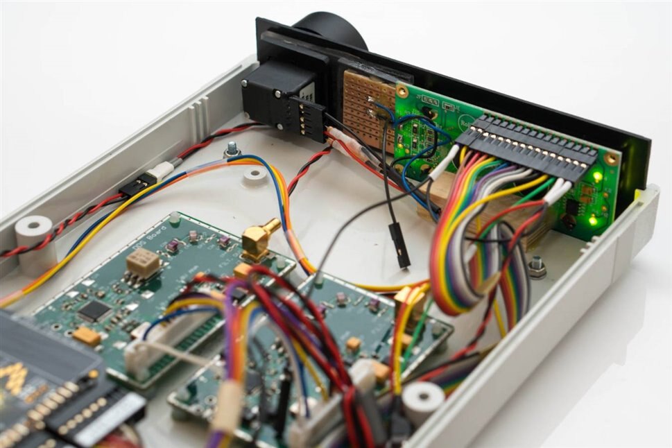

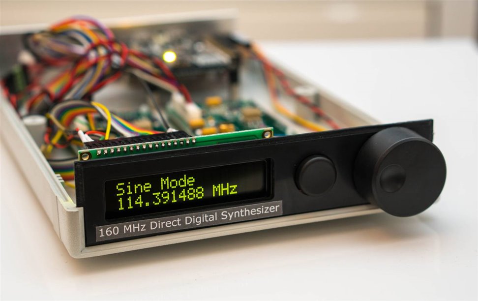

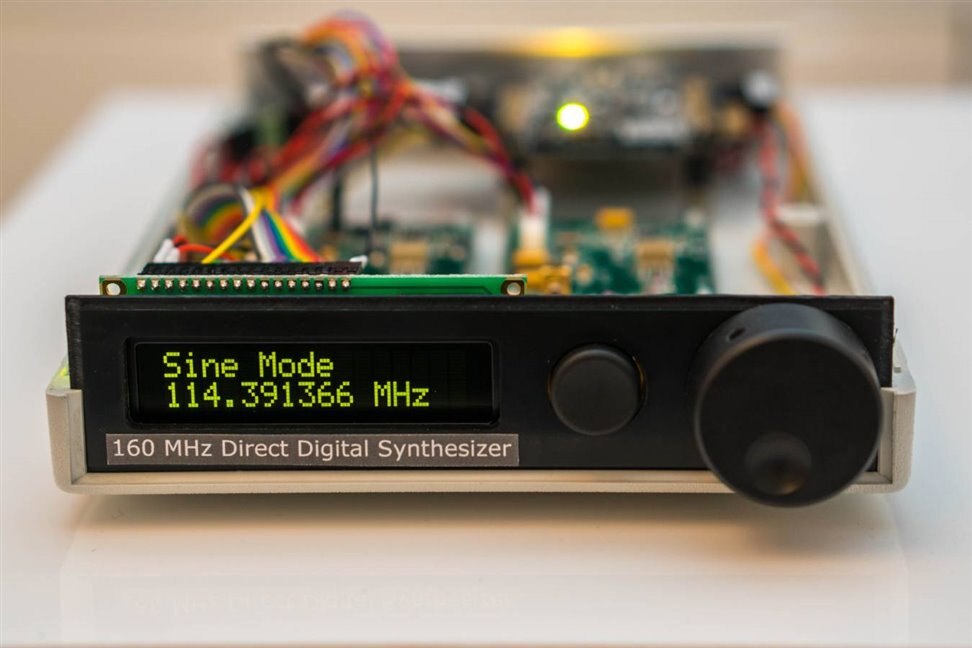

I decided to use an enclosure and front panel similar to what I’ve used before for this project: Building a SMT Pick-and-Place Buddy and so both projects rely on a Hammond instrument case and LCD on the front, and FRDM board stuck at the back so that the USB connector is accessible. The two signal outputs will also be at the back (using SMA connectors) because the front panel ended up becoming too full. It's not very convenient, but I can live with it.
This time I used a parallel mode LCD which is more inconvenient to use than the I2C displays, but I wanted to use it for the high quality output. The display uses ‘VATN’ LCD technology, which looks very close to Organic LED (OLED) in terms of contrast, when viewed at the right angle. So, it has near-OLED looks, but with LCD display lifetime, which seemed ideal for a test instrument. For the user input, I used a rotary encoder. An optical encoder with no detents is quite good for setting frequency, because it can be rapidly spun for getting from one end of the spectrum to the other in a short time. I used a Marquardt switch too. These almost feel like a keyboard switch, so they are light to press.

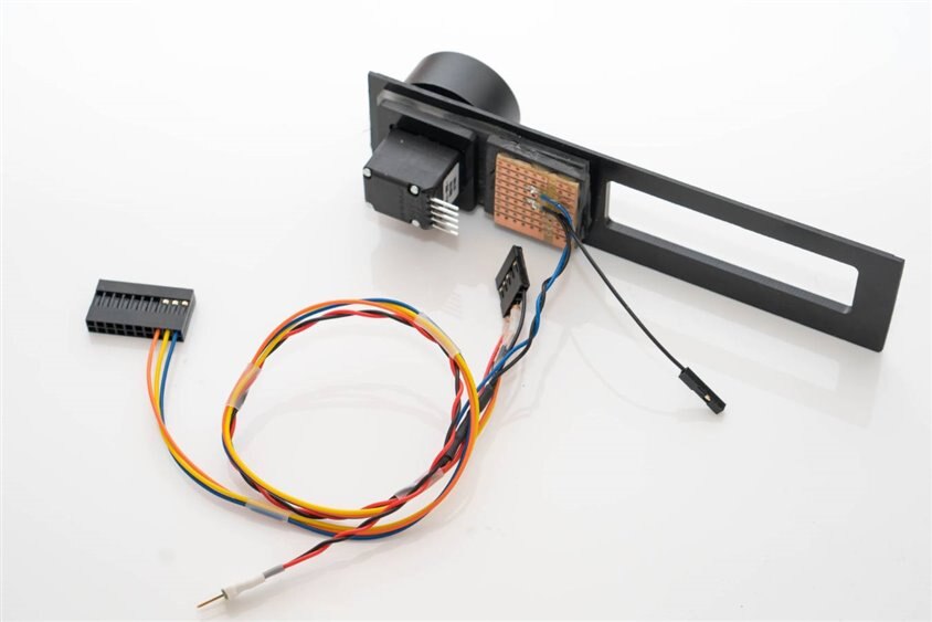

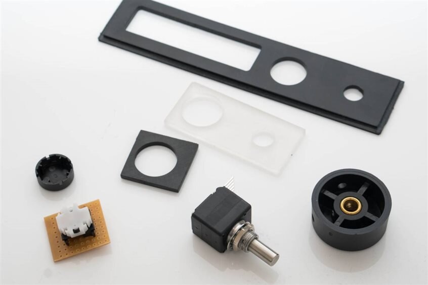

The Hammond case comes with aluminium plates, but plastic is easier to machine so I replaced the front panel with a black ABS plastic sheet instead, and cut a few other bits of plastic to hold the switch and rotary encoder at a convenient depth. A 3D printer could be used to make these, although I did it manually with sheet plastic.
After lots of epoxying, the front panel was semi-complete.
Sanding parts makes them easier to epoxy together. Thread-lock glue was used to hold some of the screwed bits together.
The particular rotary encoder I had operated at 5V whereas the FRDM-KL25Z board has 3.3V logic inputs, so a couple of potential divider resistor pairs were used on the quadrature encoder output lines, to drop from 5V to 3.3V (I used 1.8k and 3.3k resistors); the resistors can be seen attached to the header socket that will be connected to the rotary encoder in the photo below.
The LCD screen was a couple of millimetres taller than the inside of the case! : ( so I had to cut a shallow groove in the top and bottom of the case, to accommodate it. A piece of wood was glued to hold the display in the correct position. Jumper cables were used everywhere in case things ever need disassembly.

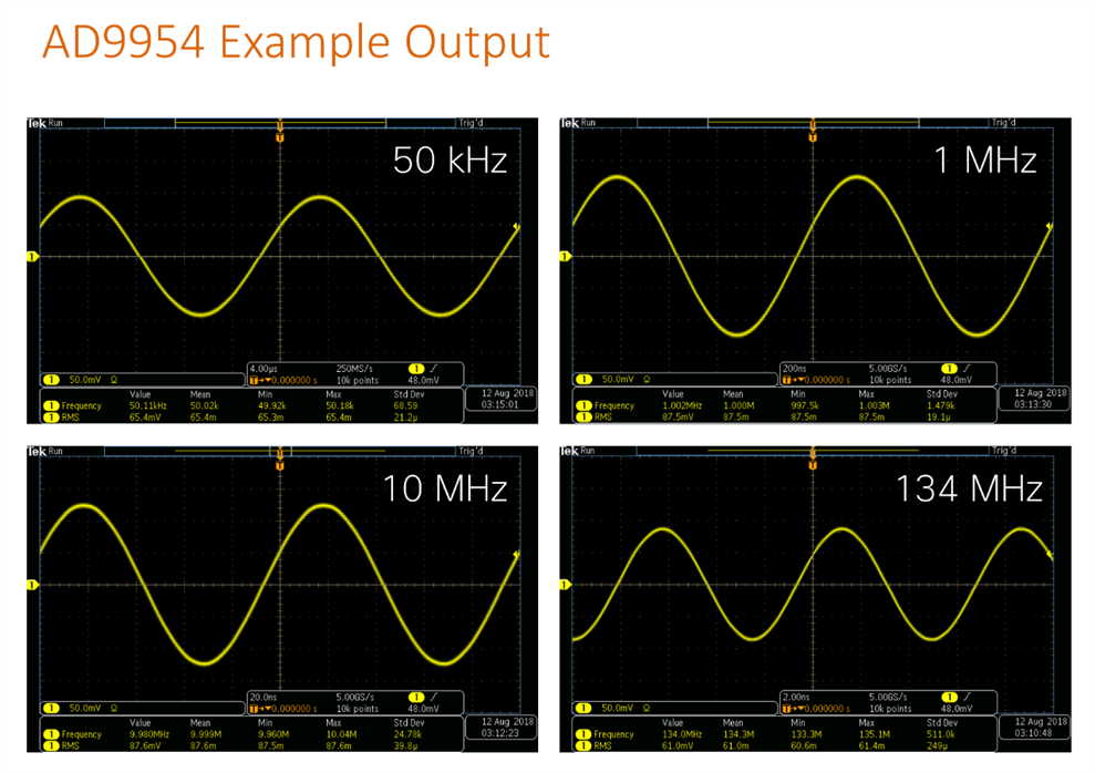

The performance is quite good, but that’s to be expected from DDS technology.

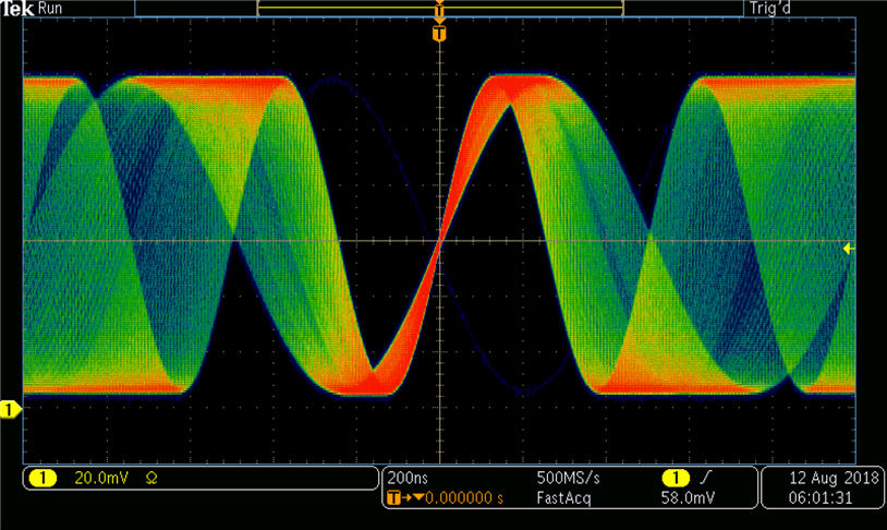

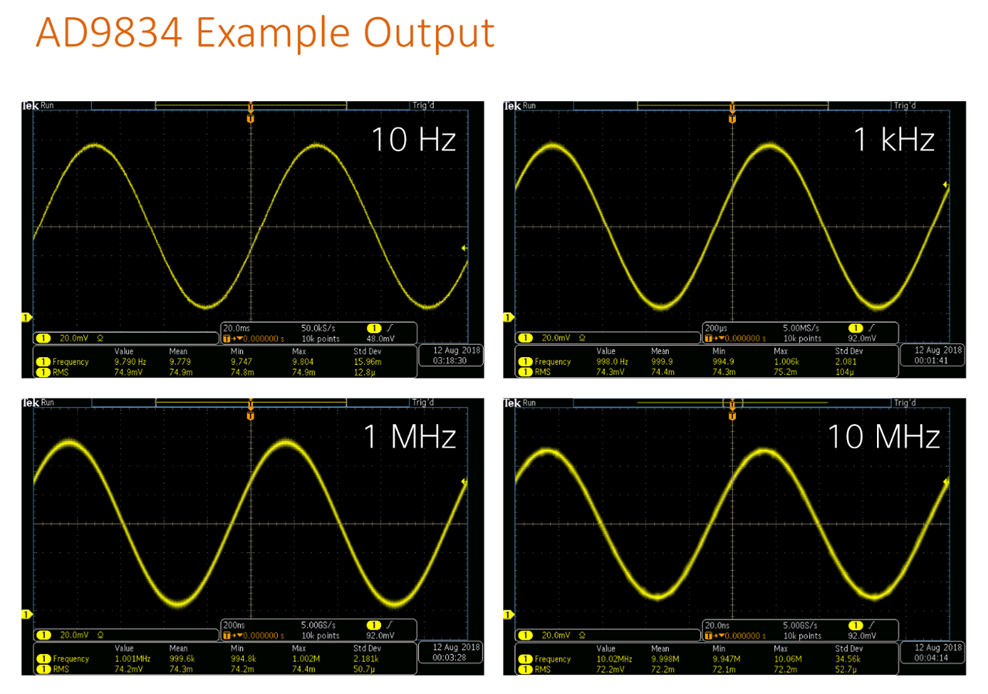

Here is what it looks like on an oscilloscope, using the AD9834 board; the output extends down to DC incidentally, because there is no output capacitor on the board.
The AD9954 board provides for up to 160 MHz output although at the low end it is limited; much lower than 50 kHz results in reduced amplitude, because my board has a transformer on the output. The ebay versions do not have this according to the photos on ebay, so they should extend down to DC.

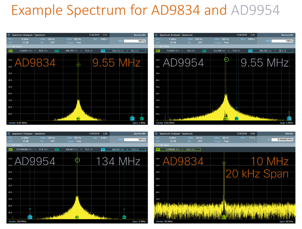

It is hard to tell how good or bad a signal is from the ‘scope trace, so the FPC1500 spectrum analyzer was used. A span of 2MHz was examined when the DDS was set to 9.55MHz, and also 134MHz in the case of the AD9954. The result was good. The close-in noise is almost entirely due to the crystal oscillator module. The module on the AD9954 board for example contains an internal phase locked loop (PLL) to generate a 100MHz clock. Another PLL inside the AD9954 multiplies this by 4 to generate a 400MHz internal clock. I have a 400MHz oscillator module (which still uses a PLL) that I may try at some point; it has worse jitter than the 100MHz module, but it means that I can then disable the PLL inside the AD9954. Or I could try to source a better module, but it could get expensive.
The AD9834 board uses a similar style of oscillator module, with a PLL inside it too I suspect.

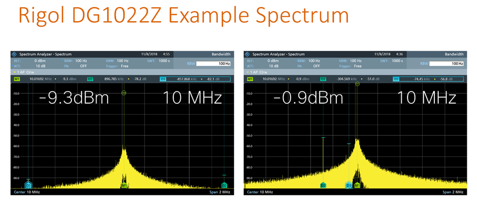

To see how this compared with a commercial signal generator, I connected a Rigol DG1022Z to the FPC1500. The DG1022Z has a 14-bit DAC internally, as does the AD9954 DDS chip.
The result is fairly similar when set to approximately the same power level. At higher output level this situation can change! - see the second spectrum trace below.
The DG1022Z operates to 25MHz, and I only tested at 10MHz. The AD9954 can go to 160MHz. Of course the DG1022Z is more flexible since it has arbitrary waveform capability too, but if just a sine wave and a few frequency modulation based schemes are required, then the AD9834 or AD9954 are great options.

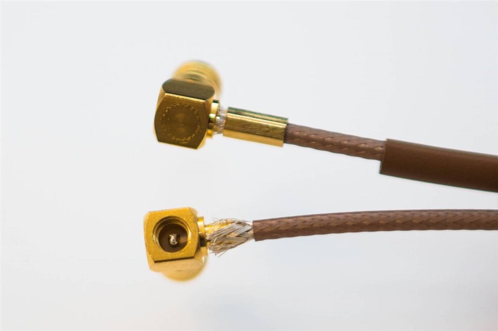

    I progressed a little further today.. assembled the connectors (SMB plug to SMA socket).
    Really not fun, soldering to an area about 1mm2 but buried several mm inside a hole with no visibility when the iron is inserted..
    The crimp ring was off by about a millimetre as seen in the photo below, but at several £GBP per connector I wasn't going to reattempt..
    (the coax in this photo is 2.5mm diameter, for scale comparisons).

    Getting all those cables cut to length and crimped properly is an art to it's self. Also soldering to that thin Coax is annoying especially if you need a load of heat and the dielectric just gives out ...doh
