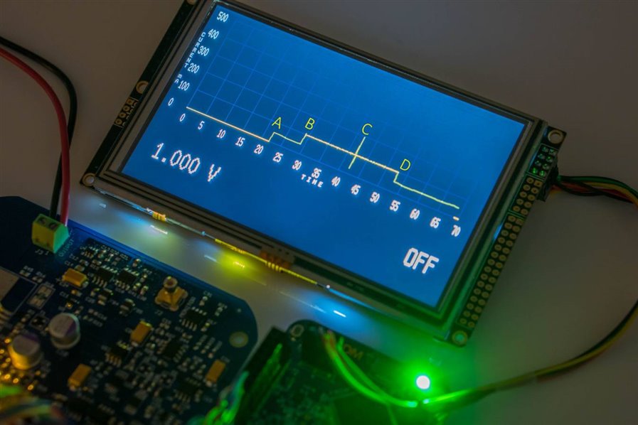

    shabaz over 8 years ago in reply to michaelkellett
    I thought I'd take a stab at it, and the guts of it kind-of-works, but needs lots of tuning.
    There was a ready-made library called CMSIS DSP with some PID functions, so I used that. I only set the 'P, and I can see the behaviour of it when I deliberately try to overload the output beyond its set value and so on, but it all needs lots of tweaking and testing.
    The only test I've done so far is the one in the photo below. The vertical axis in the photo below is 100mA per division, and this new current limit feature was set to 100mA.
    Basically the load is set to 20 ohms, and at point A the output was set to 1V, so I see about 50mA on the screen, as expected. However at point B, I set the output to 2.2V, so I should see 110mA if there was no current limiting. But current limiting is enabled, and the output is held at 100mA. At point C, I tried to set the output to 4V, which would correspond to 200mA, and I do see a spike, but it settles back on 100mA. At point D, I set the output to 1V, and the current went back to 50mA as expected.
    I think a feature is needed to auto-annotate the display with a 'set voltage' marker, each time the voltage is changed..
    In summary it approximately works but it will be nice to allow the user to select current limiting mode, or electronic fuse mode (or both maybe!).
