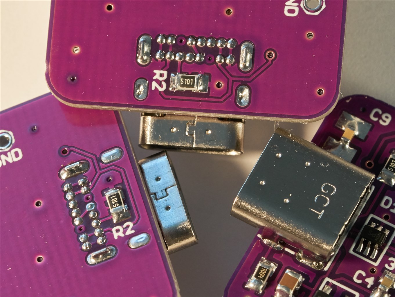

The USB C connector is part code USB4085-GF-A and is straightforward to hand-solder (needs a 1mm diameter, or smaller, soldering iron tip, and 0.38mm diameter solder (or use solder paste).

    shabaz over 4 years ago in reply to wolfgangfriedrich
    The USB connector was easier than I hoped, the through-hole pins only barely poke out with 1.6mm thick board, so it doesn't easily accidentally solder-bridge to other pins. Of the four corner metal tabs, two of them stick out a lot, and the other two are recessed, but poking the soldering iron tip into the hole and feeding in 0.38mm solder works very well for the recessed ones.
    I made a mistake on this revision 2.0 board and wrongly had tented vias for a couple of the unused pins, i.e. solder mask was plugging them which meant that the unused pins couldn't enter the board, and I needed to snip those pins off to make it fit. The revision 2.1 board files are corrected.
