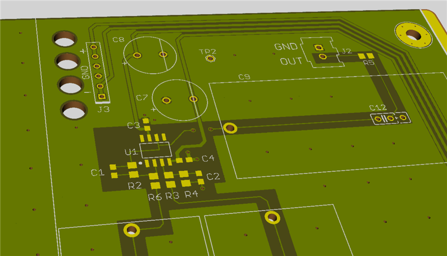

As mentioned I was working on a microphone amplifier, so I had lots of spare PCBs that accommodated a single op-amp on each. So, for the prototype, I used two of the boards (one was cut in half). The cables for the sound card were directly wired without sockets. The battery holders (two AA cells are used for +1.5V and -1.5V rails) were glued onto the PCB. The whole design should hopefully slide into a case intended for 160mm wide PCBs (I don’t have the case yet).
For the device-under-test (DUT) connection, I used a home-made cable set: Building Kelvin (4-Wire) Test Leads
The Gerber files are attached to this blog post, but they are not very useful for this project - better to build a dedicated PCB. Here's a close-up the op-amp area:
