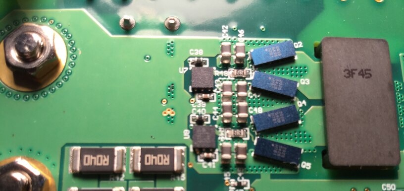

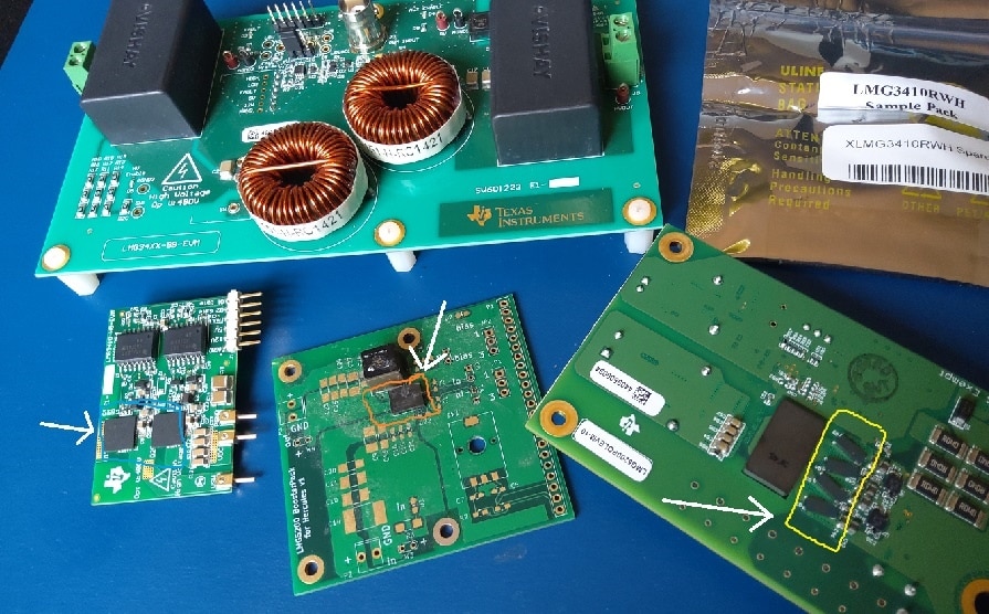

    We seem to share an interest:
    I'm experimenting with GaN FETs too. In the image above, the ones with yellow border are EPC devices. The ones in the blue and orange block are TI devices.

    Very cool. with your EPC devices in the yellow boarder, do you have them mounted at an angle to get the connections as short as possible?

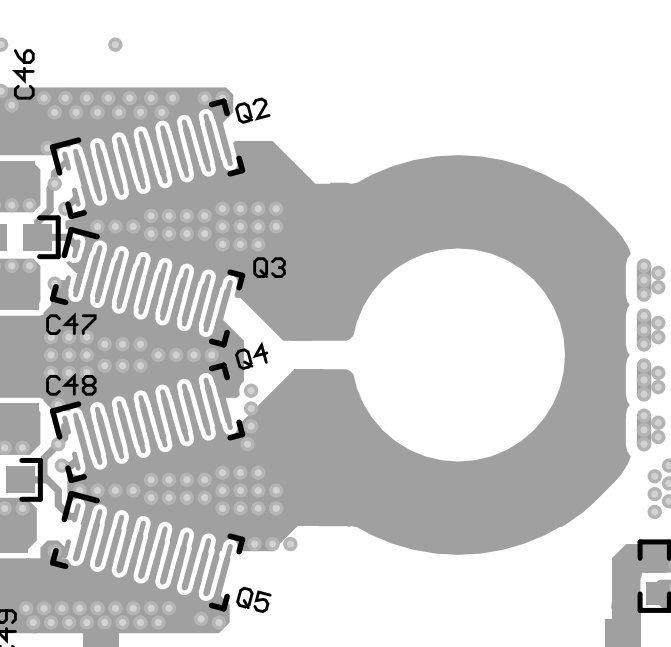

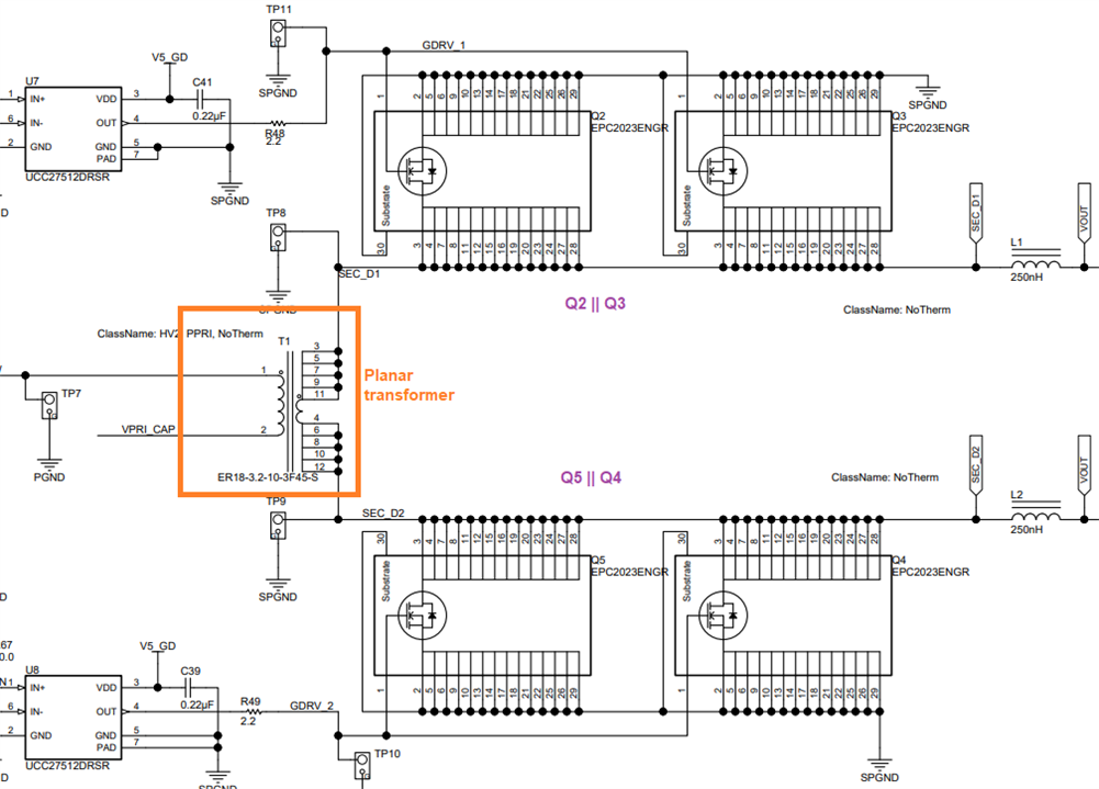

    Jan Cumps over 4 years ago in reply to kkazem
    It's a TI design. Two times 2 FETs in parallel (ga
    The layout and the foorprint:
    The application note explains the principles: https://www.ti.com/lit/ug/snvu520b/snvu520b.pdf.

    kkazem over 4 years ago in reply to Jan Cumps
    Jan Cumps:Thank you for your comments and for the TI GaN design. I hadn't seen that before.
    There are a few things I found interesting about the design:
    1. The FETs are actually paralleled at the gates. One would never do this with Silicon MOSFETs as it can cause problems due to one of the two turning on slightly before the other. In this case, the GaN devices probably turn on so fast, it might not be an issue.
    2. I'm surprised the switching frequency isn't higher (more like 1-2 MHz) rather than 600 KHz. Although I used 500 KHz in my design for optimal efficiency.
    3. The buck inductors are only 250 nH (1/4 of a microhenry). That's tiny, but it will allow a very fast ramp-up to full (50A) output current.
    4. It's using six (6) GaN FETs total in the design. For a buck converter at 50-75 watts, it seems excessive. I think TI is asking their application engineers to make designs that use a maximum number of TI devices for sales purposes. After all, that is the purpose of application engineers, to sell. Yes, they also can help customers with their design problems, but they're primarily there to support sales. Not that I think that's wrong, it is what it is. But us practicing engineers must take these app notes with a grain of salt.
