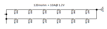

To proof this, the evaluation board has the option to inject a fast rise/fall 8 A extra current draw (the slew rate is a fast 10 A/μs).
This is done by switching a 120 mΩ resistor in parallel with the output.
It adds and removes that 8.3 A to the current that you are already drawing from the converter.
555 Timer
One of the reasons why I wanted to show this part of the DC converter, even if it's not part of the core design, is because it uses a 555 timer.
Every time I spot one in a modern design, I feel the urge to blog.
Here, it's the CMOS variant LMC555 that can clock up to 3 MHz. It's configured for 1.3 kHz.
The timer is controlling a gate driver IC. That one drives a power MOSFET. When this FET is driven, it switches that extra load in parallel with your test load.
When it's not driven, only your test load is active.
This means that the current changes dynamically two times per cycle, giving a 2.6 kHz dynamic change frequency (the documentation says 2.5 kHz).
The measured duty cycle is 34% (33% in the documentation).
The 120 mΩ resistor is in reality a set of twelve 3W 40 mΩ resistors - two strings of six in parallel.
