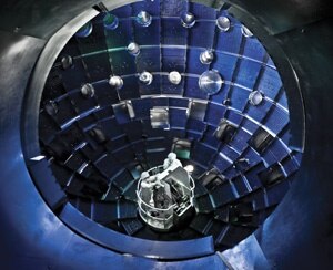

Scientists at the National Ignition Facility in Livermore California hope to have the world’s first sustainable fusion reactor powered up and running by 2012. Guessing by the ancient Mayan calendar that say’s the world will end by that year, scientists speculate the sun will no longer function and need a ‘replacement’ to missile off to the center of the solar system. Seriously though, engineers designed the reactor to use 192 lasers aimed at small BB sized glass targets that house the hydrogen isotopes tritium and deuterium. The lasers simultaneously, in a fraction of a second, pulsate ultraviolet laser energy (equivalent to two million joules) to their respective targets. The resulting energy released through this process, known as inertial confinement fusion, was around 1.3 million mega joules which created a peak core temperature of six million degrees Farenheight, about the same amount of energy and heat found in a small star or large planet. This is the first laser in which the energy released is greater than the energy used to make the fusion reaction. (I am dubious.) The NIF hope to replace existing nuclear power plants with a more safe and refined fusion plant that could theoretically handle a quarter of the United States energy consumption by 2050. Let’s just hope these fusion plants don’t go nova on us. For a more detailed abstract view and process explanationg visit NIF’s website at: https://lasers.llnl.gov/

    There seems to be a lot of misunderstanding about this process, perhaps because of the tone of the original posting. The ICF process is about as safe as it gets - it just can't implode and it is intended to explode. The amount of radiactivity in each tiny glass ball is very small  - the system is fundamentally safe - as soon  as anyhting goes wrong it will just stop working. The problems Yuri.. and DAB mention are discussed in https://lasers.llnl.gov/programs/ife/how_ife_works.php
    I'm not saying that this system is the complete answer but it deserves serious discussion  - the maths is a LOT more credible than that supporting windmills and wave machines.

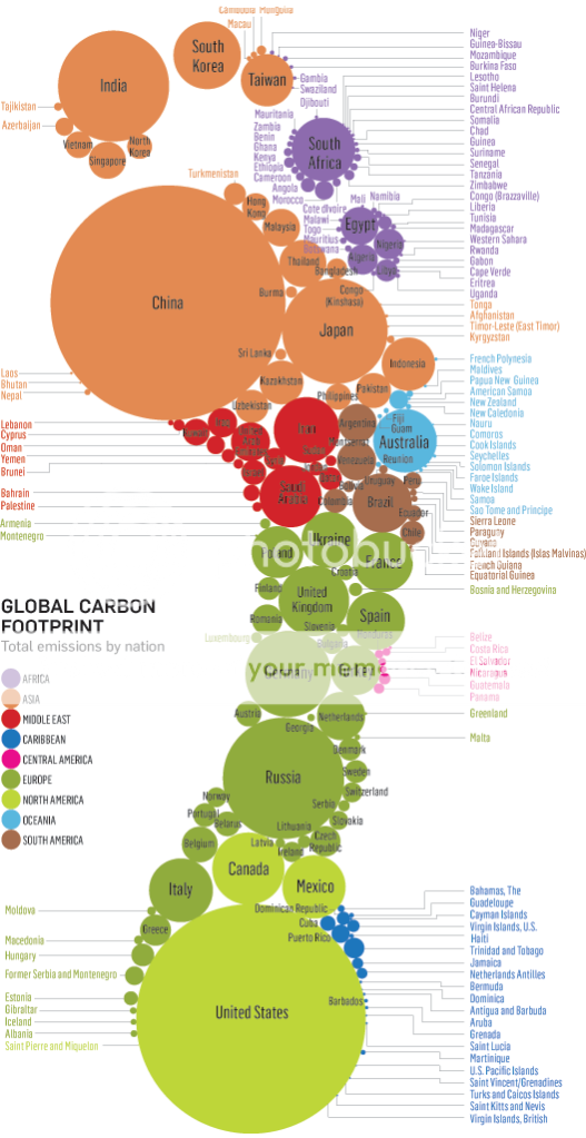

    When you look at this, it offers hope
    http://i839.photobucket.com/albums/zz315/dsatco/footprint1.png

    Hello Dylan, I'm sorry but you  have missed the point of ICF altogether - there is no attempt to hold a fusion plasma together for even mS. Each tiny bead is fired by a new laser burst - stability is neither attemped or required. The inertial containment is the mass of the material in the bead (way less than 1gm).  Every bead explodes, it just can't implode. The idea is quite a lot different from the attempts ot constrain a plasma by huge magentic fields.
    The downside (as I see it with limited knowledge) is that it is a discontinuous process and that the energy comes out in bursts of very high energy neutrons and must be collected by a molten lithium surround. But some of the neutrons will get out through the holes for the beads and lasers to enter etc etc. so the engineering to get the whole thing to work is far from trivial.
