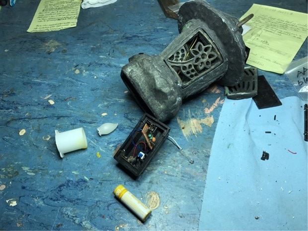

I have tried to repair a solar flickering garden pagoda light.  Unlike all the other types of that device I own, this one uses one AA NiMh battery rather than two.  It’s LED needs replacing because one of its wires had broken where it entered the “glass” head.
I got some 5mm wide-angle straw hat (stubby length) yellow/amber LEDs from Lighthouse LEDs last year, but illness kept me away from the task until this week.  The replacements from Lighthouse are 2v, but I guess I’d assumed that was a maximum rating.  Unfortunately no, Lighthouse now informs me they need at least 2 volts to light up, which on reflection makes sense.  It explains why the new lamp I soldered in wouldn’t light up... I initially thought I’d ruined the lamp with solder heat, and soldered in another using multiple heat sinks.  It didn’t light either.  Then I touched leads from a fresh AA battery to a lamp fresh out of the shipping bag, and it wouldn’t light.  Ah ha moment... dumb me.  My assumption that 2v was a max, because it was the lowest voltage lamp I could find, was ill advised.  But being an LED neophyte I seem always ignorant of their technics, as numerous faulty Xmas LED strings lying comfoundingly unrepaired in a bag will attest.
I think the circuit board controls the flame-like flickering because the original lamp was a straw hat.  But just in case, I also got from Lighthouse some standard 5mm self-flicker lamps at the same time.  What I can’t figure out is how the original LED worked on a single AA battery.  Lighthouse says I shouldn’t need a resistor in the circuit, but there is a coded red-green-red-silver one on the board.  Perhaps that is to control the current coming in during midday from the solar panel?  Regardless, surely the original LED must be a 1 volt lamp?  But where can I purchase such an animal?  Lighthouse claims to not be aware of any such device.
I guess I could try adding a second AA NiMh battery to bump the unit to 3v, but the box is only big enough for one and I don’t know but what the diodes and other CB components may not play well with 3 volts, nor if the panel has enough output potential to fully charge two NiMh AAs, even if they were only 600mAh ones.

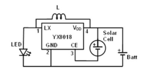

    Joel, There are not many (if any) visible spectrum LEDs that will run directly from a single AA battery. But, most of the inexpensive solar/LED devices, using a single AA battery use a device (like cx2601…

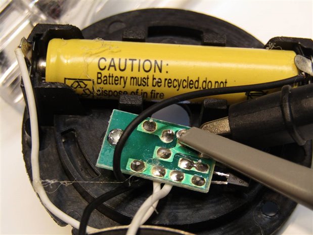

    jw0752 over 8 years ago +7 suggested
    Hi Joel, I was set up to do some experiments this evening and so I decided to take apart a cheap dollar store outside LED light and check the voltages. I knew that they operate on one 1.25 volt NiMH battery…

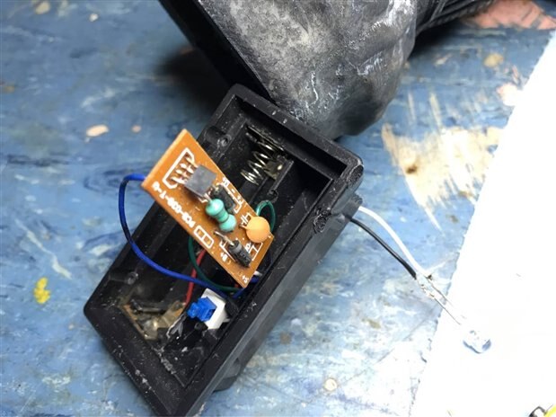

    There are not many (if any) visible spectrum LEDs that will run directly from a single AA battery.  But, most of the inexpensive solar/LED devices, using a single AA battery use a device (like cx2601) that has a voltage boost inside.  I suspect that the 'green' component, with multiple stripes is an inductor (part of the boost circuit).  I believe that if everything is working correctly, a normal LED should work fine.  There are a lot of articles on the web concerning solar/LED lamps, that could help you identify the components on your LED driver board (and battery charger).  Search on cx2601 or 'Solar LED hacks' for some interesting read (and potentially some help).

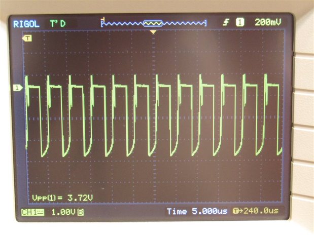

    I was set up to do some experiments this evening and so I decided to take apart a cheap dollar store outside LED light and check the voltages. I knew that they operate on one 1.25 volt NiMH battery so these LEDs have to be similar to what you are looking for. Because of how cheap they are I expected to find an LED that was running on 1.25 volts. This was not the case however. The unit contained a special 4 leaded IC YX8018 which in conjunction with the rest of the sparce components (1 inductor)  produced square wave output to the LED of 3.72 volts.
    Here is a picture of the output as read across the LED. This is more than enough voltage to light a standard LED. The pulsing also serves a secondary purpose by extending the life of the battery since power is only applied to the LED for a percentage of the time. Incidentally the image on the scope is inverted as I have the leads of the scope reverse polarity on the board due to the difficulty in getting the large ground clip into place on the negative terminal. If your LED isn't lighting there is a pretty good chance that there is a problem in the circuit.

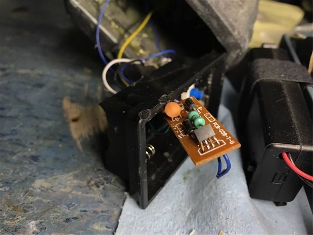

    Thanks to all who’ve responded.  The idea of an inductor that boosts voltage makes a great deal of sense.  I can see where the AA battery would not work directly, and my suspicions that the 2v rating for the LED means just that and is not a “max” is confirmed.  In my relatively simple mind I envision the inductor building voltage through resistance in a nanosecond, releasing it at 2 volts that activates the LED emission, and repeating the cycle producing the effect of the candle flicker.  The self-flickering LEDs I “just-in-case” bought shouldn’t be necessary.
    I am aware of the polarity for the LED wires and was careful to correctly solder the black and white leads to them.  My biggest inhibitor is my essential tremor.  If you don’t have that malady yet, pray that you never do.  It makes it exceedingly difficult to hold a soldering iron, solder, and wires steady enough to get a clean result anymore.  I try using normally spring-closed tweezers and other heat sink devices to hold parts together, and brace my hands on things, and when workable an alligator clip/magnifier/wand holder stand, but it’s still a frustrating challenge.  So forgive any sloppy-appearing workmanship in the pix.
    It would appear that the green device I thought was just a plain but large resistor is more so the inductor “coil”.  Although it does have continuity across it, perhaps it’s not working to boost the voltage as intended.  Or as you’ve suggested, one of the other components is faulty.  There’s only 2 diodes, a 4-pronged transistor (I think), and whatever the flat round brown component is.  The diodes have continuity in one direction okay, so I reckon it could be the transistor, which if what I’ve read is correct may be involved in the boost function?  I’ll also use my Optivisor headband magnifier to more closely examine the board for a micro-cracked or slopped solder point.
    As per Gene’s idea and cx2601 reference, I checked this article:  1.5 VOLT WHITE AND UV LED DRIVE CIRCUIT   .

    Okay, I always thought a capacitor was barrel shaped.  Apparently the brown disk shaped component I referred to in a paragraph above is known as a disc capacitor.  I see them in most circuit boards, but didn’t know what they were.  I’ve known “barrel” capacitors to fail, so why not this disk version, esp. if it’s supposed to store the built up voltage, and isn’t.

    Disk capacitors are generally ceramic type, owing to its material nature, it's almost like a solid layer of ceramic with conductive metal layer deposited on the ceramic dielectric to form the capacitor. The assembly is then dipped in some protective paint/coating. It's a simple construction that lends itself to fairly reliable low-capacitance value capacitors, although if moisture gets in, the conductive metal layers could (in theory) oxidise and stop acting properly as an electrode, with consequent reduction in capacitance value.
    The round "barrel" type is likely to be an aluminium electrolytic capacitor. These are generally much larger value capacitors formed by "rolling up" electrodes soaked in electrolyte, insulated with plastic film. This assembly has much larger area resulting in higher capacitance, which is then shoved into a metal can with a sealing rubber bung from which your two terminals protrude (for the radial type, anyhow). These capacitors typically get used in power supplies and often fail because of a number of reasons - namely that they deal with high amounts of ripple in power supplies (a stressful application), that they (like every non-ideal capacitor) have an equivalent series resistance (ESR), that the ripple current through the ESR causes the capacitor to heat up, and that the electrolytic capacitors are sensitive to heat as this causes the rate of evaporation of the electrolyte to increase which also increases the ESR (which forms a runaway feedback loop) to my knowledge. As a result, these capacitors often "cook" and blow their vents (low-quality electrolyte formulation doesn't help) or they end up drying out (sometimes due to poor seals around the rubber bung) which reduces their capacitance to non-useful levels.

    Except for my sloppy soldering where the black wires attach to the board, I can’t see where anything grounds across, nor do I note a microcrack at a connection, an issue I’ve found on a Microwave oven board and a TV converter box.  I may try to redo that power point solder job on a day my tremor is diminished.
    By the way, I did a little looking and verified the device I thought was a resistor is indeed an inductor as you fellows said.  Hidden under it on the board is the wave symbol for inductors... it includes an “L”, but my electronics books don’t indicate what that means.  There’s many forms of it, but I’m guessing it’s maybe a ferrite coated radial choke inductor.  It’s bands are perhaps not red-green-red-silver, but rather brown-green-brown-silver, which I take to be 10% tolerance 150 uH, although the sites selling them didn’t say what uH stood for.
    One questionable status is the transistor... on close examination there’s rust on its pins.  Could this be indicative that it’s the culprit rather than the inductor?
