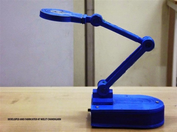

    you can use a buck converter chips for a simple solution  they are highly efficient as compared to the resistive drop circuit moreover they can be more versatile if tomorrow u decide to have more current for your led.  I would also like to suggest you that you should go for a constant current circuit  as that would have an added advantage. I made one which had the same specs. You can have my stl files if you would like to try it. they are on my blog. CREATIV[E]NGINE: 3D PRINTERS : HOW THE TECH WORKS AND MY PERSONAL EXPERIENCE WITH 3D PRINTING.
    although i havent expalned about the constant current circuit on my blog you can follow the folllowing instructables High Power LED Driver Circuits : Constant current source tweaks: #2 and #3
