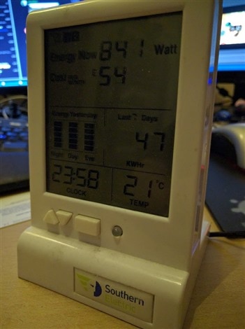

So I have one of these electricity monitors:
That my electric provider gave me, turns out they're really common, except I'm having a hard time determining how to get data out of it. You see, there's an RJ45 socket on the underside of it, which it turns out, dumps serial, but I cannot discover an authoritative answer on its pinout, though it turns out there are cables you can buy that're 'pre-made' for this, apparently it's also 3v3 logic. I decided to make my own:

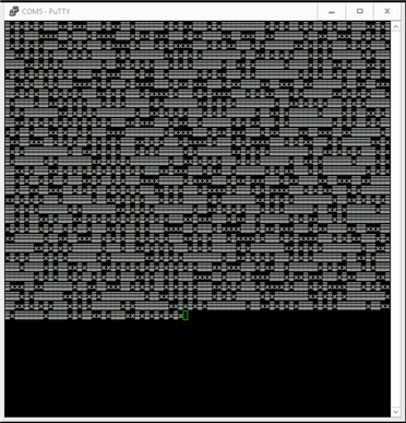

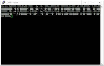

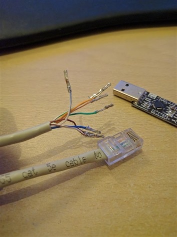

Part one of my troubles is, how do I work out the correct pinout? Admittedly I am a novice when it comes to using oscilloscopes (and they're too high priced for my tastes) so what's a safe hack-ey way I can go about this? (the USB device in the pic' happens to be a UART type device which usefully has pins on it).

  • cstanton
    cstanton over 9 years ago in reply to shabaz +2
    9600 baud? No, that doesn't seem it.. 1200 baud? Hmm, not there yet! 2400 baud? Hello data! Looks like the pin-out is correct after all. <msg><date><dsb>01343</dsb><hr>22</hr><min>53</min><sec>22</sec…

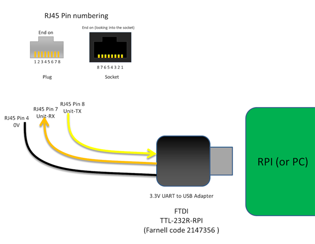

    shabaz over 9 years ago
    Hi Christopher,
    Interesting project. If the unit autonomously dumps data every second, then perhaps just the TX output from the unit is needed, and not the RX, so if you had a USB-UART adapter then you could probe with the USB-UART-RX input line only, until you saw data on the terminal window.
    According to that link however it sounds like pin 8 is the one that will be outputting from the unit.
    I think this arrangement might work, but I'm not sure since I'm just basing it on that thread : ( :
    Not that I like recommending FTDI parts : ) but it might be quickest to use that one since it is designed for 3.3V logic levels.  I'm designing a USB UART mini project here 5V UARTs on SBCs?   , maybe you might want to swap some day : )
    [EDIT: oh, just noticed you already have a USB UART. That is fine since it is 3.3V too.].

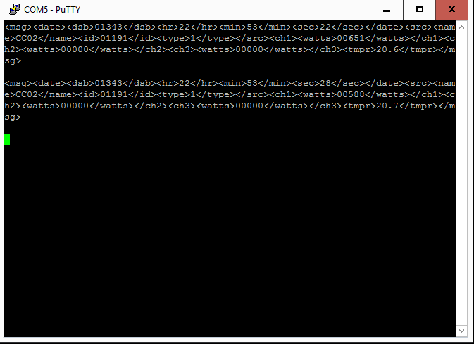

  • cstanton
    9600 baud?
    1200 baud?
    Hmm, not there yet!
    2400 baud?

    <msg><date><dsb>01343</dsb><hr>22</hr><min>59</min><sec>49</sec></date><src><name>CC02</name><id>01191</id><type>1</type></src><ch1><watts>00593</watts></ch1><ch2><watts>00000</watts></ch2><ch3><watts>00000</watts></ch3><tmpr>20.7</tmpr></msg>
    <msg><date><dsb>01343</dsb><hr>22</hr><min>59</min><sec>55</sec></date><src><name>CC02</name><id>01191</id><type>1</type></src><ch1><watts>00605</watts></ch1><ch2><watts>00000</watts></ch2><ch3><watts>00000</watts></ch3><tmpr>20.8</tmpr></msg>
    <msg><date><dsb>01343</dsb><hr>23</hr><min>00</min><sec>01</sec></date><src><name>CC02</name><id>01191</id><type>1</type></src><ch1><watts>00596</watts></ch1><ch2><watts>00000</watts></ch2><ch3><watts>00000</watts></ch3><tmpr>20.8</tmpr></msg>
    <msg><date><dsb>01343</dsb><hr>23</hr><min>00</min><sec>07</sec></date><src><name>CC02</name><id>01191</id><type>1</type></src><ch1><watts>00586</watts></ch1><ch2><watts>00000</watts></ch2><ch3><watts>00000</watts></ch3><tmpr>20.8</tmpr></msg>
    <msg><date><dsb>01343</dsb><hr>23</hr><min>00</min><sec>13</sec></date><src><name>CC02</name><id>01191</id><type>1</type></src><ch1><watts>00585</watts></ch1><ch2><watts>00000</watts></ch2><ch3><watts>00000</watts></ch3><tmpr>20.7</tmpr></msg>
    <msg><date><dsb>01343</dsb><hr>23</hr><min>00</min><sec>19</sec></date><src><name>CC02</name><id>01191</id><type>1</type></src><ch1><watts>00584</watts></ch1><ch2><watts>00000</watts></ch2><ch3><watts>00000</watts></ch3><tmpr>20.7</tmpr></msg>
    <msg><date><dsb>01343</dsb><hr>23</hr><min>00</min><sec>25</sec></date><src><name>CC02</name><id>01191</id><type>1</type></src><ch1><watts>00582</watts></ch1><ch2><watts>00000</watts></ch2><ch3><watts>00000</watts></ch3><tmpr>20.8</tmpr></msg>
    <msg><date><dsb>01343</dsb><hr>23</hr><min>00</min><sec>31</sec></date><src><name>CC02</name><id>01191</id><type>1</type></src><ch1><watts>00584</watts></ch1><ch2><watts>00000</watts></ch2><ch3><watts>00000</watts></ch3><tmpr>20.7</tmpr></msg>
    <msg><date><dsb>01343</dsb><hr>23</hr><min>00</min><sec>37</sec></date><src><name>CC02</name><id>01191</id><type>1</type></src><ch1><watts>00583</watts></ch1><ch2><watts>00000</watts></ch2><ch3><watts>00000</watts></ch3><tmpr>20.7</tmpr></msg>
    <msg><date><dsb>01343</dsb><hr>23</hr><min>00</min><sec>43</sec></date><src><name>CC02</name><id>01191</id><type>1</type></src><ch1><watts>00591</watts></ch1><ch2><watts>00000</watts></ch2><ch3><watts>00000</watts></ch3><tmpr>20.7</tmpr></msg>
    <msg><date><dsb>01343</dsb><hr>23</hr><min>00</min><sec>49</sec></date><src><name>CC02</name><id>01191</id><type>1</type></src><ch1><watts>00589</watts></ch1><ch2><watts>00000</watts></ch2><ch3><watts>00000</watts></ch3><tmpr>20.7</tmpr></msg>
    <msg><date><dsb>01343</dsb><hr>23</hr><min>00</min><sec>55</sec></date><src><name>CC02</name><id>01191</id><type>1</type></src><ch1><watts>00591</watts></ch1><ch2><watts>00000</watts></ch2><ch3><watts>00000</watts></ch3><tmpr>20.7</tmpr></msg>
    <msg><date><dsb>01343</dsb><hr>23</hr><min>01</min><sec>01</sec></date><src><name>CC02</name><id>01191</id><type>1</type></src><ch1><watts>00602</watts></ch1><ch2><watts>00000</watts></ch2><ch3><watts>00000</watts></ch3><tmpr>20.7</tmpr></msg>
    <msg><date><dsb>01343</dsb><hr>23</hr><min>01</min><sec>07</sec></date><src><name>CC02</name><id>01191</id><type>1</type></src><ch1><watts>00622</watts></ch1><ch2><watts>00000</watts></ch2><ch3><watts>00000</watts></ch3><tmpr>20.7</tmpr></msg>
    <msg><date><dsb>01343</dsb><hr>23</hr><min>01</min><sec>13</sec></date><src><name>CC02</name><id>01191</id><type>1</type></src><ch1><watts>00615</watts></ch1><ch2><watts>00000</watts></ch2><ch3><watts>00000</watts></ch3><tmpr>20.8</tmpr></msg>
    <msg><date><dsb>01343</dsb><hr>23</hr><min>01</min><sec>19</sec></date><src><name>CC02</name><id>01191</id><type>1</type></src><ch1><watts>00635</watts></ch1><ch2><watts>00000</watts></ch2><ch3><watts>00000</watts></ch3><tmpr>20.7</tmpr></msg>
    <msg><date><dsb>01343</dsb><hr>23</hr><min>01</min><sec>25</sec></date><src><name>CC02</name><id>01191</id><type>1</type></src><ch1><watts>00582</watts></ch1><ch2><watts>00000</watts></ch2><ch3><watts>00000</watts></ch3><tmpr>20.8</tmpr></msg>
    <msg><date><dsb>01343</dsb><hr>23</hr><min>01</min><sec>31</sec></date><src><name>CC02</name><id>01191</id><type>1</type></src><ch1><watts>00588</watts></ch1><ch2><watts>00000</watts></ch2><ch3><watts>00000</watts></ch3><tmpr>20.7</tmpr></msg>
    <msg><date><dsb>01343</dsb><hr>23</hr><min>01</min><sec>38</sec></date><src><name>CC02</name><id>01191</id><type>1</type></src><ch1><watts>00585</watts></ch1><ch2><watts>00000</watts></ch2><ch3><watts>00000</watts></ch3><tmpr>20.7</tmpr></msg>
    <msg><date><dsb>01343</dsb><hr>23</hr><min>01</min><sec>44</sec></date><src><name>CC02</name><id>01191</id><type>1</type></src><ch1><watts>00593</watts></ch1><ch2><watts>00000</watts></ch2><ch3><watts>00000</watts></ch3><tmpr>20.7</tmpr></msg>
    <msg><date><dsb>01343</dsb><hr>23</hr><min>01</min><sec>50</sec></date><src><name>CC02</name><id>01191</id><type>1</type></src><ch1><watts>00611</watts></ch1><ch2><watts>00000</watts></ch2><ch3><watts>00000</watts></ch3><tmpr>20.7</tmpr></msg>
    <msg><date><dsb>01343</dsb><hr>23</hr><min>02</min><sec>02</sec></date><src><name>CC02</name><id>01191</id><type>1</type></src><ch1><watts>00599</watts></ch1><ch2><watts>00000</watts></ch2><ch3><watts>00000</watts></ch3><tmpr>20.8</tmpr></msg>
    <msg><date><dsb>01343</dsb><hr>23</hr><min>02</min><sec>08</sec></date><src><name>CC02</name><id>01191</id><type>1</type></src><ch1><watts>00667</watts></ch1><ch2><watts>00000</watts></ch2><ch3><watts>00000</watts></ch3><tmpr>20.7</tmpr></msg>
    <msg><date><dsb>01343</dsb><hr>23</hr><min>02</min><sec>13</sec></date><src><name>CC02</name><id>01191</id><type>1</type></src><ch1><watts>00593</watts></ch1><ch2><watts>00000</watts></ch2><ch3><watts>00000</watts></ch3><tmpr>20.7</tmpr></msg>
    <msg><date><dsb>01343</dsb><hr>23</hr><min>02</min><sec>20</sec></date><src><name>CC02</name><id>01191</id><type>1</type></src><ch1><watts>00588</watts></ch1><ch2><watts>00000</watts></ch2><ch3><watts>00000</watts></ch3><tmpr>20.8</tmpr></msg>
    <msg><date><dsb>01343</dsb><hr>23</hr><min>02</min><sec>25</sec></date><src><name>CC02</name><id>01191</id><type>1</type></src><ch1><watts>00589</watts></ch1><ch2><watts>00000</watts></ch2><ch3><watts>00000</watts></ch3><tmpr>20.8</tmpr></msg>
    <msg><date><dsb>01343</dsb><hr>23</hr><min>02</min><sec>32</sec></date><src><name>CC02</name><id>01191</id><type>1</type></src><ch1><watts>00650</watts></ch1><ch2><watts>00000</watts></ch2><ch3><watts>00000</watts></ch3><tmpr>20.7</tmpr></msg>
    <msg><date><dsb>01343</dsb><hr>23</hr><min>02</min><sec>37</sec></date><src><name>CC02</name><id>01191</id><type>1</type></src><ch1><watts>00586</watts></ch1><ch2><watts>00000</watts></ch2><ch3><watts>00000</watts></ch3><tmpr>20.8</tmpr></msg>
    <msg><date><dsb>01343</dsb><hr>23</hr><min>02</min><sec>44</sec></date><src><name>CC02</name><id>01191</id><type>1</type></src><ch1><watts>00593</watts></ch1><ch2><watts>00000</watts></ch2><ch3><watts>00000</watts></ch3><tmpr>20.8</tmpr></msg>
    <msg><date><dsb>01343</dsb><hr>23</hr><min>02</min><sec>50</sec></date><src><name>CC02</name><id>01191</id><type>1</type></src><ch1><watts>00589</watts></ch1><ch2><watts>00000</watts></ch2><ch3><watts>00000</watts></ch3><tmpr>20.7</tmpr></msg>
    <msg><date><dsb>01343</dsb><hr>23</hr><min>02</min><sec>56</sec></date><src><name>CC02</name><id>01191</id><type>1</type></src><ch1><watts>00640</watts></ch1><ch2><watts>00000</watts></ch2><ch3><watts>00000</watts></ch3><tmpr>20.8</tmpr></msg>
    <msg><date><dsb>01343</dsb><hr>23</hr><min>03</min><sec>08</sec></date><src><name>CC02</name><id>01191</id><type>1</type></src><ch1><watts>00634</watts></ch1><ch2><watts>00000</watts></ch2><ch3><watts>00000</watts></ch3><tmpr>20.8</tmpr></msg>
    <msg><date><dsb>01343</dsb><hr>23</hr><min>03</min><sec>13</sec></date><src><name>CC02</name><id>01191</id><type>1</type></src><ch1><watts>00589</watts></ch1><ch2><watts>00000</watts></ch2><ch3><watts>00000</watts></ch3><tmpr>20.8</tmpr></msg>
    <msg><date><dsb>01343</dsb><hr>23</hr><min>03</min><sec>20</sec></date><src><name>CC02</name><id>01191</id><type>1</type></src><ch1><watts>00710</watts></ch1><ch2><watts>00000</watts></ch2><ch3><watts>00000</watts></ch3><tmpr>20.8</tmpr></msg>
    <msg><date><dsb>01343</dsb><hr>23</hr><min>03</min><sec>25</sec></date><src><name>CC02</name><id>01191</id><type>1</type></src><ch1><watts>00619</watts></ch1><ch2><watts>00000</watts></ch2><ch3><watts>00000</watts></ch3><tmpr>20.8</tmpr></msg>
    <msg><date><dsb>01343</dsb><hr>23</hr><min>03</min><sec>31</sec></date><src><name>CC02</name><id>01191</id><type>1</type></src><ch1><watts>00589</watts></ch1><ch2><watts>00000</watts></ch2><ch3><watts>00000</watts></ch3><tmpr>20.8</tmpr></msg>
    <msg><date><dsb>01343</dsb><hr>23</hr><min>03</min><sec>37</sec></date><src><name>CC02</name><id>01191</id><type>1</type></src><ch1><watts>00592</watts></ch1><ch2><watts>00000</watts></ch2><ch3><watts>00000</watts></ch3><tmpr>20.8</tmpr></msg>
    <msg><date><dsb>01343</dsb><hr>23</hr><min>03</min><sec>43</sec></date><src><name>CC02</name><id>01191</id><type>1</type></src><ch1><watts>00604</watts></ch1><ch2><watts>00000</watts></ch2><ch3><watts>00000</watts></ch3><tmpr>20.8</tmpr></msg>
    <msg><date><dsb>01343</dsb><hr>23</hr><min>03</min><sec>49</sec></date><src><name>CC02</name><id>01191</id><type>1</type></src><ch1><watts>00611</watts></ch1><ch2><watts>00000</watts></ch2><ch3><watts>00000</watts></ch3><tmpr>20.8</tmpr></msg>
    <msg><date><dsb>01343</dsb><hr>23</hr><min>03</min><sec>55</sec></date><src><name>CC02</name><id>01191</id><type>1</type></src><ch1><watts>00624</watts></ch1><ch2><watts>00000</watts></ch2><ch3><watts>00000</watts></ch3><tmpr>20.8</tmpr></msg>
    <msg><date><dsb>01343</dsb><hr>23</hr><min>04</min><sec>07</sec></date><src><name>CC02</name><id>01191</id><type>1</type></src><ch1><watts>00589</watts></ch1><ch2><watts>00000</watts></ch2><ch3><watts>00000</watts></ch3><tmpr>20.8</tmpr></msg>
    <msg><date><dsb>01343</dsb><hr>23</hr><min>04</min><sec>14</sec></date><src><name>CC02</name><id>01191</id><type>1</type></src><ch1><watts>00598</watts></ch1><ch2><watts>00000</watts></ch2><ch3><watts>00000</watts></ch3><tmpr>20.8</tmpr></msg>
    <msg><date><dsb>01343</dsb><hr>23</hr><min>04</min><sec>20</sec></date><src><name>CC02</name><id>01191</id><type>1</type></src><ch1><watts>00609</watts></ch1><ch2><watts>00000</watts></ch2><ch3><watts>00000</watts></ch3><tmpr>20.8</tmpr></msg>
    <msg><date><dsb>01343</dsb><hr>23</hr><min>04</min><sec>26</sec></date><src><name>CC02</name><id>01191</id><type>1</type></src><ch1><watts>00620</watts></ch1><ch2><watts>00000</watts></ch2><ch3><watts>00000</watts></ch3><tmpr>20.8</tmpr></msg>
    <msg><date><dsb>01343</dsb><hr>23</hr><min>04</min><sec>32</sec></date><src><name>CC02</name><id>01191</id><type>1</type></src><ch1><watts>00625</watts></ch1><ch2><watts>00000</watts></ch2><ch3><watts>00000</watts></ch3><tmpr>20.8</tmpr></msg>
    <msg><date><dsb>01343</dsb><hr>23</hr><min>04</min><sec>38</sec></date><src><name>CC02</name><id>01191</id><type>1</type></src><ch1><watts>00611</watts></ch1><ch2><watts>00000</watts></ch2><ch3><watts>00000</watts></ch3><tmpr>20.8</tmpr></msg>
    <msg><date><dsb>01343</dsb><hr>23</hr><min>04</min><sec>44</sec></date><src><name>CC02</name><id>01191</id><type>1</type></src><ch1><watts>00590</watts></ch1><ch2><watts>00000</watts></ch2><ch3><watts>00000</watts></ch3><tmpr>20.8</tmpr></msg>
    <msg><date><dsb>01343</dsb><hr>23</hr><min>04</min><sec>50</sec></date><src><name>CC02</name><id>01191</id><type>1</type></src><ch1><watts>00604</watts></ch1><ch2><watts>00000</watts></ch2><ch3><watts>00000</watts></ch3><tmpr>20.8</tmpr></msg>
    <msg><date><dsb>01343</dsb><hr>23</hr><min>04</min><sec>56</sec></date><src><name>CC02</name><id>01191</id><type>1</type></src><ch1><watts>00609</watts></ch1><ch2><watts>00000</watts></ch2><ch3><watts>00000</watts></ch3><tmpr>20.8</tmpr></msg>
    <msg><date><dsb>01343</dsb><hr>23</hr><min>05</min><sec>08</sec></date><src><name>CC02</name><id>01191</id><type>1</type></src><ch1><watts>00608</watts></ch1><ch2><watts>00000</watts></ch2><ch3><watts>00000</watts></ch3><tmpr>20.8</tmpr></msg>
    <msg><date><dsb>01343</dsb><hr>23</hr><min>05</min><sec>14</sec></date><src><name>CC02</name><id>01191</id><type>1</type></src><ch1><watts>00595</watts></ch1><ch2><watts>00000</watts></ch2><ch3><watts>00000</watts></ch3><tmpr>20.8</tmpr></msg>
    <msg><date><dsb>01343</dsb><hr>23</hr><min>05</min><sec>20</sec></date><src><name>CC02</name><id>01191</id><type>1</type></src><ch1><watts>00607</watts></ch1><ch2><watts>00000</watts></ch2><ch3><watts>00000</watts></ch3><tmpr>20.8</tmpr></msg>
    <msg><date><dsb>01343</dsb><hr>23</hr><min>05</min><sec>27</sec></date><src><name>CC02</name><id>01191</id><type>1</type></src><ch1><watts>00613</watts></ch1><ch2><watts>00000</watts></ch2><ch3><watts>00000</watts></ch3><tmpr>20.8</tmpr></msg>
    <msg><date><dsb>01343</dsb><hr>23</hr><min>05</min><sec>33</sec></date><src><name>CC02</name><id>01191</id><type>1</type></src><ch1><watts>00616</watts></ch1><ch2><watts>00000</watts></ch2><ch3><watts>00000</watts></ch3><tmpr>20.8</tmpr></msg>
    <msg><date><dsb>01343</dsb><hr>23</hr><min>05</min><sec>38</sec></date><src><name>CC02</name><id>01191</id><type>1</type></src><ch1><watts>00593</watts></ch1><ch2><watts>00000</watts></ch2><ch3><watts>00000</watts></ch3><tmpr>20.8</tmpr></msg>
    <msg><date><dsb>01343</dsb><hr>23</hr><min>05</min><sec>45</sec></date><src><name>CC02</name><id>01191</id><type>1</type></src><ch1><watts>00630</watts></ch1><ch2><watts>00000</watts></ch2><ch3><watts>00000</watts></ch3><tmpr>20.8</tmpr></msg>
    <msg><date><dsb>01343</dsb><hr>23</hr><min>05</min><sec>51</sec></date><src><name>CC02</name><id>01191</id><type>1</type></src><ch1><watts>00593</watts></ch1><ch2><watts>00000</watts></ch2><ch3><watts>00000</watts></ch3><tmpr>20.8</tmpr></msg>
    <msg><date><dsb>01343</dsb><hr>23</hr><min>05</min><sec>57</sec></date><src><name>CC02</name><id>01191</id><type>1</type></src><ch1><watts>00606</watts></ch1><ch2><watts>00000</watts></ch2><ch3><watts>00000</watts></ch3><tmpr>20.8</tmpr></msg>
    <msg><date><dsb>01343</dsb><hr>23</hr><min>06</min><sec>02</sec></date><src><name>CC02</name><id>01191</id><type>1</type></src><ch1><watts>00588</watts></ch1><ch2><watts>00000</watts></ch2><ch3><watts>00000</watts></ch3><tmpr>20.8</tmpr></msg>
    <msg><date><dsb>01343</dsb><hr>23</hr><min>06</min><sec>08</sec></date><src><name>CC02</name><id>01191</id><type>1</type></src><ch1><watts>00585</watts></ch1><ch2><watts>00000</watts></ch2><ch3><watts>00000</watts></ch3><tmpr>20.8</tmpr></msg>
    <msg><date><dsb>01343</dsb><hr>23</hr><min>06</min><sec>14</sec></date><src><name>CC02</name><id>01191</id><type>1</type></src><ch1><watts>00586</watts></ch1><ch2><watts>00000</watts></ch2><ch3><watts>00000</watts></ch3><tmpr>20.8</tmpr></msg>
    <msg><date><dsb>01343</dsb><hr>23</hr><min>06</min><sec>20</sec></date><src><name>CC02</name><id>01191</id><type>1</type></src><ch1><watts>00595</watts></ch1><ch2><watts>00000</watts></ch2><ch3><watts>00000</watts></ch3><tmpr>20.8</tmpr></msg>
    <msg><date><dsb>01343</dsb><hr>23</hr><min>06</min><sec>26</sec></date><src><name>CC02</name><id>01191</id><type>1</type></src><ch1><watts>00585</watts></ch1><ch2><watts>00000</watts></ch2><ch3><watts>00000</watts></ch3><tmpr>20.8</tmpr></msg>
    <msg><date><dsb>01343</dsb><hr>23</hr><min>06</min><sec>32</sec></date><src><name>CC02</name><id>01191</id><type>1</type></src><ch1><watts>00579</watts></ch1><ch2><watts>00000</watts></ch2><ch3><watts>00000</watts></ch3><tmpr>20.8</tmpr></msg>
    <msg><date><dsb>01343</dsb><hr>23</hr><min>06</min><sec>38</sec></date><src><name>CC02</name><id>01191</id><type>1</type></src><ch1><watts>00581</watts></ch1><ch2><watts>00000</watts></ch2><ch3><watts>00000</watts></ch3><tmpr>20.8</tmpr></msg>
    <msg><date><dsb>01343</dsb><hr>23</hr><min>06</min><sec>45</sec></date><src><name>CC02</name><id>01191</id><type>1</type></src><ch1><watts>00579</watts></ch1><ch2><watts>00000</watts></ch2><ch3><watts>00000</watts></ch3><tmpr>20.8</tmpr></msg>
    <msg><date><dsb>01343</dsb><hr>23</hr><min>06</min><sec>50</sec></date><src><name>CC02</name><id>01191</id><type>1</type></src><ch1><watts>00606</watts></ch1><ch2><watts>00000</watts></ch2><ch3><watts>00000</watts></ch3><tmpr>20.8</tmpr></msg>
    <msg><date><dsb>01343</dsb><hr>23</hr><min>06</min><sec>57</sec></date><src><name>CC02</name><id>01191</id><type>1</type></src><ch1><watts>00605</watts></ch1><ch2><watts>00000</watts></ch2><ch3><watts>00000</watts></ch3><tmpr>20.8</tmpr></msg>
    It dumps data every 5 seconds by the look of it.
