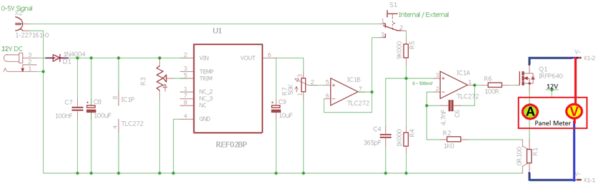

I have been slowly working through a series of projects and tutorials to share and teach how to use various components and how these can be applied to a Home / Lab power supply, DC Load and the likes.
In order to have our first complete tool, I have completed a DC Load to the above specifications and here are the schematics, and pictures in support of the build
First up the schematic
Adhering to the classic, It contains a 5V reference IC and a Dual Op-Amp, most of the schematic should be readily identifiable but I will point out a few things. The DC load will also handle input from an Arbitrary Waveform Generator (0-5V representing 0-5A) and up to about a 2 - 3 KHz square wave if you so desire. It also has a transient response time better than 100uS.
C4 (365pf) and C6 (4.7nF) are required to minimize or prevent oscillations in the control and believe me it will oscillate without C6 and quite badly, see the videos below regarding this
Here is the initial post Electronic DC Load - Design and Build to test PSU Project and a performance tuning video here:- Electronic DC Load - Performance Improvements
The schematics in those posts contained a slight error in the trimmer connection for the VREF, I had it between the supplies rather than the output and Gnd. The above schematic has this corrected.
The values of R4 and R5 are dependent on how accurate you want this to be with respect to a known input or the output of the 5V VREF. The more accurate or more correctly stated, the closer they are to a 10:1 ratio the more closely the DC load will track 0-5V to a 0-5A load.
For me in this build I ultimately went with "close enough" rather than using my precision Vishay resistors. The reason for this is I placed a panel meter on the output (After I hacked it image ) to show me volts and current, and it is only manually adjustable so 0.05% resistors would be a waste. I will be building another automated version in the future and this will be far more precise so stay tuned image

here is the schematic with the meter in place (Note the trimmer connections for the VREF are not correct in this drawing, refer to the one above for the corrections). this is just to show how the DPM is connected into the circuit, as the DPM current shunt is only 25mOhms, it has no noteable effect on the operation or the uniit under test.

    The circuit as shown uses a 5V reference or a 5V external signal to set the current, the resistor divider R4 and R5 make a divide by 10 (90% and 10%) resulting in a 0-500mV presented to the op amp (Assuming 0-5V input signal to the divider)
    In order for the op-amp to be happy it wants both inputs to be the same voltage so will drive the output in an attempt to get it.
    if we set 5V (500mV) and as we currently have a 0.1ohm R1 this will require 5Amps through R1 to develop 500mV across it and balance the op-amp
    if you change the input to the op-amp to 0-1V (0-10V on the external input) then you will get 0-10A, this will work with the external input and no changes will be needed to the circuit.
    If you want to get this with the pot then you would need to change the divider 9K to a 4K and this will provide 0-1V from this too.
    The other option is to simply use a 50 mOhm resistor for R1 and change nothing else, this will then provide 0-5V in for 0-10A out
    If you want 20A then R1 would be 25mOhms
    By keeping R1 small, you minimise the heat dissipation and therefore improve stability.
    You have to watch the power dissipation in the FET though and will probably need a very large heatsink when passing 20A and more than just a volt or two as 20* 5V is already 100 Watts, that's a lot of heat
    I also labeled the diagram incorrectly, the FET I used is an IRFP064, not an IRFP640, think 70A continuous Drain current for the 064 vs 18A of the 640 but it is limited to a max of 60V vs 200V of the 640. but the 640 is also only 125W vs the 064 being 300W

    Take  a look at the IRFP064 data sheet (I'm using the Vishay one, RevC, 14 May 20111), , fig8, Maximum Safe Operating Area and you'll see that the device can stand a single pulse 20A at 50V for 10ms and no more because the junction will get too hot even if the case is held at 25C - but if we can keep it cool you might think it would be OK for 20A and useful voltages.
    For continuous operation at 20A the problem is getting the heat out - on the data sheet the junction to case thermal resistance is given as 0.5 C/W and they suggest 0.24 between the case and the heatsink - but without any insulation - if you use insulation you'll do well to manage 0.75 C/W case to heatsink.
    Using those figures, the thermal resistance junction to heatsink is 1.25 C/W, lets assume an ambient temperature of 40C and a heatsink that can do 0.5 C/W (no point spending money on a better one if you are only using one MOSFET). The total thermal resistance junction to ambient is now 1.75 C/W, if you allow a maximum junction temperature of 160C (you should never aim to hit the specified maximum) the maximum power you can put into the MOSFET is (160 - 40)/1.75 = 68.6W.
    So although you MOSFET can handle a huge 1kW pulse it can only manage 68W continuously.
    If you want to cope with more you'll very often find that it's much cheaper to increase the number of MOSFETs rather than use an amazingly good heatsink - of course if you want really high power you need to do both.
    1 MOSFET on a 0.1C/W heatsink (160 - 40)/1.35 = 88.9W
    2 MOSFETs on 0.5 C/W heatsink = (160 - 40)/1.125 = 106.7W
    So you see you get more from an extra MOSFET than you do from a better heatsink.
    If you want to get rid of serious power, like 400W you need a junction to ambient thermal resistance of (160 - 40)/400 = 0.33 C/W, split between heatsink and MOSFETS = 0.165 C/W for the heatsink and 8 MOSFETs.  Exactly how to choose between more heatsink and more MOSFETs will depend on what bits and skills you have available. (For example you might be able to improve on the case to heatsink thermal resistance by using more exotic technology than the usual insulating pads.)
    So now we need to ask Peter if his circuit will be happy with 8 MOSFETs in parallel.

    Since you've dangled a worm in the stream, I'll bite, even though I'm just a minnow. [I don't have the kind of knowledge of these sort of areas of power electronics that you and Peter evidently do, but I'd like to learn a bit more.]
    Do you mean literally putting eight MOSFETs in parallel and then treating the combination as though it were one component, or do you mean replicating the MOSFET, sense resistor and amplifier eight times and putting those blocks in parallel?
    In the latter case, I'd expect it to work much as Peter's existing circuit, with the dynamic performance being much the same. It's a simple approach, but adds significantly to the component count.
    In the former I'd firstly worry about the spread on the Vgs thresholds (the Vishay datasheet gives a min of 2V and a max of 4V). Wouldn't there be the real danger of one or two of the devices hogging much of the current?
    But let's say that you matched the thresholds, so that the devices did share fairly evenly, you'd then have a device that would require eight times the charge into the (combined) gate over a single device [crudely, the input, instead of looking like 4nF-12nF of capacitance, would look more like 30nF-90nF) and the compensation capacitor would have to increase in order to give the same damping as the original because of the way everything has slowed down. The rise and fall times would increase (roughly by eight times) and hit the dynamic performance considerably. I don't think the circuit would be unhappy [it looks like the op-amp would manage], but the designer might be, depending on what they were trying to achieve. Things might be speeded up somewhat by allowing the op-amp to drive a bit more current into the gate and by reducing the compensation to be closer to the critically-damped case, but I suspect Peter chose the over-damped response because it gives a good margin against oscillation/ringing (which is an obvious worry if you are putting something out for people to build in an ad-hoc kind of way). On a simulation, if I reduce the compensation capacitor to the point that it's critically-damped (one overshoot), the edges start to get quite messy - Peter's response looks much cleaner because the R-C characteristic swamps everything else.
    How would you approach this, Michael, if you wanted to keep the original dynamic performance but spread the heat with eight MOSFETs?
    As a postscript, this taught me an excellent lesson when I tried simulating it. Unless you go in and start changing parameters on individual devices, the simulator gives you eight identical devices which, of course, share perfectly. So I now have another example of how easily you can go wrong if you just blindly accept what a quick, slapped-together simulation shows you.

    I'd match the MOSFETS if possible (but if you are only building one system you can't.) I'd replace the TLC072 with an op amp with more output drive capability (needs > 50mA to get reasonable slew rate into 100nF of gate load) and use a 100R gate resistor with each MOSFET. To share current you need an additional source resistor for each MOSFET, and ideally to drop 1V across each at full current (which is an additional 20W of loss but trivial in the context of out target 400W). You would need to use 0.4R resistors rated for at least 2.5W each - in fact you might do better to go up a bit on the resistors to 1R, 10W, at full power you would be putting 6.25W into each resistor (50W in total) but would get much better power sharing. The only problem is that the drop across the resistors at full current (2.5V) limits the lowest input voltage for full current.
    As ever - it's all compromises.

    Thanks Michael. As you say, compromises. Though in this case, without a tight spec, it's more design ideas or, perhaps, the voice of experience pointing us in a sensible direction.
    So the source resistors are similar to what you'd have to do paralleling up bipolar transistors, though for a different reason (in the bipolar case, to avoid thermal runaway, in this case to even-up small differences in the gate thresholds). Separate gate resistors mean that each MOSFET sees just its own gate capacitance and not the combination of all eight. And more drive from the op-amp because the existing part can only manage 10mA or so and we now need eight times the drive just to maintain the performance Peter had.
    It's interesting that once you've done all that, there's almost a case for simply replicating the control circuit eight times (especially since the op-amps are available in a quad version).
    Next step for me with the simulator, I think, is to look at driving the MOSFETs harder and faster to improve the dynamic performance. Whilst Peter's circuit is good for many applications, with modern switching regulators operating at ever higher frequencies, sometimes up to 1 or 2 MHz, we'd be in a situation where the regulator would be testing the test equipment rather than the other way round. (I can see that for a real-world test you'd just switch load resistors into circuit rather than attempt to get a control loop working fast enough, but it's an interesting design problem for me to have a go at.)

    I've had very bad experience attempting to parallel op amps - the voltage gain and offsets can vary significantly so you end up with a load of new sharing problems.
    There is an interesting Linear Technology article on the web about making a high current fast electronic load - the stray inductance is a  big potential problem.
