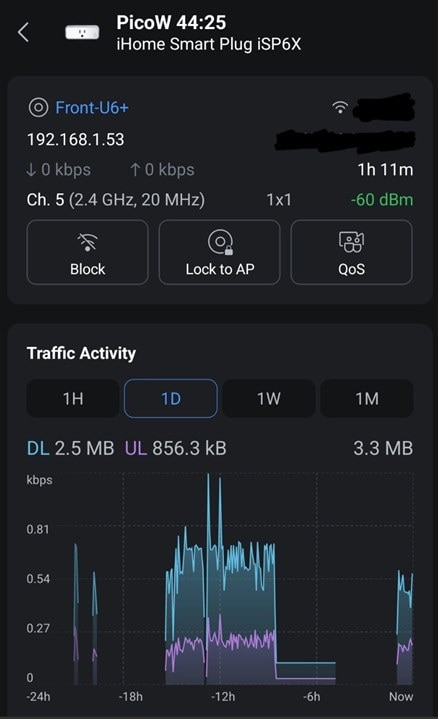

    With the code as it stands now, since it's connected to the network, I've still got the opportunity install sensors and actuators anywhere for an end result like any other existing system may be able to do, (could also interface to off-the-shelf battery-powered LoRaWAN sensors or actuators since I have a gateway at home), but I would struggle to tune it all, and would still never be optimal for the reasons mentioned by you and Andrew.
    What I'm curious about, is what if I could express my issues in plain language (rather than express them with algorithms and temperature and timer settings with traditional controllers) and provide my problem list, along with any API- and sensor-derived data to an LLM, and let it generate a set of instructions for the boiler and any actuators. I think it would be easy to compare the duty cycle with a simpler non-AI decision (like I have now) and allow AI to override if it's not an extreme discrepancy. I quite like the idea of getting the controller to whinge on my behalf to the LLM, rather than people having to hear me always complain about how much the manufacturer control system sucks.. Anyway, it's just an idea, but theoretically not too difficult to primitively prototype up.
    One thing I really like currently in the code (and was unintentional), is that the PWM period happens to be sync'd to real time. Simply because it was easier to code that way, whereas traditional controllers would not sync that with real time. It means I can look at the time, and know that on the hour, or on the half-hour (or say at 0/15/30/45 min, or 0/20/40 min positions on the clock dial, if I configure it like that), the heating will definitely kick in depending on temperature. It's actually quite reassuring knowing if I'm feeling a little cold, when the boiler is very likely to turn on by just looking at my watch.. saves turning the boiler on/off manually to override things unless essential, in which case it's time to tweak the algorithm I guess.
    The sync is occurring because I grab the time from an API (and free-run if there is an API failure, until it can later reconnect), and happen to use the minutes value in the PWM function.
    All this is just an experiment of course, I don't know how long I will run this versus trying something off-the-shelf one day, but it's for sure made me re-appreciate what a hard challenge it is to make people feel right and not overly cold or hot. I've also been experimenting with how to provide more feedback: as well as knowing by clock time when the boiler is likely to kick in, I'm pulsing the LED in a few ways to provide reassurance from a distance that the system is indeed healthy and running and not crashed : ) and whether the boiler is off or on, all from a single LED so one doesn't need to get up and look closely at a panel. I should also try to send logs or stats, but probably want to do that in some standard manner, rather than reinvent the wheel. Maybe SNMP. Currently I can look at my ubiquiti mobile app, to see network activity, so I know the device is healthy and the API's are working well. It's intermittent in the screenshot below, because I was taking it offline for some experimentation. The "iHome Smart Plug" description is meaningless, it's just an incorrect device name assumption by the app.
