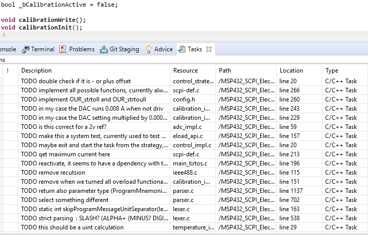

First go at compiling the software
Since I last did anything with this, TI have moved CCS (Code Composer Studio) on to version 8. So first job was to
install that.
Then I used the resource manager to download and install the SDK for the MSP432 parts. As well as routines for
peripherals, etc, that also includes TI's RTOS.
simplelink_msp432e4_sdk_2_20_00_20
Next thing was to download Jan's zip file, with the software project in it, and unzip it to a folder under the CCS
workspace directory.
Then I imported the project to CCS and tried to compile it. It failed as it couldn't find the RTOS bits it needed.
"Referenced project 'tirtos_builds_MSP_EXP432E401Y_release_ccs' does not exist in the workspace. Project
'MSP432_SCPI_ElectronicLoad' may not build as expected."
To get round that I imported the example project tirtos_builds_MSP_EXP432E401Y_release_css from the examples with
the SDK and compiled it. Having that in place got me past the error about the rtos components, but I now have the
error message:
"Buildfile generation error occurred..
Build-configuration 'com.ti.ccstudio.buildDefinitions.MSP432.Debug.482273457' does not exist in the referenced
project 'tirtos_builds_MSP_EXP432E401Y_release_ccs'. See 'Properties > Build > Dependencies' page to select an
existing build-configuration.
Build stopped.."
Some Progress
I got past that by selecting 'Show Build Settings...' on the Project menu, selecting 'Build', and then changing the
odd looking dependency that it couldn't find to 'Debug' from the drop-down menu that appears when you try to edit it.
Now it compiles ok (so I'm further on than I was before with the black board).

    side note: you see // todo comments in the code.
    In CCS (and other Eclipse IDE's) there is a TASK window that lists the lines with this comment. That's how I track incomplete or non-optimal code.
    Thanks for that tip - I have been using CCS / Eclipse for a while and was completely unaware
