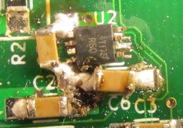

This is how the ADC/DAC board currently looks. Last year, when I first built it, the 2.048V voltage reference chip was on back-order so I improvised a temporary replacement with a LT1009 (a 2.5V part) that I had so that I could try the board even if the voltages would be wrong. I now have the proper device for U2, so the next job is to remove the temporary parts and see if I can manage to solder it to the board.
Replacing the Reference
I took off the temporary reference. Now I'm faced with this
At first I thought Farnell had sold me the wrong part, but the code on the top of the package does match what it says in the datasheet, so I guess I need to adapt the package to fit the footprint. Luckily we're only using three of the pins, so I can bend the others out of the way. Maybe.
This is now appears to be a complete mess, though it's not quite as bad as it looks. The unused legs are actually pointing up at the camera rather than down at the board, so there's much more clearance around the three pins that are soldered than it looks. I now see this coming out of the reference (that's measured across the capacitor at the output of the reference) so it's quite close to 2.048V.
In the morning, when my eyes are rested, I'll clean it up a bit and then start looking at the DAC.

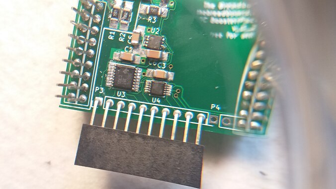

First Go at Running the DAC Board
I've now got the ADC-DAC board plugged into the back of the processor board (the LCD display is in the same position on the other side of the board).
Next step is to talk to the load so that I'm in a position to issue SCPI commands. To do that I'm using PuTTY and I've set it up in the way that Jan describes on the main load information blog. After a bit of confusion about which COM port I should be using (not unusual with Windows), I see this
that's the load responding to the 'who are you'?' command, so that means I have usable communication with the load and can start issuing instructions to Jan's software.
As a quick test, I've just tried sending test values to DAC A (known to SCPI as DAC1)
DEVE:DAC1 0   results in a voltage of 0.391mV at the output pins of the DAC-ADC board (that's the low end of our control range - ideally it would be zero)
DEVE:DAC1 #HFFFF  results in a voltage of 2.0421V (that's the high end - it's a 16-bit converter - and ideally it would be the reference voltage of 2.048V)
The only load is the meter. This isn't driving the analogue board yet.
So talking to the DAC works. That's really good progress (well done, Jan!) because I now have the minimum that I need to control the analogue part.

    ok, issue fixed. I have modded the control circuit so many times that the pcb gets a bit rough. The approach works. I have connected DAC B via a 3M3 resistor to the + of 3C. The offset of the DAC at value…
    Jan Cumps over 8 years ago +5
    (The pin 1 indicator is a line of silkscreen running down the side of the pin but it's so close it looks like it was cropped back by the board manufacturer. Yes. There are inconsistencies in how pin 1…
    Oops. Yes, the footprint I used for U2 is not good, and I placed the caps too close to U2.
    When building up my own board, I put a warning in the original blog on how to mitigate that:
    Solder advice: in hindsight I should have used larger IC packages. The board isn't easy to solder at home. But it's doable with proper care, hand stability of a snooker player and eyesight of an eagle.
    It's best to leave capacitor C5 off and solder it separately when the other components (in particular U2) are mounted. Even then it may be good to move it as far as you can from U2's pins. I didn't provide enough clearance in my PCB design.
    The VSSOP footprint of U2 is narrow on the V1_2 board. If you are brave, you can use pliers to bend the pins a bit down. I cut of the pins 5, 7 and 8 with a hobby knife.
    My result looks Meh too:
