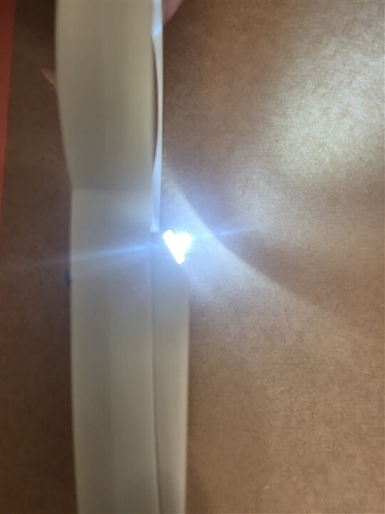

This magnifier is quite a decent size, with an approx. 50 mm diameter lens. It's aspheric, so the image quality is decent, but it's not to the same standard as the image quality from the larger diameter 3x magnifiers mentioned above (Carson Lume and Carson CrystalView). The image has some distortion in the outer 30% or so of the image, but it's not anywhere near as bad as the Coil 8277. It's very usable.
The LED illumination is quite a nasty cold white, but it gets the job done.
There is some glare from the LED, but it's not too bad.

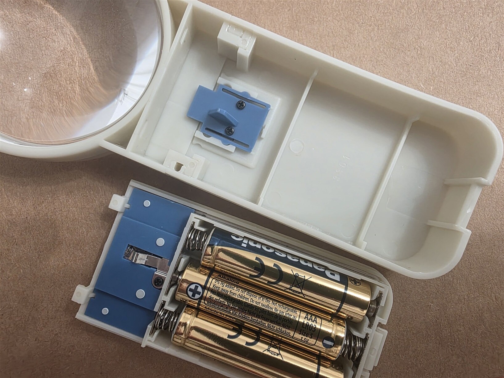

Inside, three AAA batteries are required (not supplied) and they should last a very long time since there's only one LED to light up. From experience with the physically smaller 7x version of this product, I can confirm that the slide switch will last for many years in normal use.

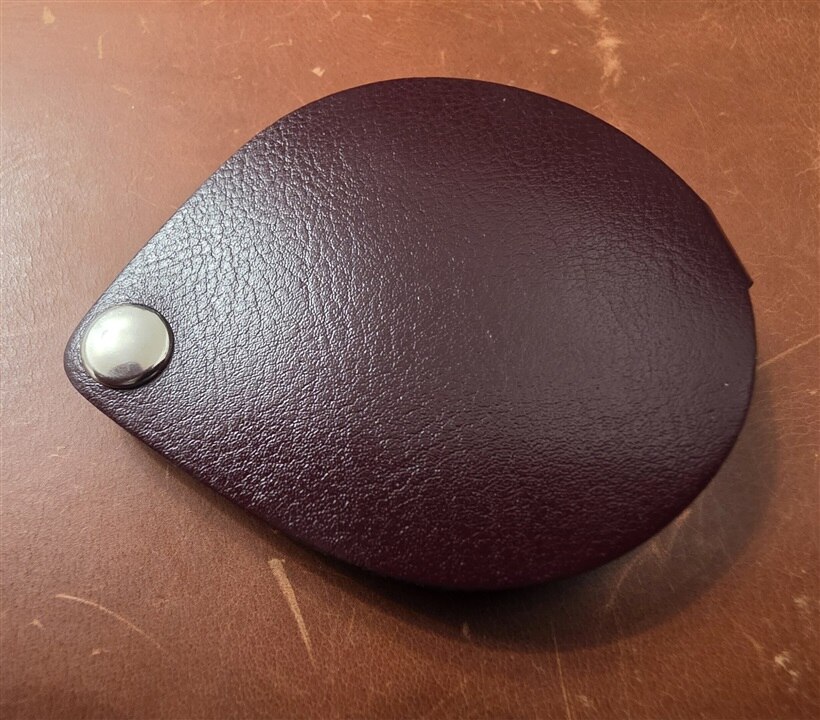

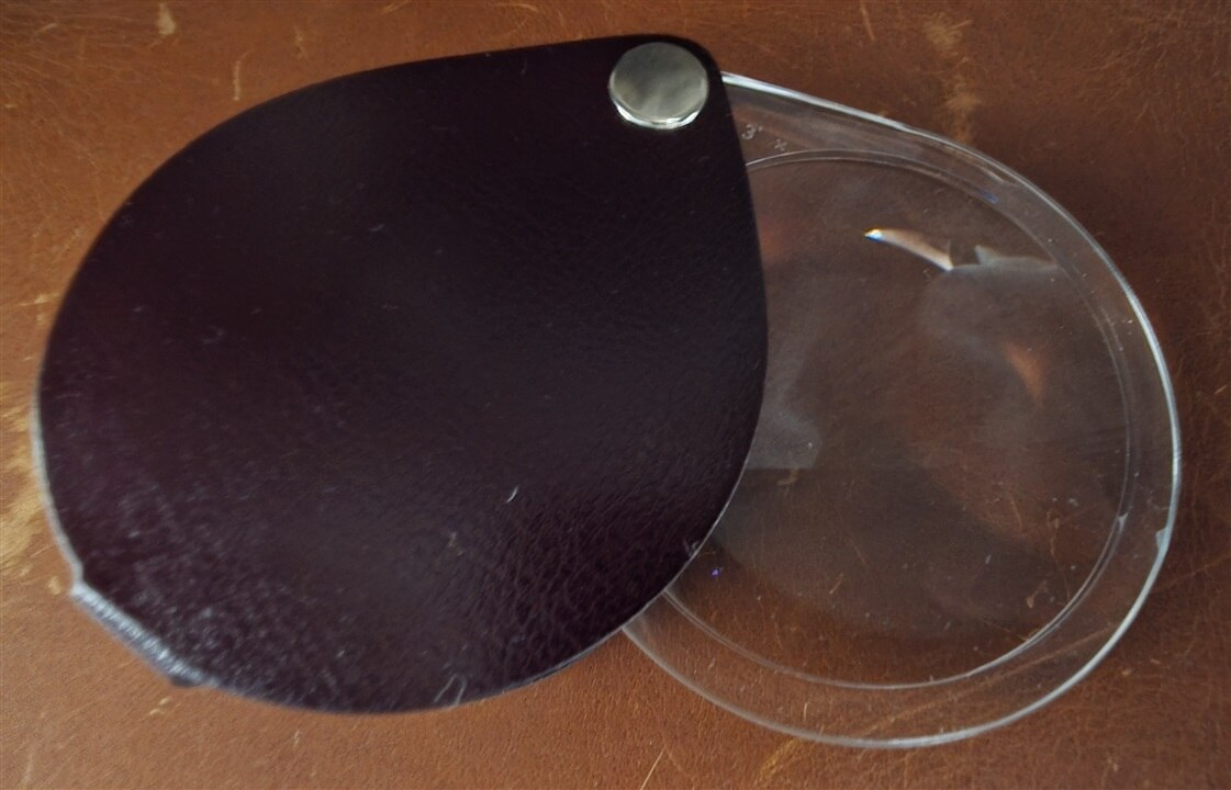

    shabaz 11 months ago in reply to shabaz

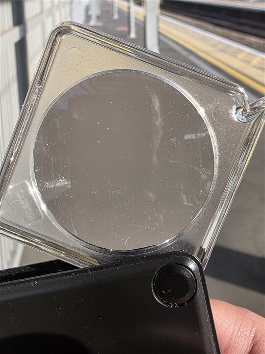

    Here are some photos of the mentioned Eschenbach model.
    Round plastic lens in a teardrop kind of shape basically.
    It certainly looks cosmetically a lot nicer than the Carson ones. I believe it is a real leather cover. Overall plastic diameter is about 68mm which is quite large, and the  lens portion of it is about 56mm diameter.
     The distortion is less than expected. I didn't have high hopes, but it's not bad. Fine for reading small print on labels in stores, and menu items in restaurants. Lots of reflections though.
    For me I think this will replace the pocket Carson magnifier for general (non-engineering) use, because I like the larger size, and the leather feels/looks a lot nicer (which it should for the price!).

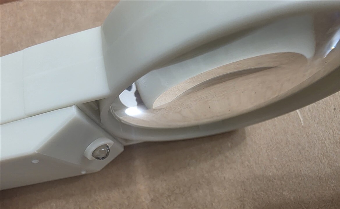

    Having said that, I recently ordered this thing:
    Not particularly cheap, but has a large lens so I was keen on that, but I'm not holding out much hope for it to be much good for electronics, since it's not aspheric. And no LED either : ( I'm not a fan of these traditional old brand manufacturers, I think they are doing a real disservice to people by not innovating and offering decent magnifiers at more reasonable prices like Carson does.

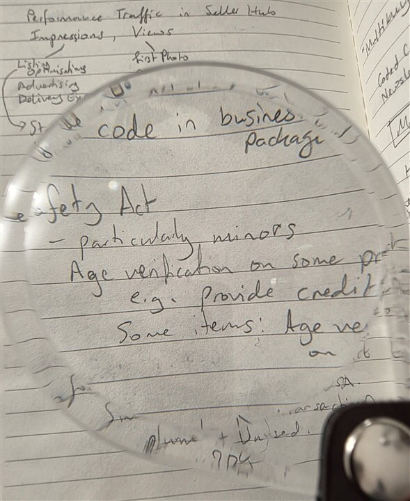

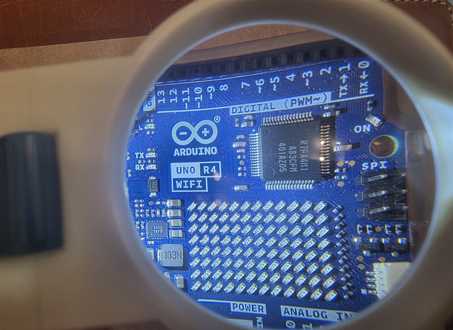

    It's been a long time, but added another magnifier to the blog!

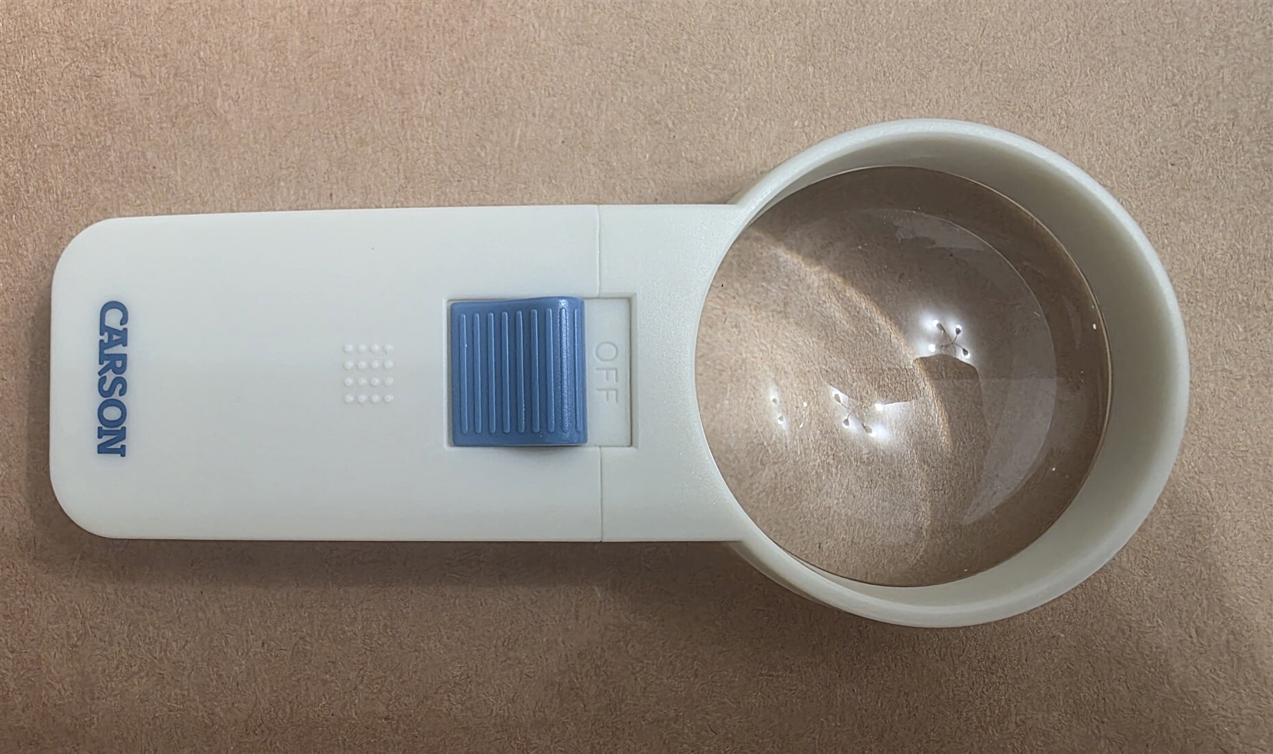

    The OptiVISOR has solved most problems for me - I can comfortably solder tiny parts with it. However, I was still on the lookout for a small handheld magnifier for reading part numbers and general inspection, when the OptiVISOR is not convenient, and a microscope or other large optical instrument isn't handy.
    I recently tried a Carson 11X MagniFlash  and it was definitely not suitable for board inspection, because it needs to be held very close to the surface of the PCB, and connectors and other things would get in the way.
    So, I returned it, and tried the 7X MagniFlash today (there is also a 9X version but it was out of stock). The 7X is much better; I can position it about an inch away from the board. Also, the depth of field is really good! I can read part markings on DIP package ICs in sockets, while at the same time reading the board silkscreen. Very surprised at that.
    However, everything is not rosy, because although it is advertised as a magnifier, I can't get the stated performance (the manufacturer claims a flat image due to the lens asphericness) without using it as a loupe (i.e. positioning the eye close to the magnifier). It's very strange. If I use it as a magnifier with the eye 30 cm away or more, then I get a clear image, but not edge-to-edge by any stretch. I see a clear image in only the central 33% of the lens. The rest is distorted. However, if I use it as a loupe, then I get a clear edge-to-edge image as shown below. This was taken with my mobile phone, and I cannot keep everything aligned easily. The image looks better than this in real life, but the camera at least captures some of the edge-to-edge flatness and clarity to some degree. In real life, I can easily inspect each solder fillet on the 0.5 mm pitch QFN parts on the board.
    Even using it at a distance, the 33% of flatness might be acceptable for some uses, because the lens is quite large anyway (1.5 inch diameter) compared to typical loupes.
    There is a built-in LED which is important for me, because some loupes block out a lot of light. There's a second LED at the rear of the magnifier, for using as a torch! It produces a very focussed spot though - about 25 cm diameter if standing 2 metres away. I don't know how useful that is.
    Because the magnifier can be held an inch away from the item being inspected, and the eye doesn't need to be that close (1.2 to 2 inches seems optimum if using it as a loupe) it doesn't block out as much light as typical loupes either, so using it without the LED switched on seems fine in normal indoor lighting too, which is great.
    I do see the reflection of lights in the room in the lens, which is irritating, but it's not as extreme as some other magnifiers. Those reflections are less of an issue when your head is close to the magnifier.
    The MagniFlash comes with a cloth draw-string bag.
    In summary, it's not perfect, but has a fair amount going for it, at an OK-ish price (I think it's a bit overpriced, but everything is expensive nowadays - £32 in the UK). I'd rate it 7/10 : )
